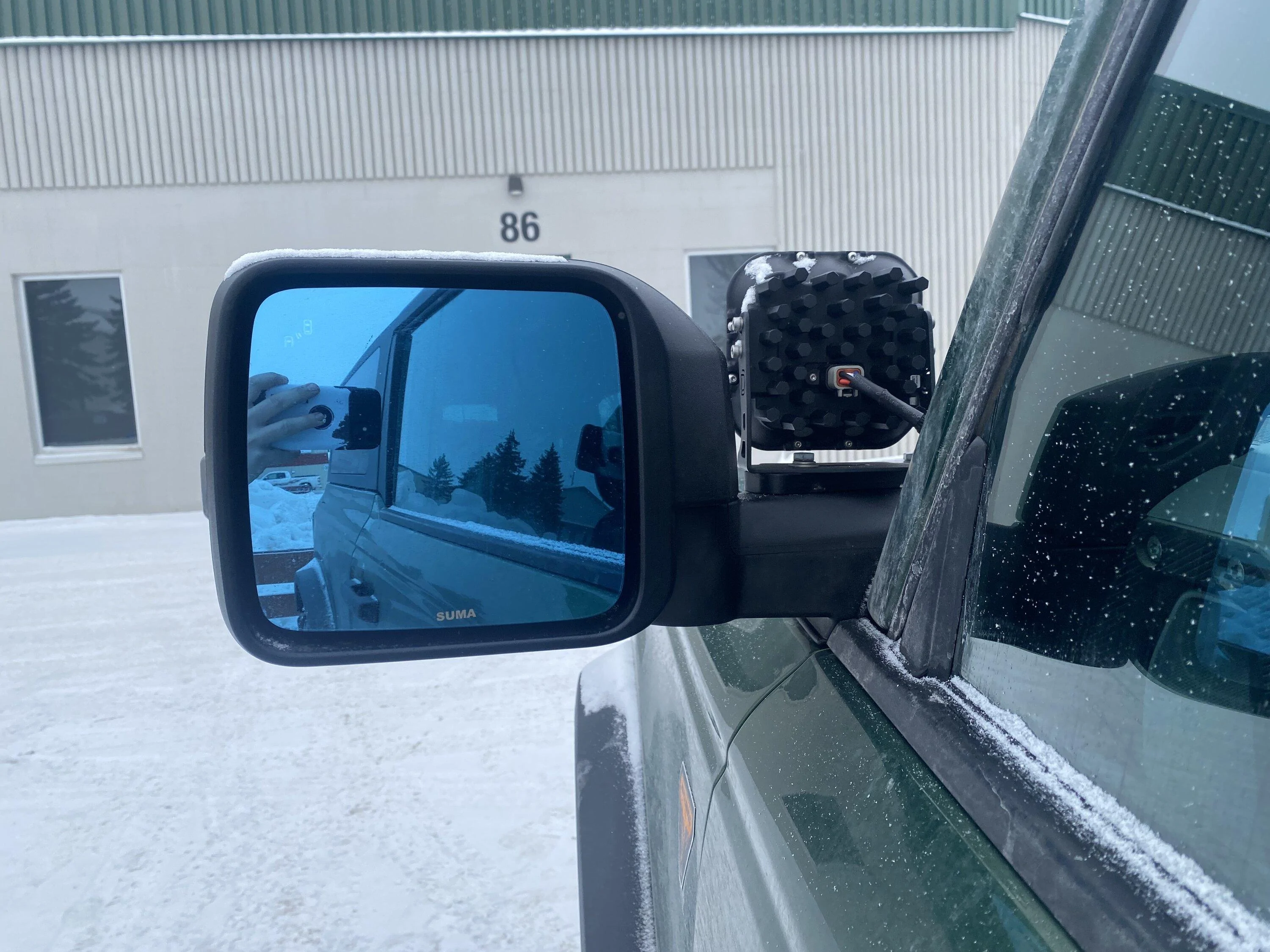

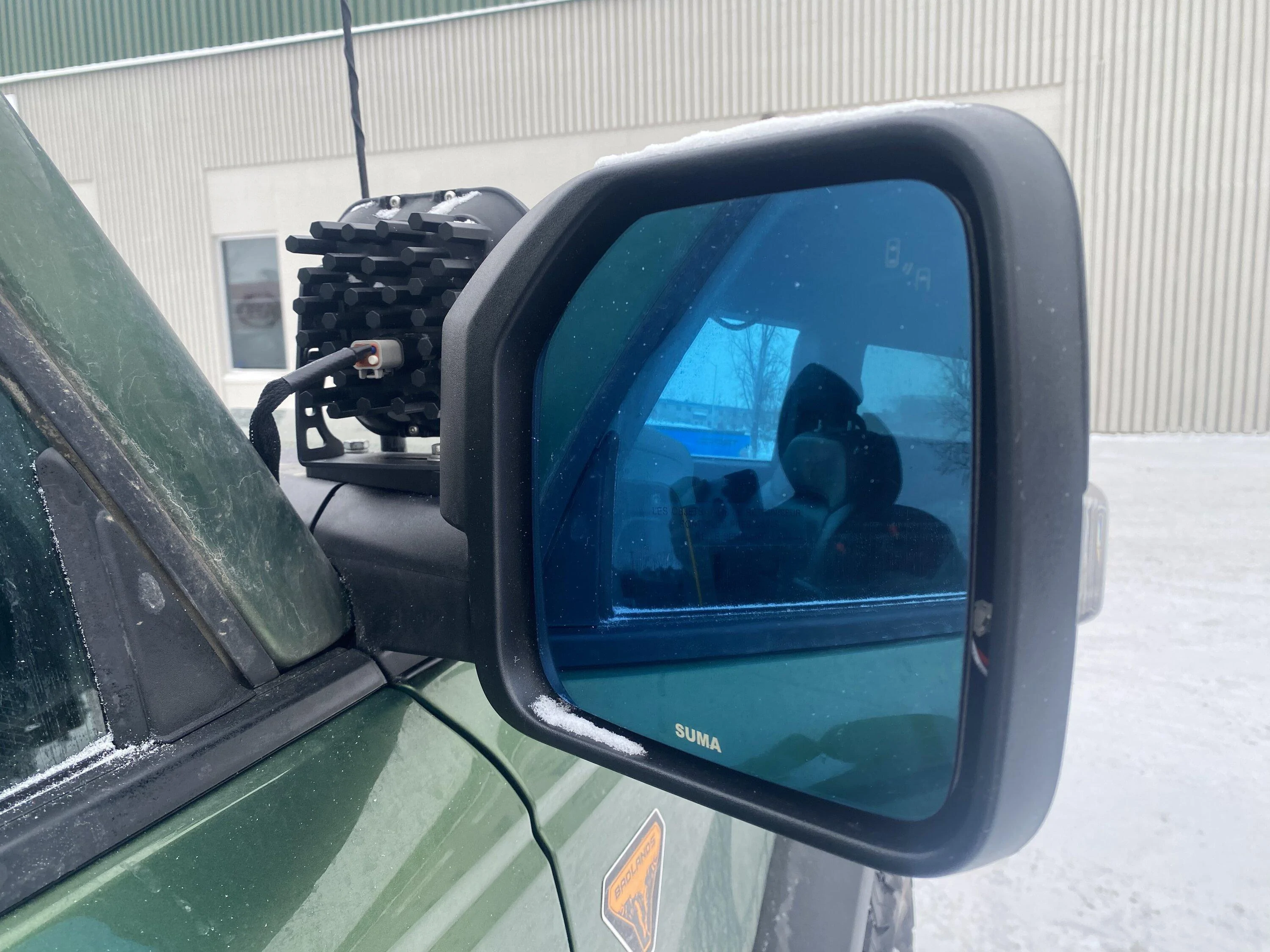

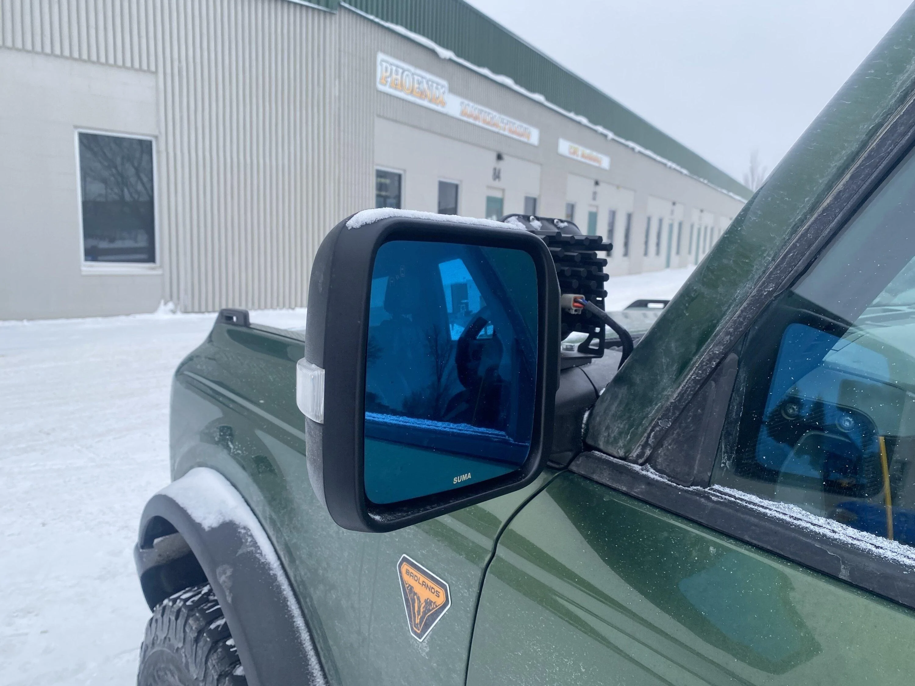

My ‘14 Subaru FXT had dimming mirrors. Loved them!
Unfortunately the Auto dimmers aren't a bronco thing… but your aren’t completely SOL.
Check out @Suma Performance Mirrors!
After having Base/Non-BLIS mirrors with the convex blind spot corner mirror, I found myself missing the FOV it offered compared to the BLIS mirrors.
I swapped to the Suma BLIS+Defrost+Antiglare. They have a slightly more aggressive R value (Convexness/Radius) compared to the flat OEM Mirrors! Would buy these again. The blue takes a week to get used to, but we’ll worth it for night drives… all drives!
As far as install goes, you need a third hand to release the BLIS LED harness connector on the back of the mirror itself… re route the defrost plugs, bend/crimp the female blade connector to make it a snug fit on the Suma male blades and you are good to go. Maybe 5 minutes if you know what you are doing, 15 tops for a first timer
