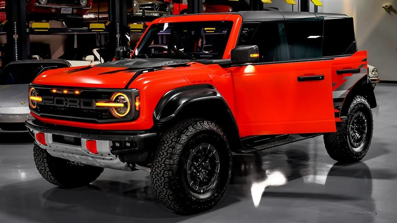

Has anyone upgraded the base model mirrors to the ones with the turn signal built into them? I know the mirrors get power, but I dont know if theres a separate wire or run for the turn signal. Thanks in advance.

There are no broncos with that feature (I am not speaking for the Braptors, those I have no clue on). You could be confusing the zone lighting feature as a turn signal.
To which, we know that the zone lighting is entirely CanBus driven and hasn’t been “solved” yet.
If I were to guess, you might be able to order the mirror caps/assemblies and swap them. There is potential to feed 12v to them on your own circuit - if they indeed take 12v.
https://www.bronco6g.com/forum/threads/puddle-lights-mirror-swap.35100/
https://www.bronco6g.com/forum/threads/side-mirror-part-numbers.68777/#post-1846592
Those might help start your search. Oracle makes some lit mirror caps…

Ah it does appear to be a Braptor thing. Interesting.

I think the decision was that these are just marker lights due to the width of the Braptor and do not flash with the turn signals, but I could be mistaken.
There was a thread on here where someone did get it working though as a turn signal.
