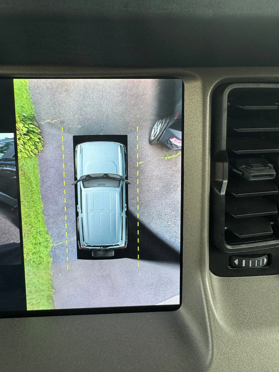

I’m in a similar situation but instead of me hitting a branch, my 18 year old hit an open car door! I’m ready to pull the trigger on a lower end mirror and transfer everything over…but two questions: for BLIS, will I need a new mirror with the indicator built in? Also, this is my 369 camera view…do I need to replace or just recalibrate (and can I do that myself)? Thank you all!
When I did this, all of my mirror functions worked fine, it was just the arm that was broken. That arm and the mirror frame were the only pieces I used from the cheaper replacement. The glass, all of the internal sensors and wiring, and the cover, all came from my original broken mirror. So if your original BLIS is still working, then you would be using it in the replacement. The arm and mirror frame are the same across all trims. The cover isn't, but luckily mine wasn't broken.
Your 360 view is obviously out of alignment, but that could simply be from getting broken. If it was me, I would do the mirror replacement first and see if the camera just takes care of itself. I'm pretty sure it only mounts in one possible orientation.
