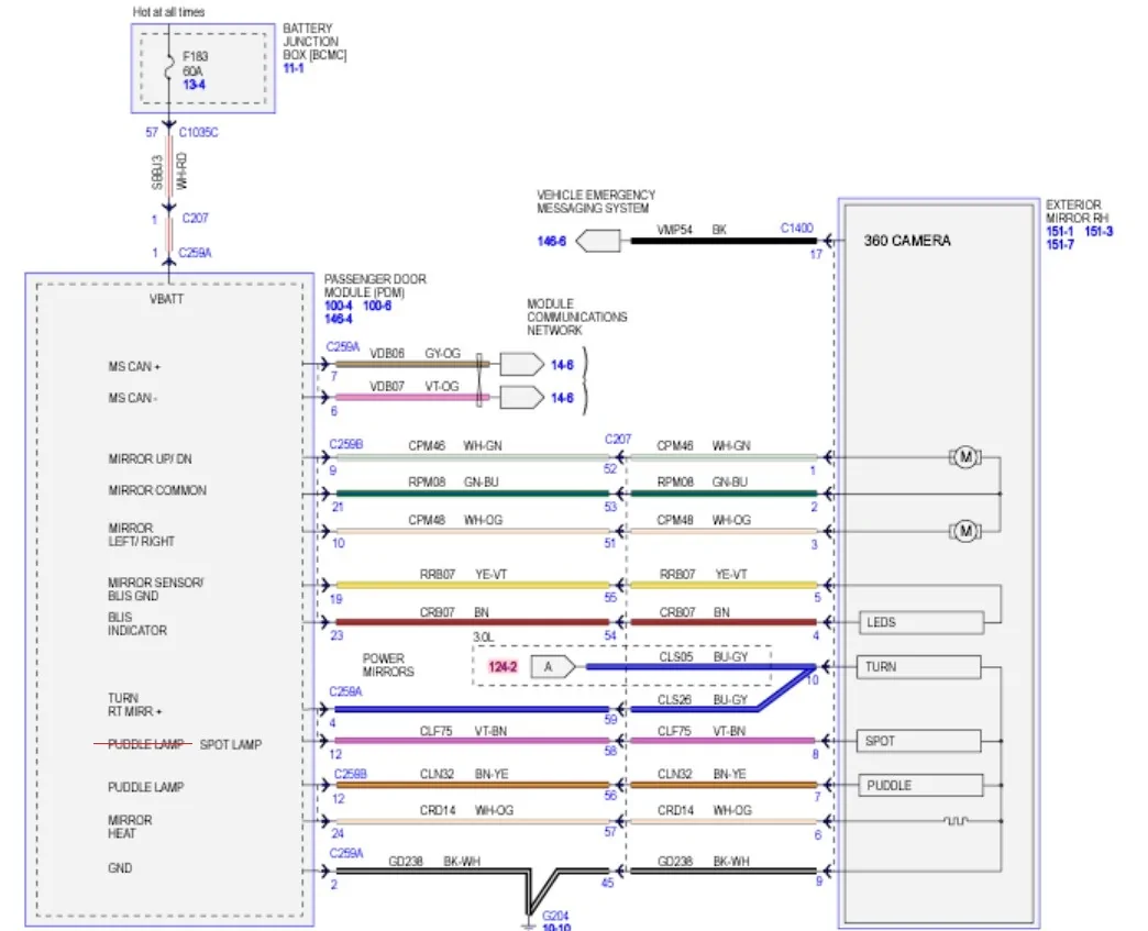

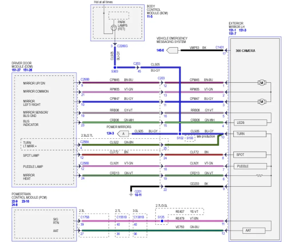

Yup. Those first two files show that the headlamps are not connected to the headlamp switch directly, and the third file show the headlamp switch only has 5 pin connections - to Ground, Power, the BCM and the Passenger Door Module.
The driver and passenger mirror schematics below show the mirror spot lamps are powered by their respective door modules. So I don't follow the OP's idea "to wire the buttons to the headlight hot under the dash".
Either the software has to be modified, or new power wires need to be added directly to the lamps that bypass the door modules. I plan to do the latter using an aux switch and a couple diodes.
Ford Bronco Mirror side lights C1401
Ford Bronco Mirror side lights C1400
That might work, the diodes are a very good idea to protect the door modules. They might not like back fed power. 1N4001 diode will handle one amp. That's probably enough.
