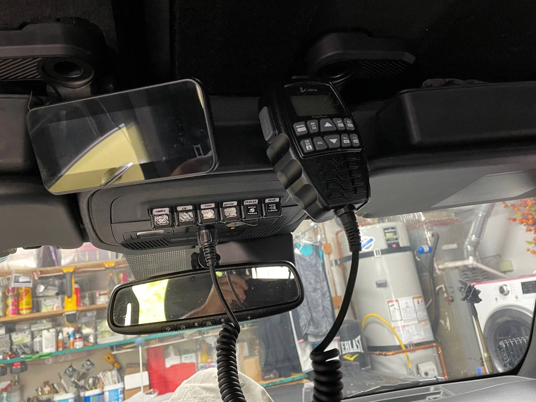

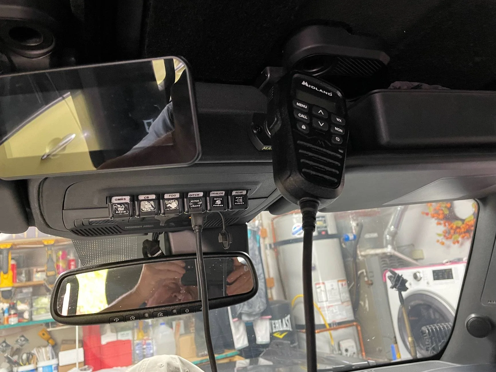

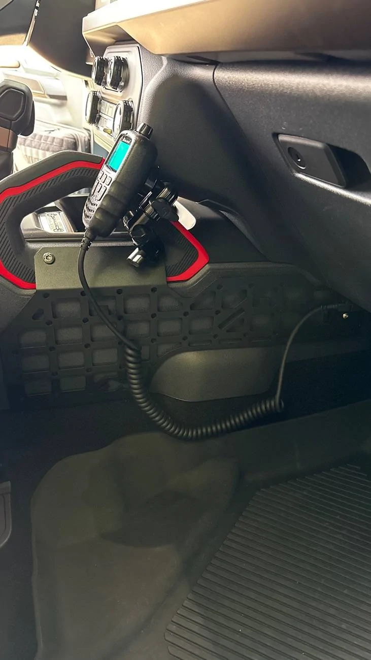

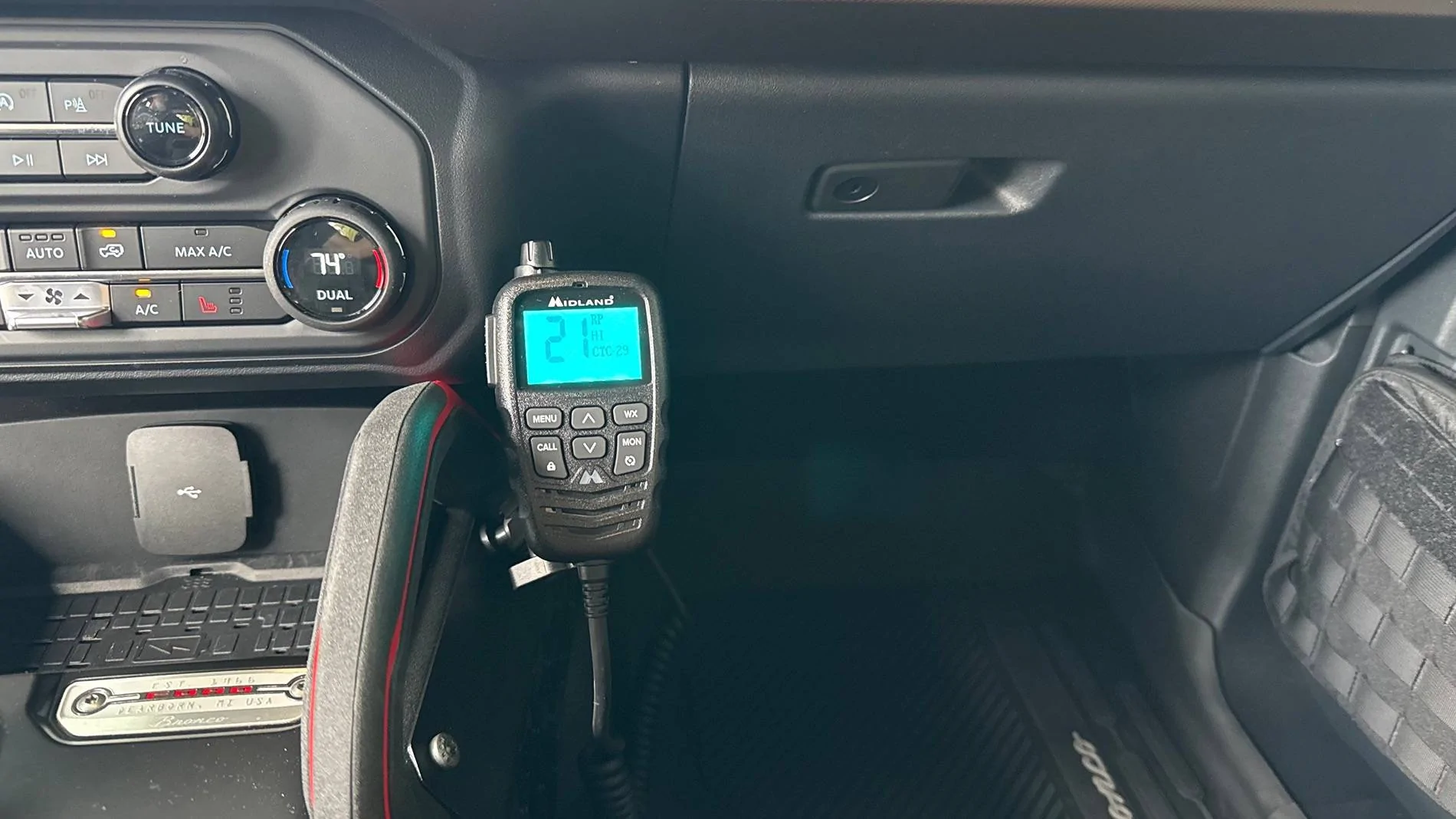

I have GMRS and CB. All hidden with mic controls. The mic connections are in the upper console and a magnet not clipped.
Ford Bronco Show off your HAM or GMRS setup IMG_2347
Ford Bronco Show off your HAM or GMRS setup IMG_2346

Nice, that looks really good mounted up there. Also great to be out of the way of the radio and hvac and passsenger space.

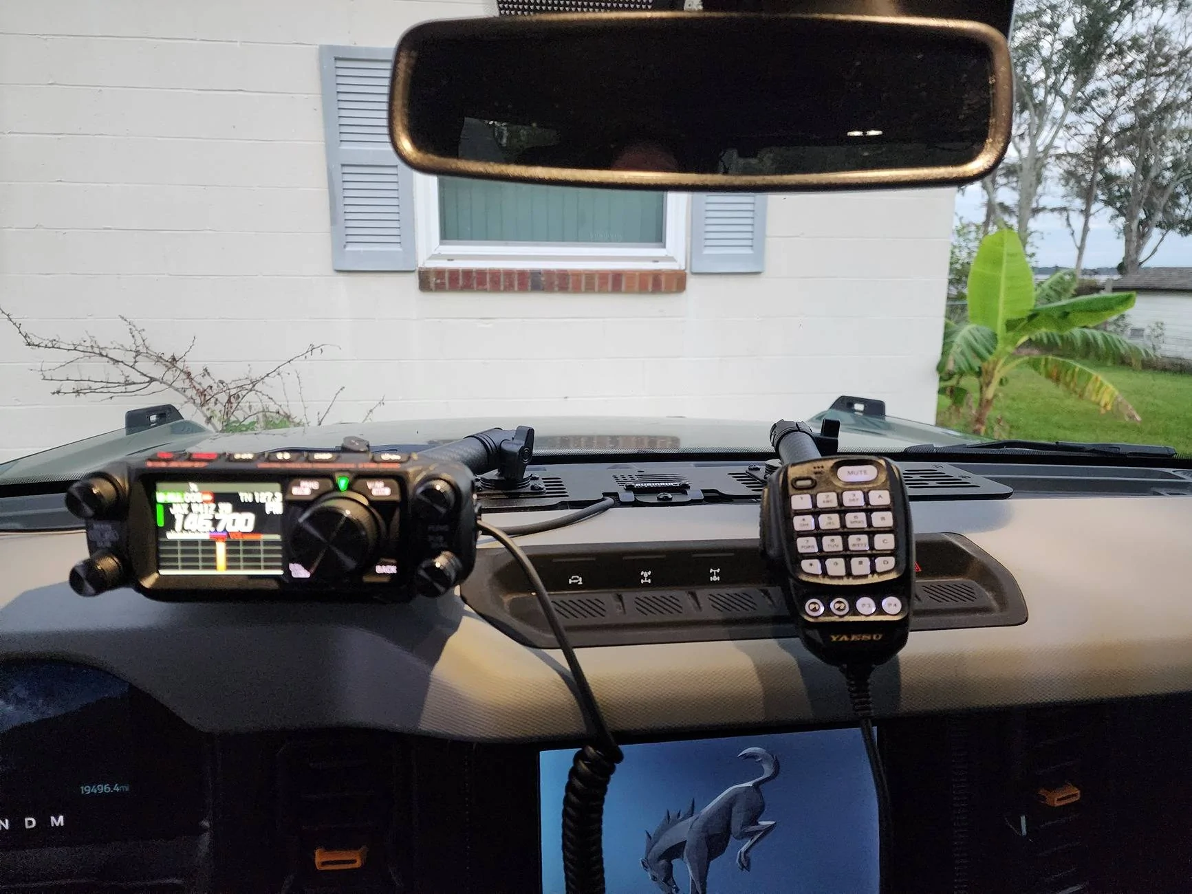

Here is my setup. FTM-500DR and using a Bullet Point mount.
Ford Bronco Show off your HAM or GMRS setup 20241118_173514
Ford Bronco Show off your HAM or GMRS setup 20241118_173630

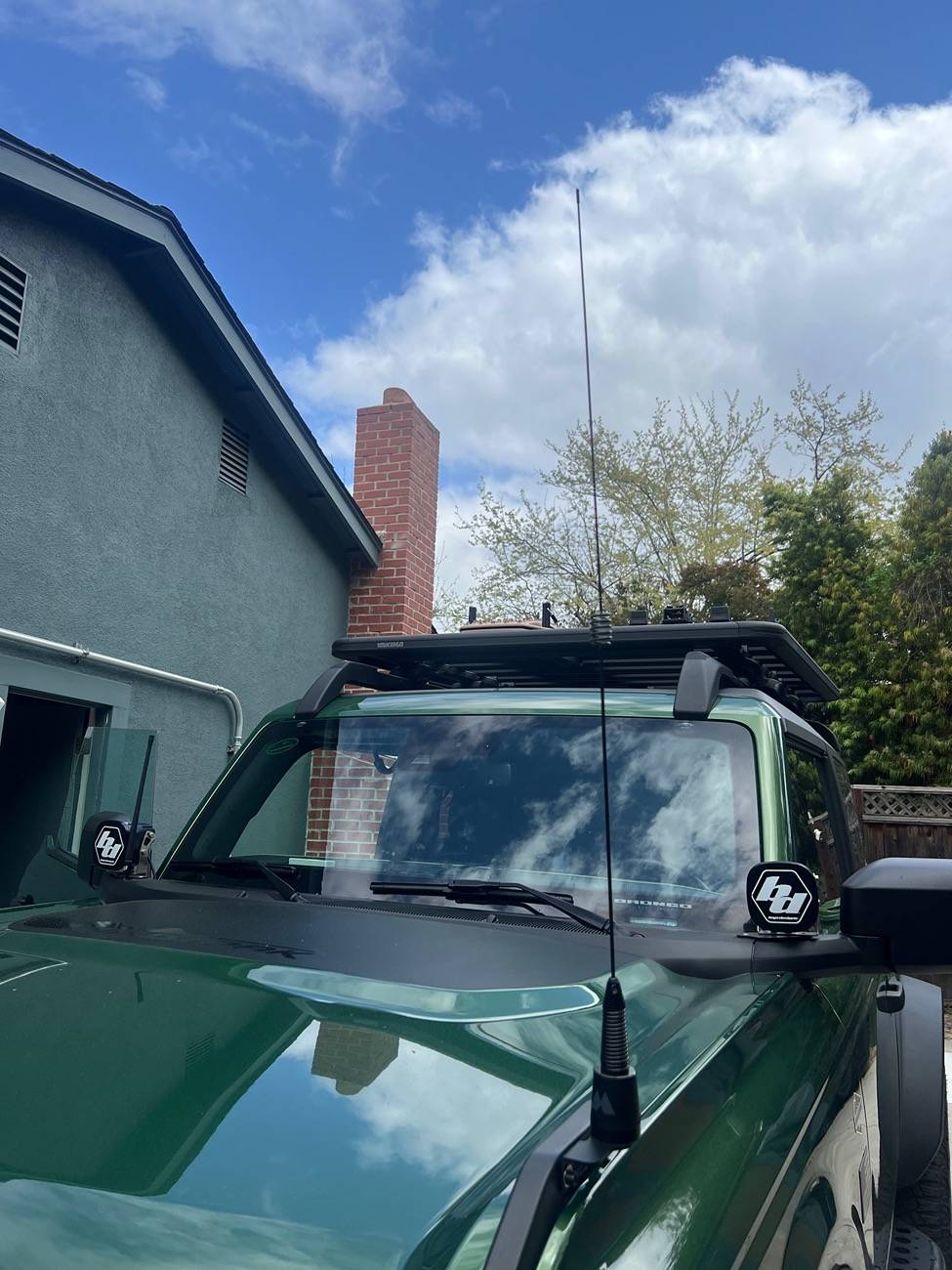

Ford Bronco Show off your HAM or GMRS setup IMG_8157
Ford Bronco Show off your HAM or GMRS setup IMG_8158
Midland MXTA26 6DB antenna
Midland – MXTA26 MicroMobile® 6DB... https://www.amazon.com/dp/B084BPXNC5?ref=ppx_pop_mob_ap_share
Rugged G1 waterproof radio with Bronco install kit (comes with A pillar mount and 14” 4.5dBi antenna)
https://www.ruggedradios.com/products/rugged-g1-waterproof-gmrs-mobile-radio
TrailRax Trail Site Accessory Mount
https://trailrax.com/products/ford-bronco-trail-sight-accessory-mount
RT Systems Programming Software and Programming USB cable
https://www.rtsystemsinc.com/G1_c_2440.html

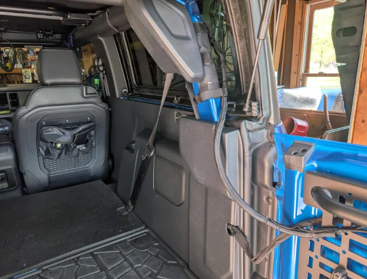

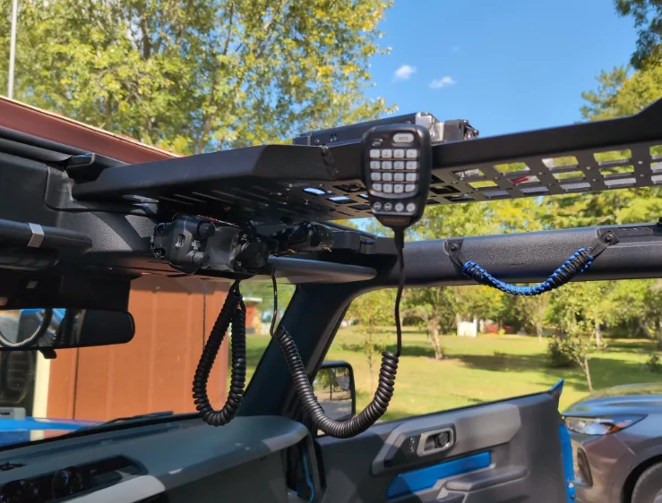

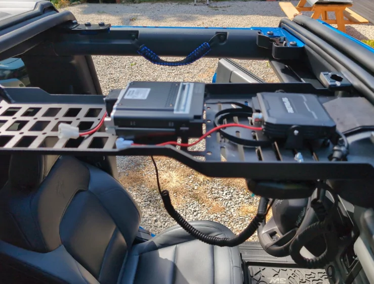

Here is my DV8 overhead molle installion, all radioed up. Not shown is the fused PowerPole block and USB hub. Radios themselves are mounted above the panel, and the FTM-500 head is mounted below it, using a simple metal bracket available from DX Engineering. The GRMS radio is a Retevis, and the UI is built into the mic itself. Because I have the manual transmission, and the rubber grommet in the firewall (used by the automatics) does not exist, I routed the 12VDC line through a small opening found between the front right fender and passenger door jamb. I encased the coax from the antennas and routed it over the rollbar, affixing it with hook & loop fasteners (which I believe will release if the airbag is deployed, but the back seat is deleted anyway). This way there is no popping panels or drilling or interference with the rear access - and they deposit neatly into the molle overhead panel.
Ford Bronco Show off your HAM or GMRS setup 1758381841310-ou
Ford Bronco Show off your HAM or GMRS setup 1758381883692-ml
Ford Bronco Show off your HAM or GMRS setup 1758382741080-yk
Ford Bronco Show off your HAM or GMRS setup 1758382818360-8z
