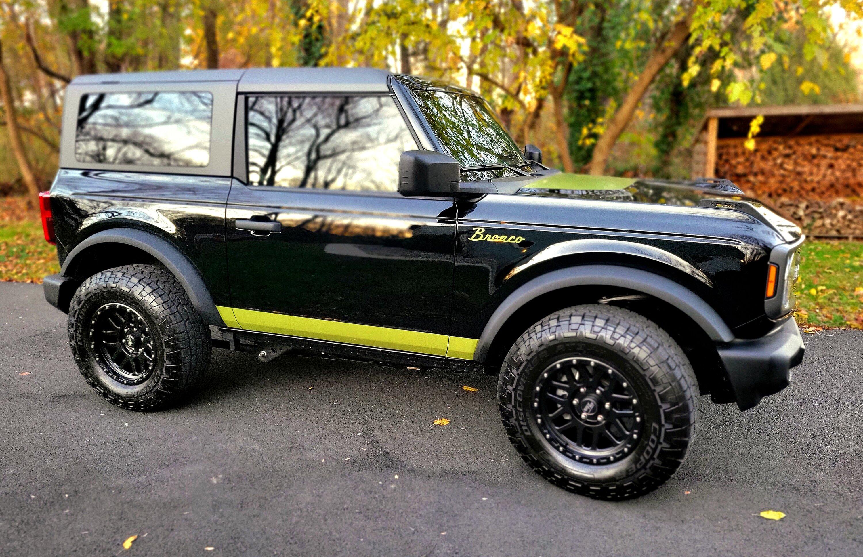

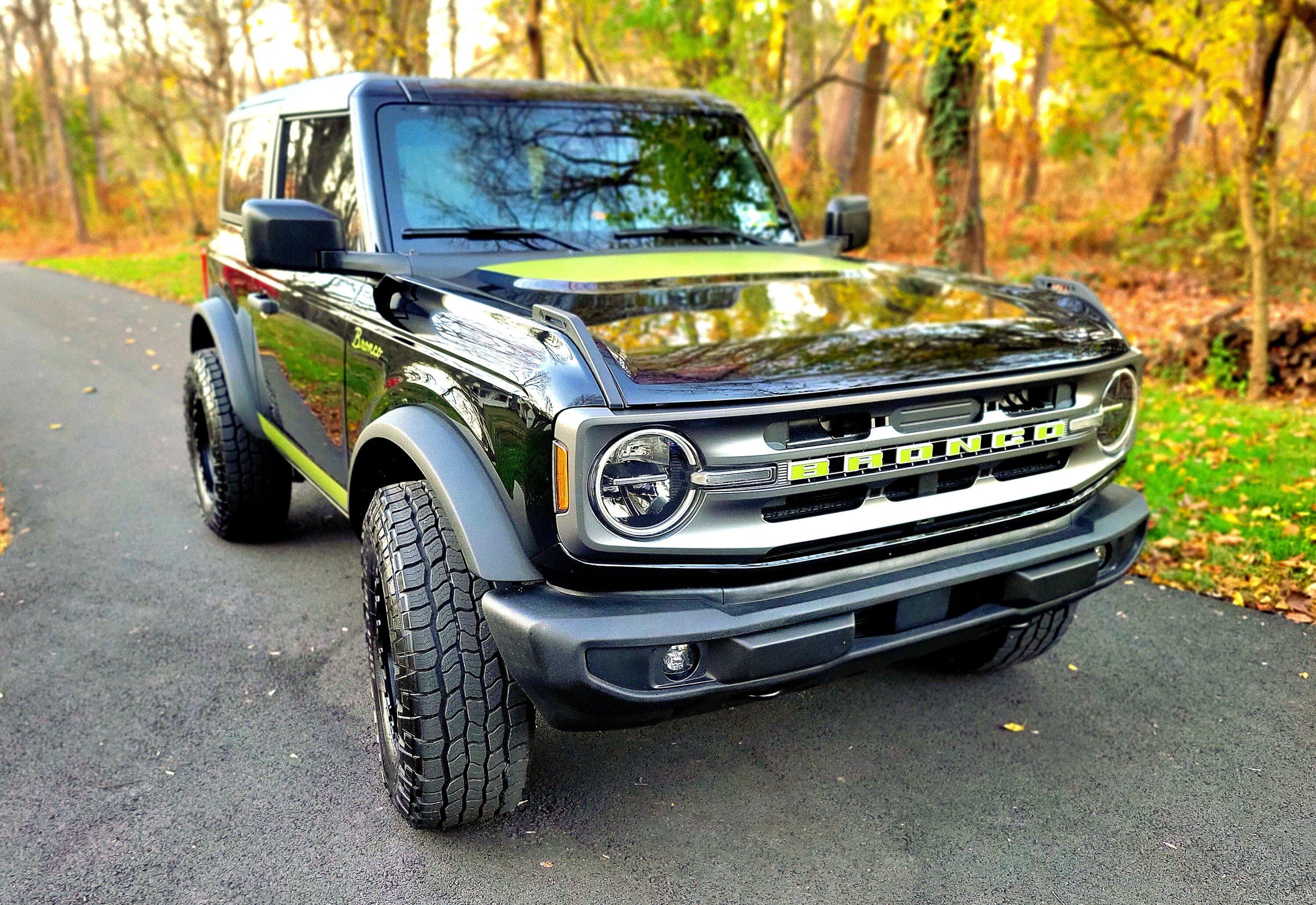

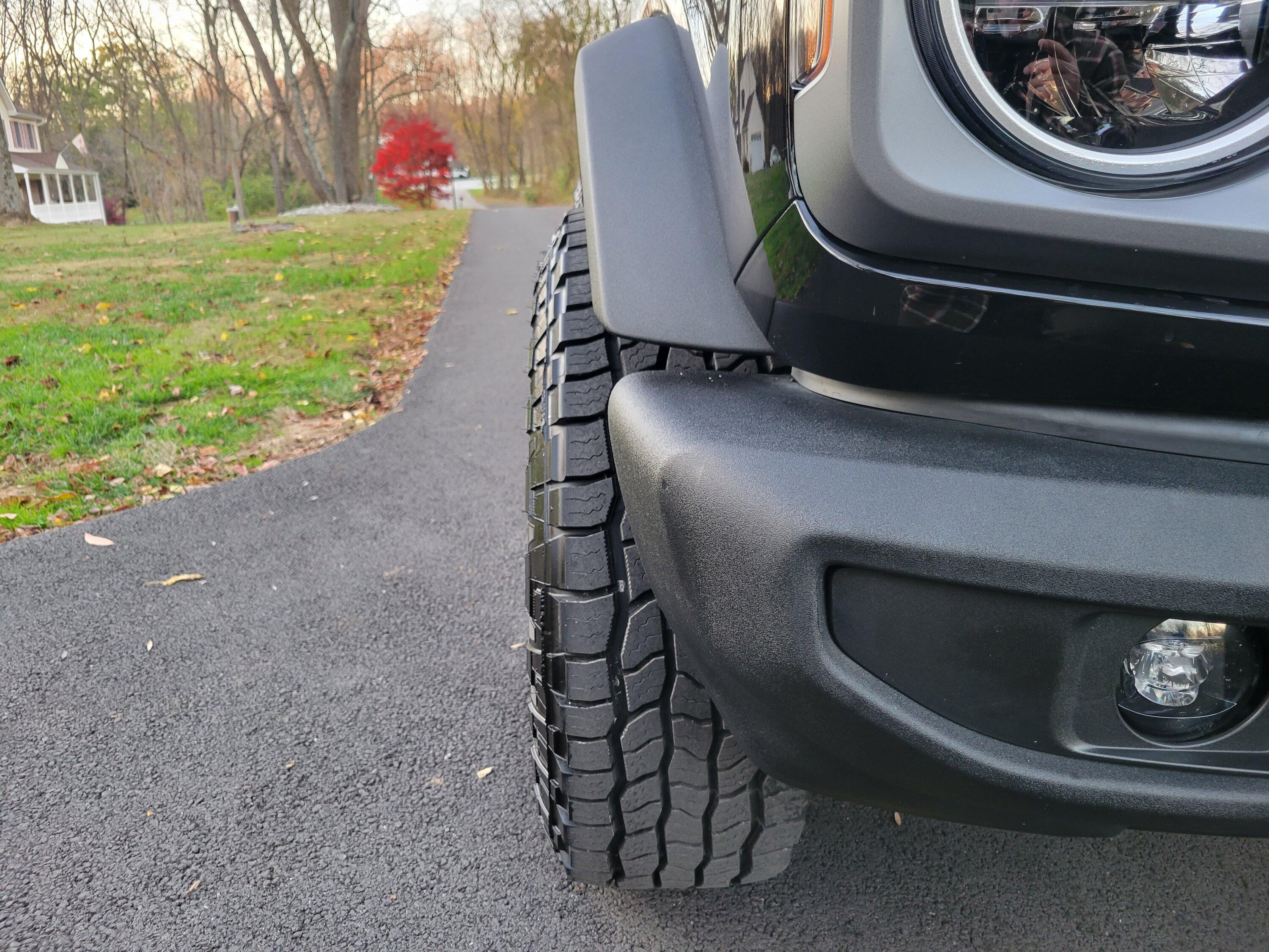

Rocktrix 17x9 (+12 offset) on Cooper Discoverer XLT 285/70s. No lift, front crash bars removed. So far, Im happy with them.
That looks awesome!! I am a complete Noob, when I look at those wheels they pull up with the option of 93.1 or 106.1 bore for Bronco's, do you know which one you got? I just received my 4 door base yesterday and am super excited! Also, do you think I could get away with 285/75R17's if I remove the crash bars? Thanks for any and all help!
The Bronco hub bore is 93.1, so those would be a direct fit. The larger bore will work fine, but some people prefer to run spacers with them.

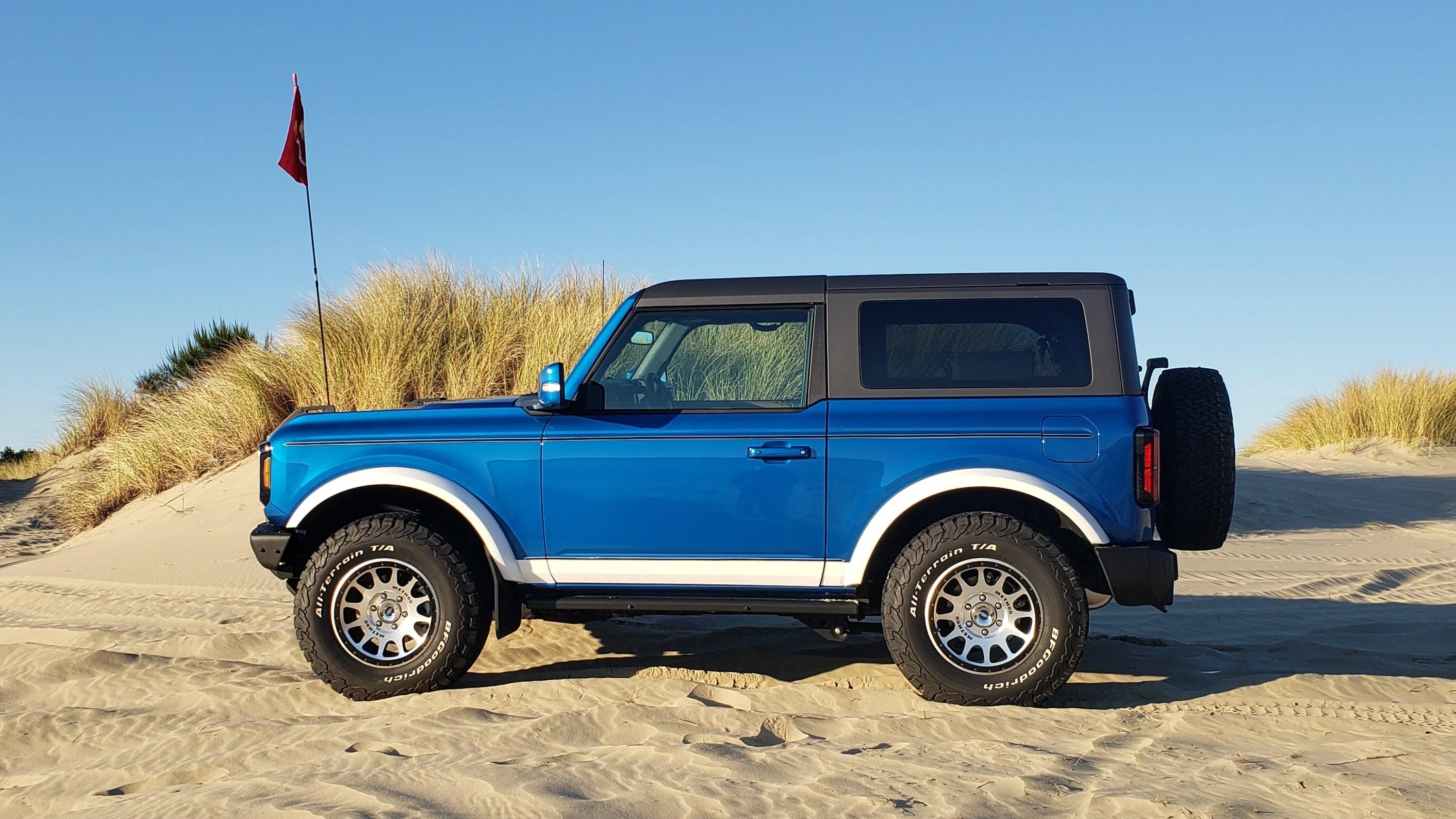

33's gave me exactly the look and performance I wanted.
There is something about your truck that just works. I don't normally like blue vehicles, but I love yours. The aluminum wheels, white wall letters and white flares/door stripe, and somehow even the black roof looks good (Did you paint that or is it stock?)
I would love to see your top painted or wrapped white... but as is it looks fantastic. And of course the 33s look great.

Thanks Rusty for the kind words. The "Bronk" draws a ton of attention. The roof is stock and will remain so till summer when I go soft top. It has been mistaken several times for a restored EB.......I LOVE that.
Thank you.
Honestly, I never got an option for a different bore size. I took a chance on ordering them from amazon.
With regards to 285/75s, you shouldn't have a problem. I cleared but didnt like how close the front bars were, so I took them off. You should be fine if you pull both.

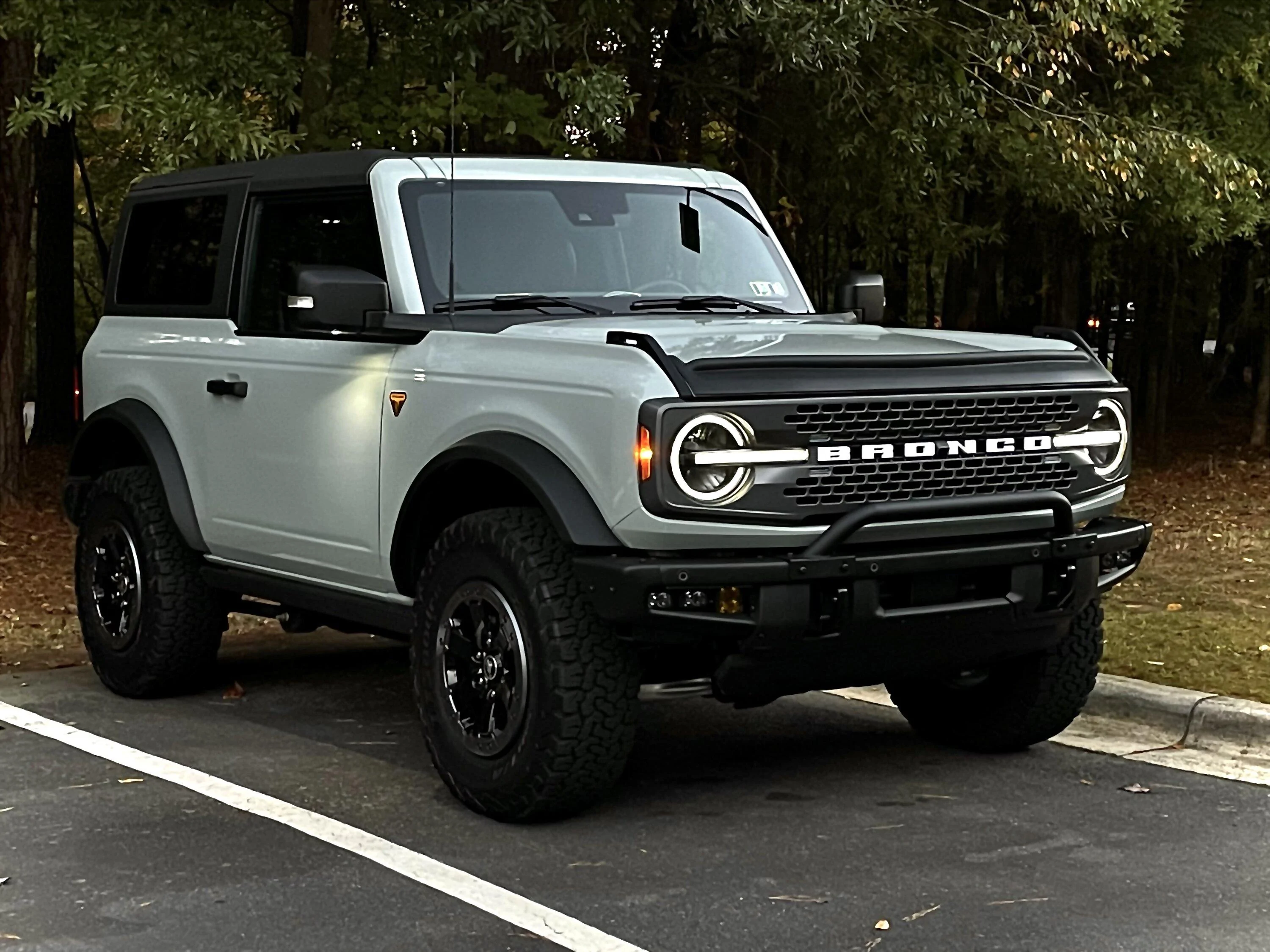

Factory Badlands. Capable stance
Does the Badlands have a taller suspension? I have a 4 door base ( i know different trim and doors) and it doesn't look like it has that much room between fender flares and tires and i have 33 inch ko2's.

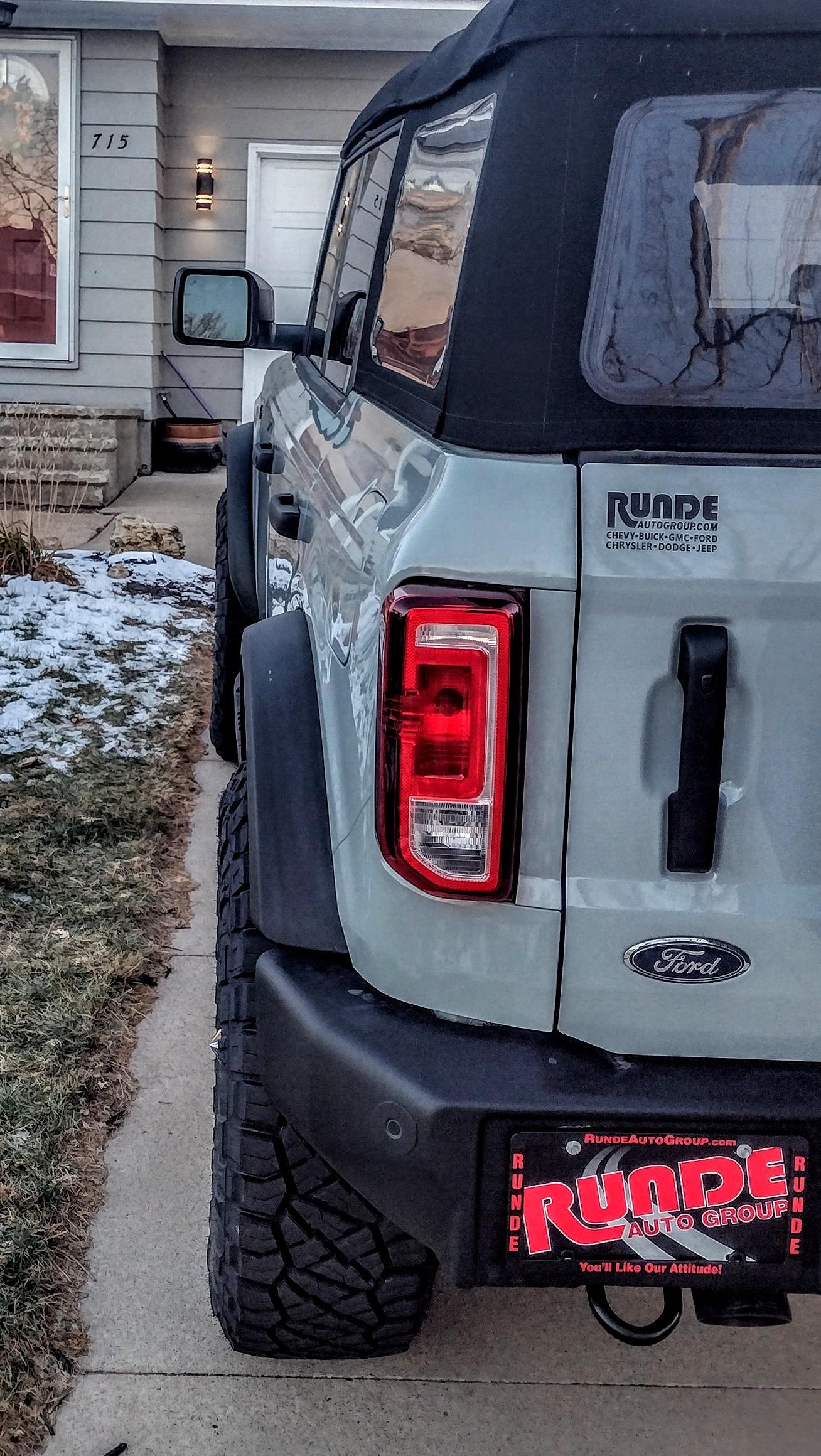

Switched to 295/70/17. No lift, crash bars still on. Its an 11.6 in width vs the 285/70 11.2 width. I did go qith 17x8 +35 offset wheels.
Yes, it is nominally 0.6" lift over the base suspension.
33's will fit fine with the right offset rims.
It is a bit taller. Ford markets it as the “Badlands suspension,” although it is basically like .5 inches shorter than the Sasquatch suspension.
Nice tire choice.
