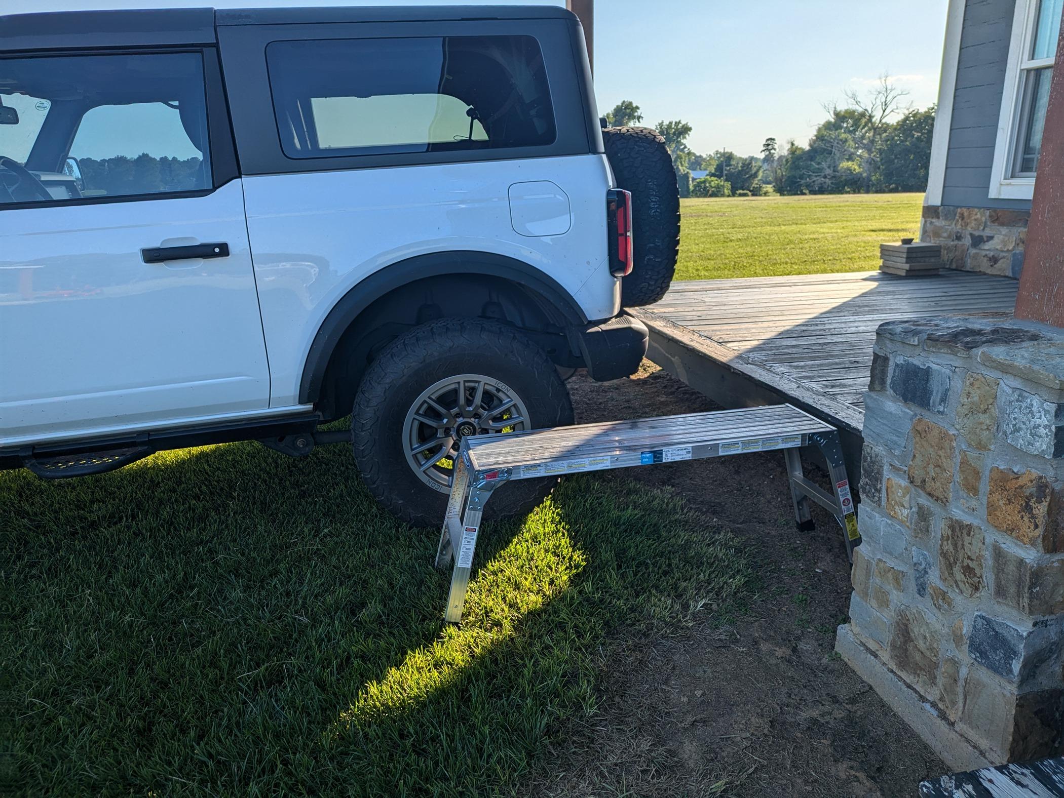

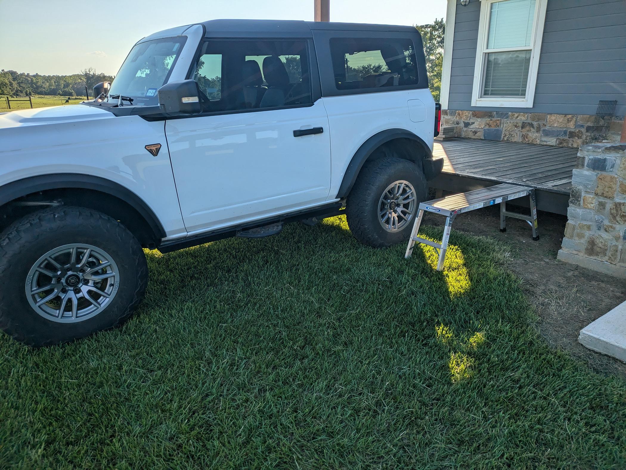

This is how my wife and I remove the hardtop. It just so happens that our back porch is the right height to pull this off. :) She's 5'2" ish. I'm 5"8". We bought 2 Werner painting platforms. My wife uses gloves. We raise her side a little and place a towel under the top so she can get her hands under and grip it. Raise the glass and then close the tailgate. Hold the top closer to the rear and slowly move it to the back. We have 4 pieces of 4x4 wooden blocks to put the top on, being careful not to put the top down on the pins. Start to finish it takes us about 20 minutes. We store the top on the back porch.
