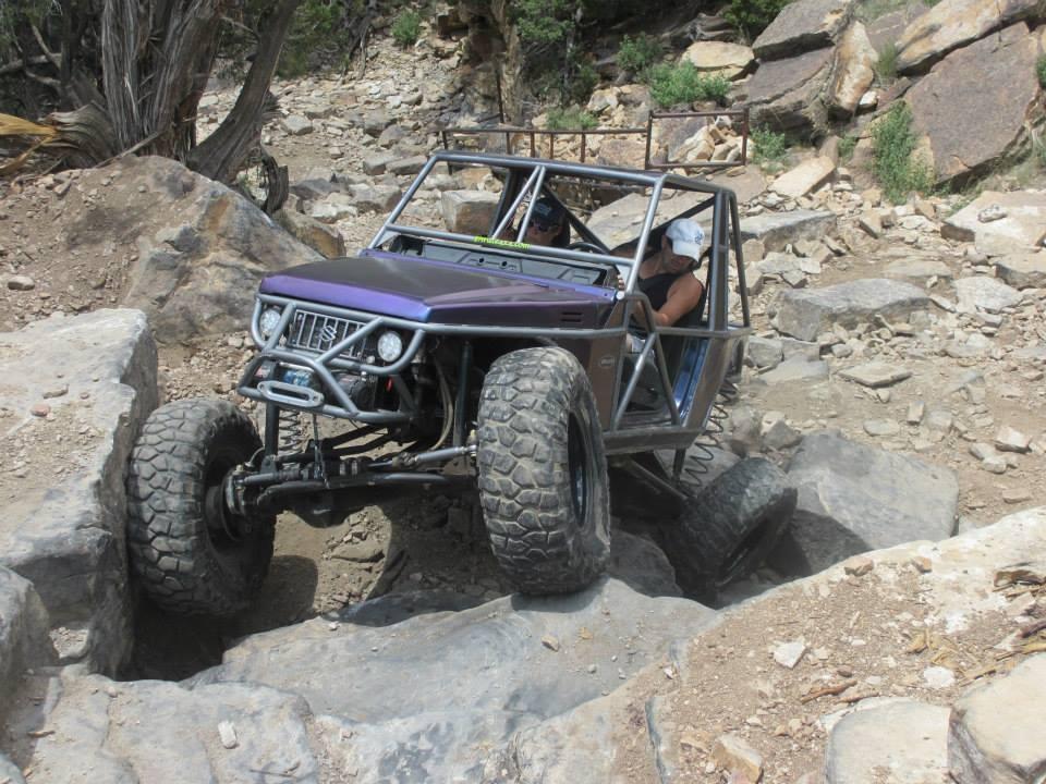

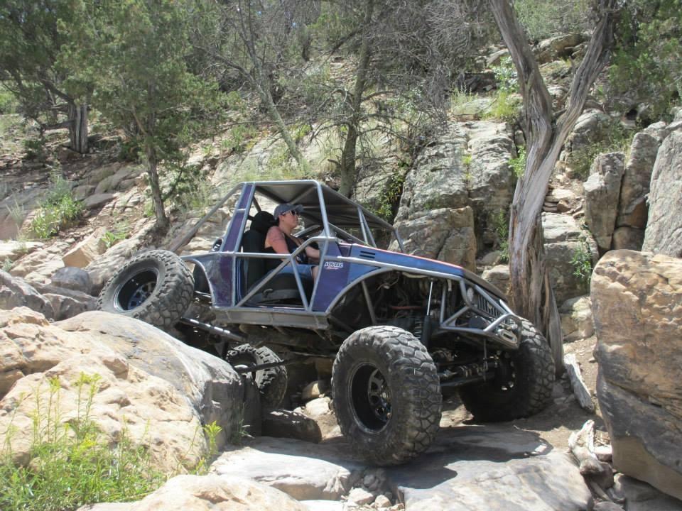

Here it is in it’s prime….1.6 16v, 3spd auto, 6.5 case. Fully built trail gear yotas running 37 reds. I ended up disassembling it to upgrade some things and do a full tube chassis….I’m not super far off from finishing but I got distracted by vacationing and then the new bronco so it’s been on the back burner for awhile now. New version is 2.0 3 spd auto sidekick case to samurai 6.5 case, same yota axles, ori struts and 39 reds…..as far as yours goes I would just give it some thought on what you wanna accomplish and what you would use it for and go straight to that. Once you go past 31s and samurai axles the street ability goes down drastically. Lol

Yeah if your going that drastic it would be easier to go full tube chassis…I don’t know where you live but I kept my buggy tagged and drove it on the street occasionally here in Colorado up till about 4 or 5 years ago…never had a issue…

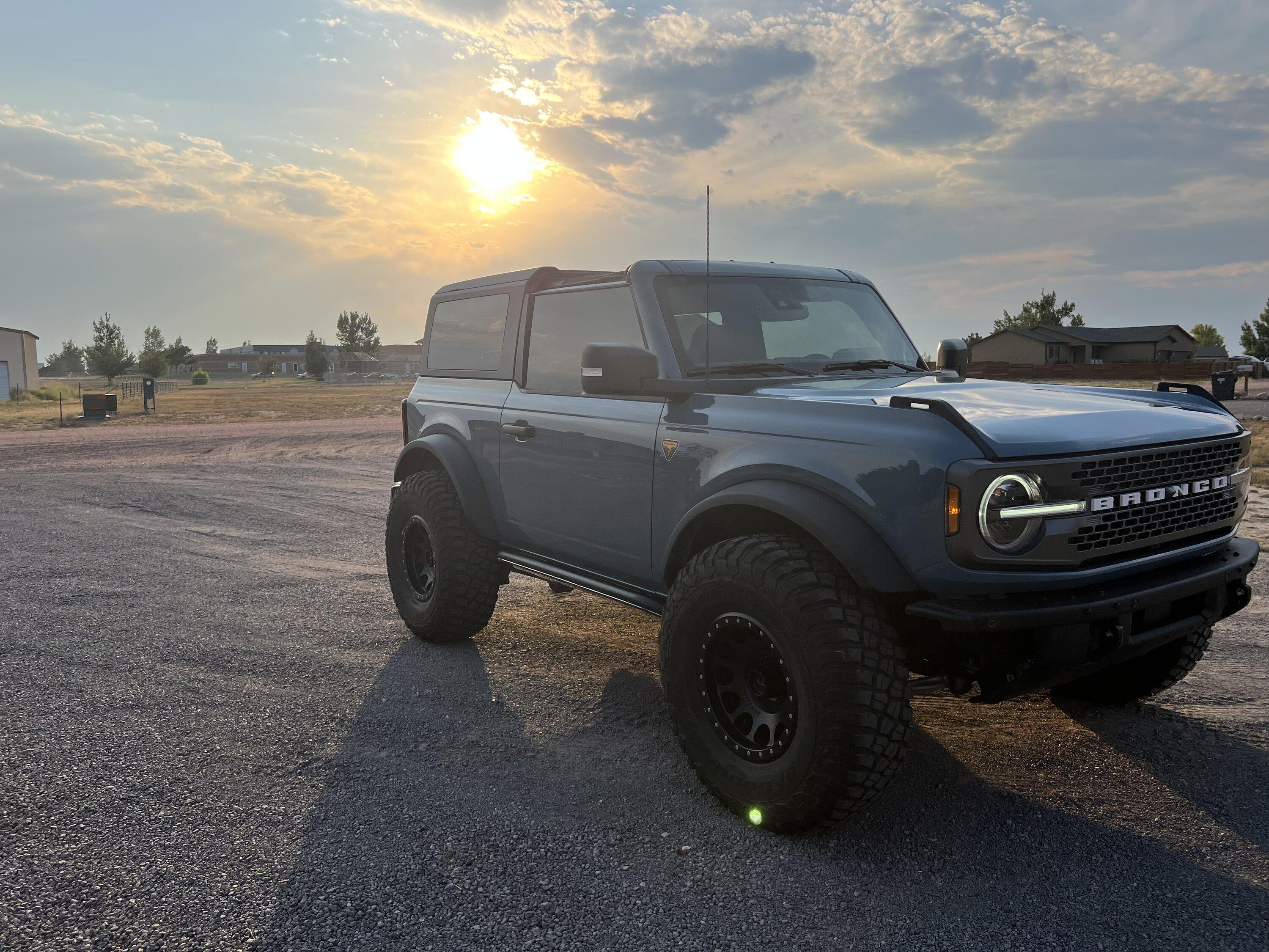

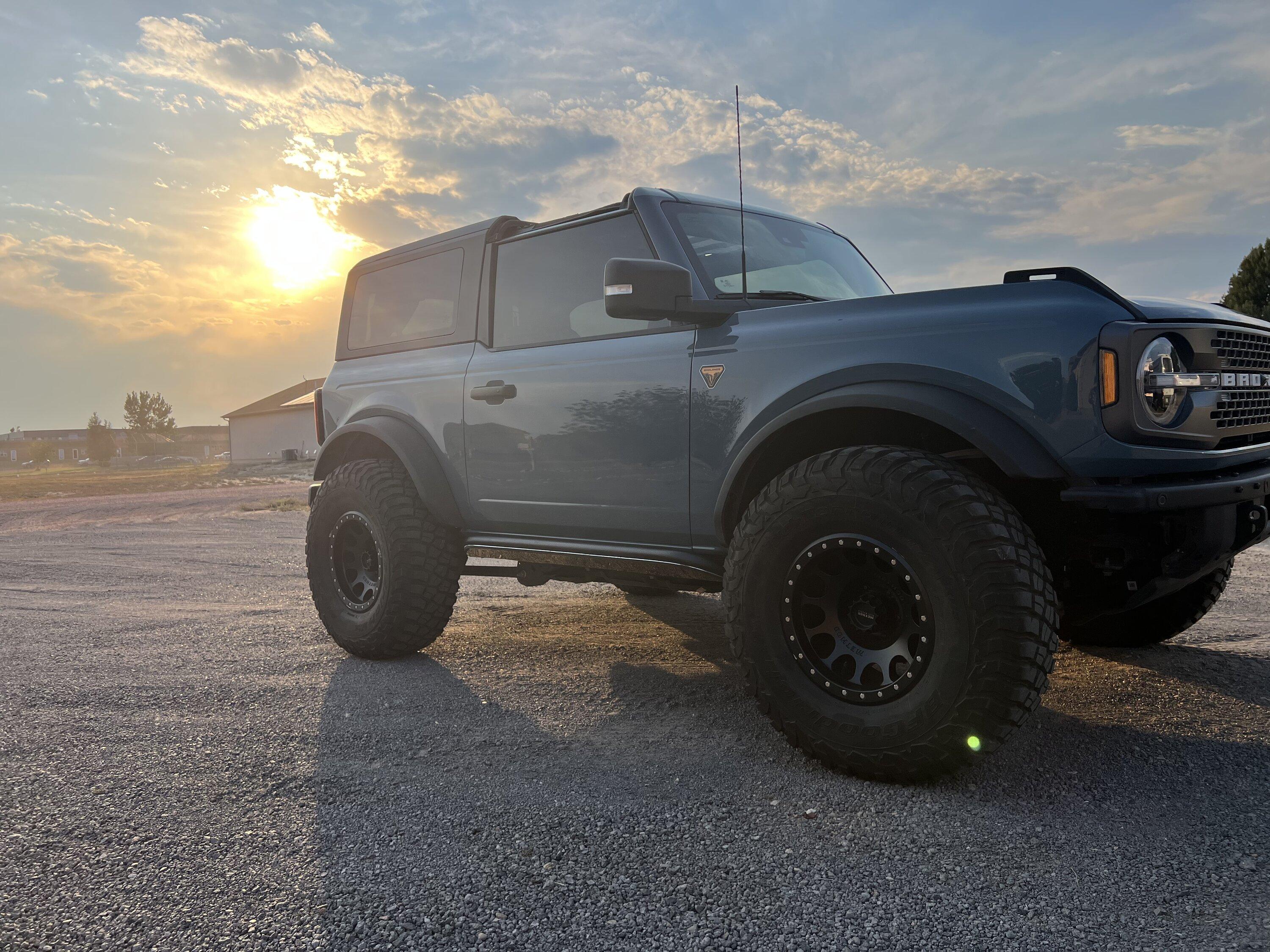

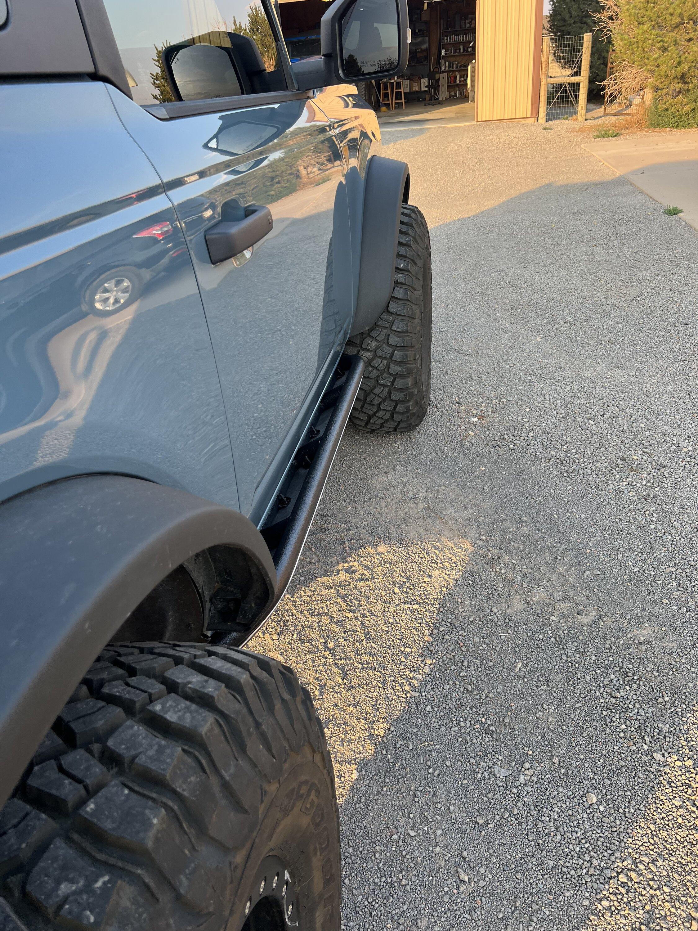

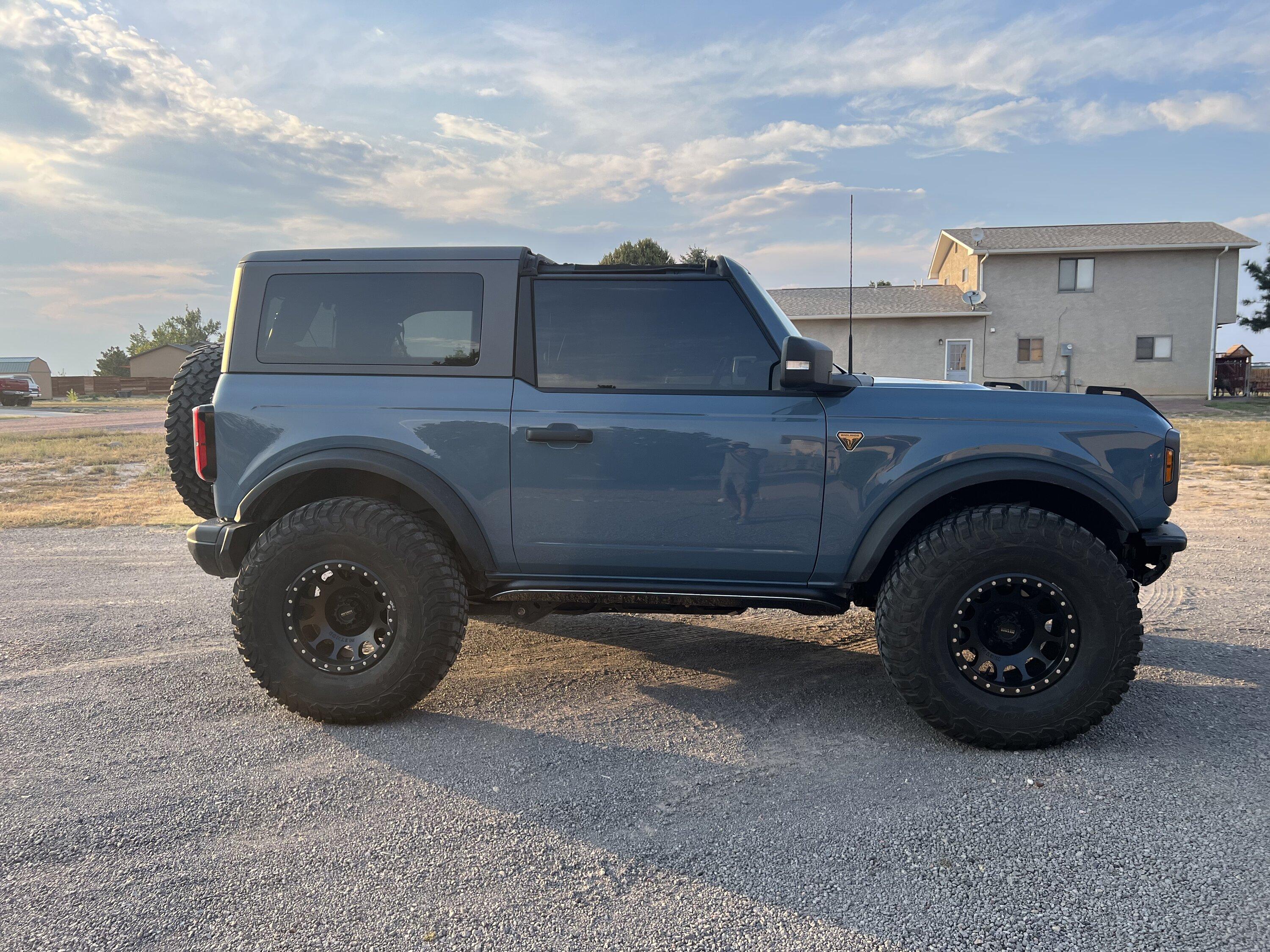

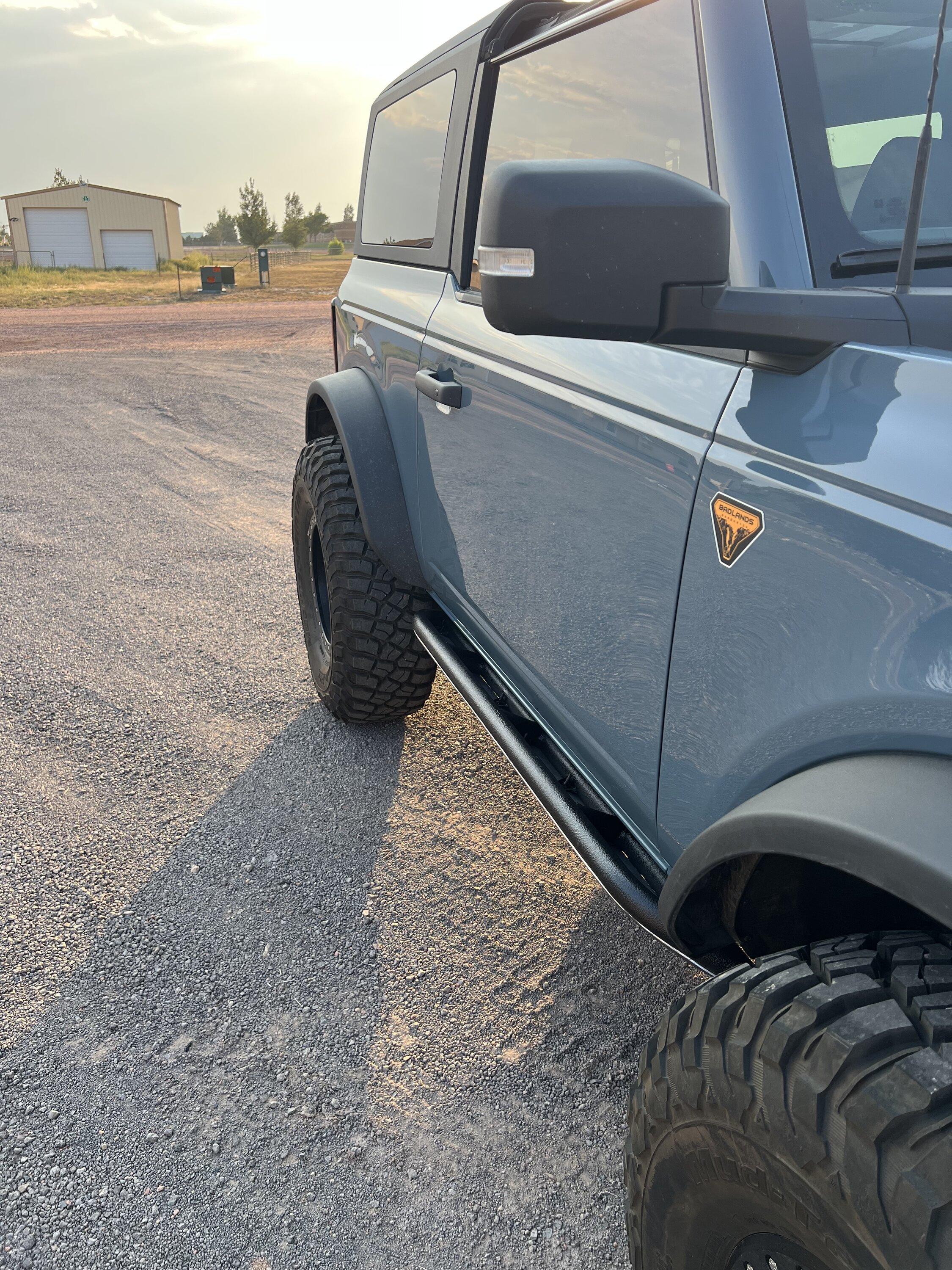

I think that those look great, I know how much fun fab work is! Give me some welders and some metal to weld and I might build you a shopping mall somewhere!
I do wonder though, how close are you to the body of your Bronc? I would worry that should the sliders be used as intended then the weight of the vehicle might push the sliders into the actual body of your "Off Road Destroyer" putting some unsightly dents into the fine Ford body work.
I might be wrong, I can't really tell the gap distance from the pictures.
Anyways, they look good and I am glad that you had fun making them!

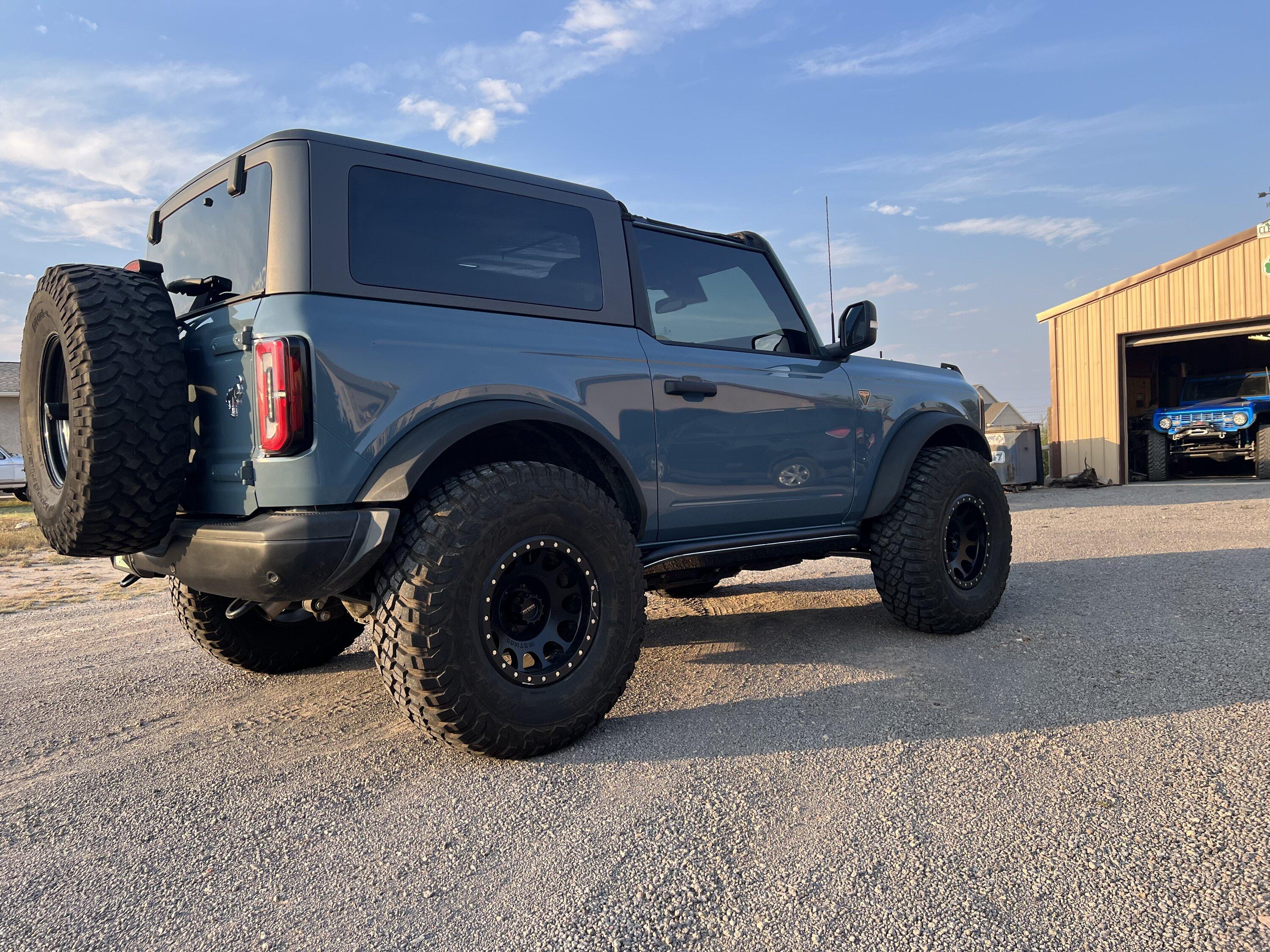

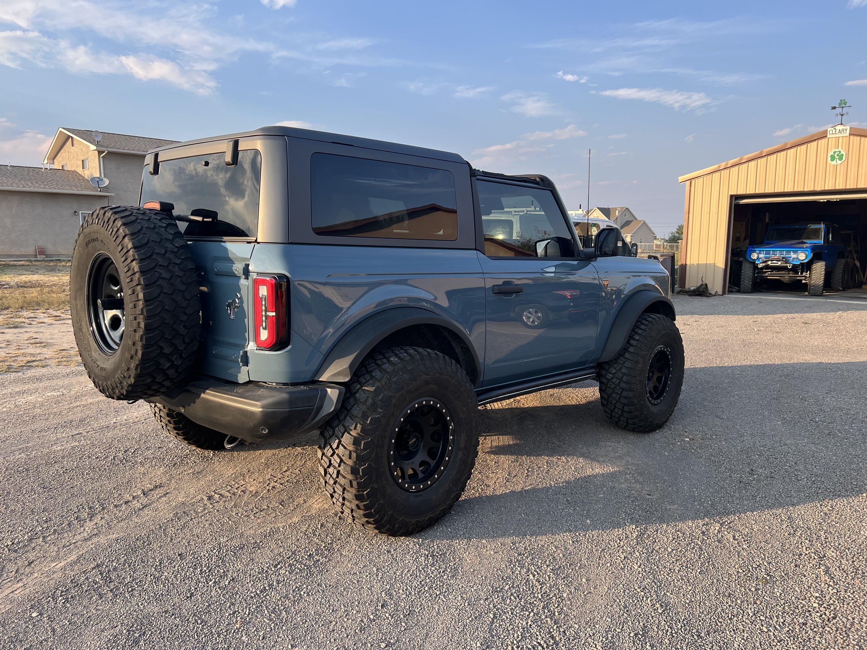

Ok finally got a chance to put a tape measure on it….the smallest gap between the slider and body is 1”. I know the pictures tend to make them look closer cause of the angle.

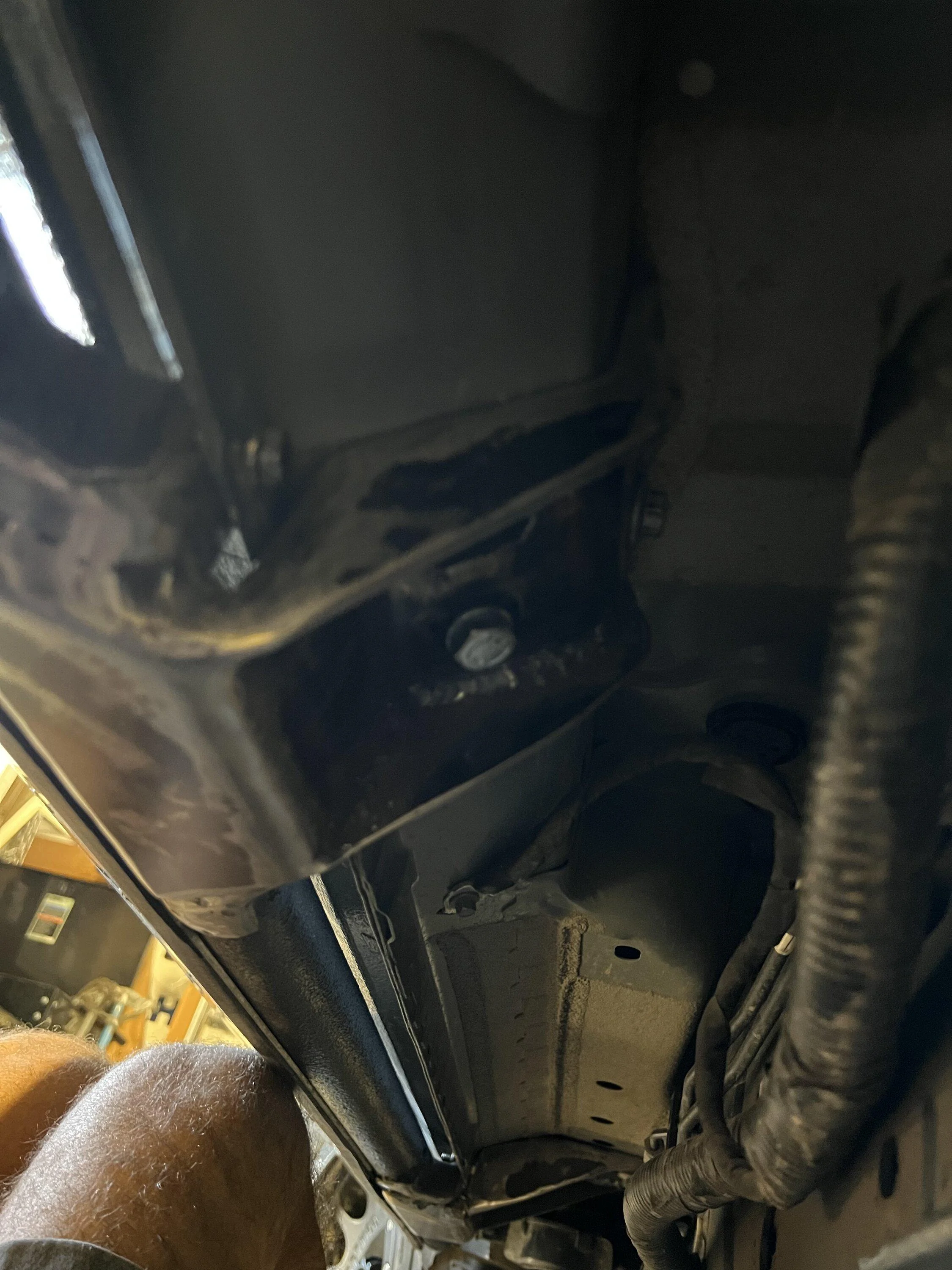

I'd be really interested in seeing how and where you gusseted the factory mounts.
I have a set of extra factory rock rails and a set of JL sliders to weld onto them (carbon copy of @Tricky Dick project).
I plan on doing some reinforcement on the mounts as I do it vs. taking them back off, grinding, painting, having to re-install.
I could figure it out but I may overthink and over-engineer it, as I am prone to do.

Dang I thought I had some farther away pictures on my phone but yes I can. Probably won’t be till tomorrow evening.
Hopefully I’m not to far away now.

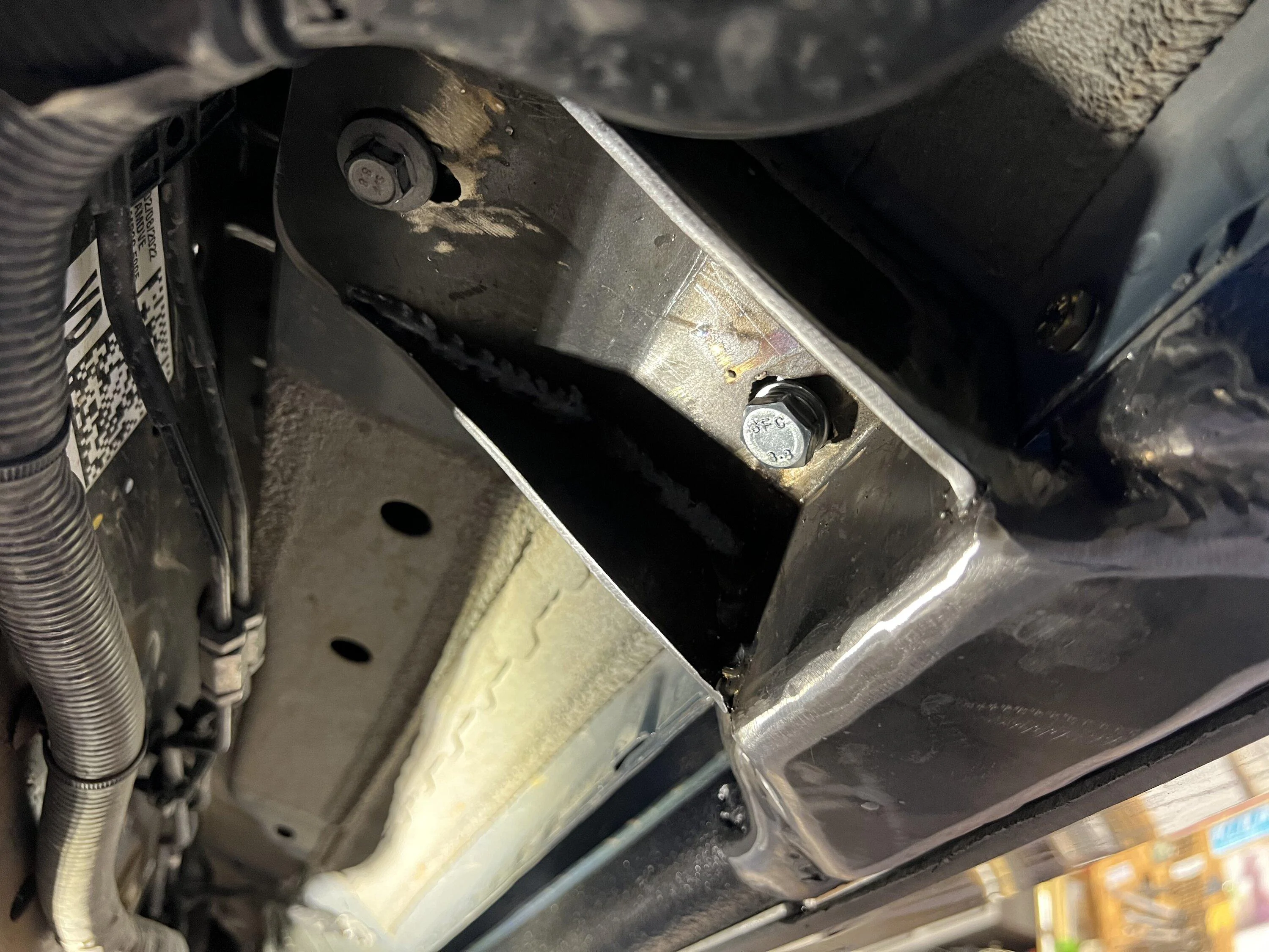

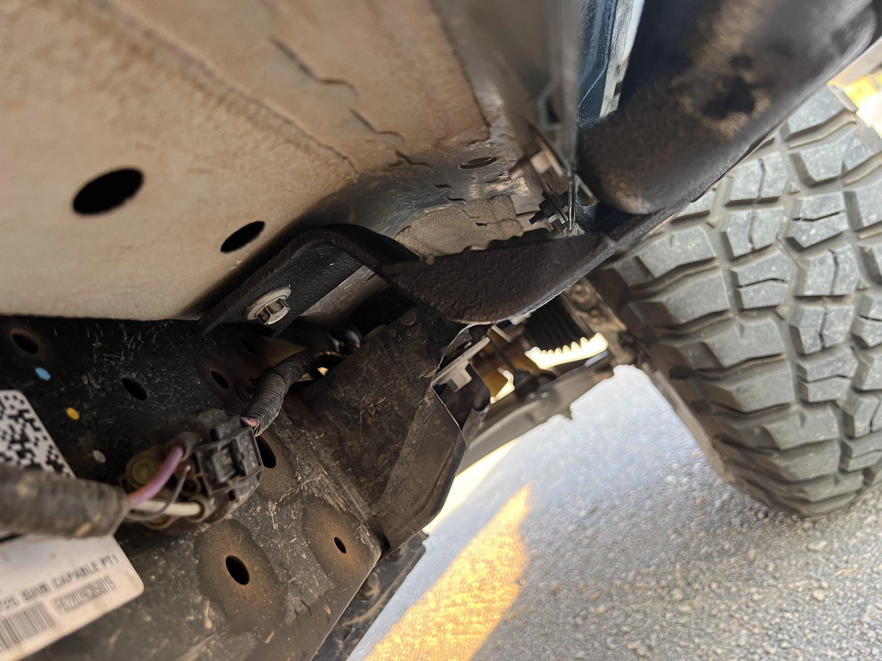

Just in the main unsupported bend I added one on each side. If I had it to do again I would go bigger but I originally planned to put something across to catch the bolt hole underneath with a extra bolt so I needed to keep it accessible….I did change out a couple of the pinch weld bolts to slightly larger grade 8 hardware as well. I’m not sure it will help a whole lot but it’s got to be better than fords lil Chinese studs.
10-4. Thanks, bud!

Wow so the ford rails use the pinch weld ,thats what your kinda out to protect ,you did beautiful work though 👍

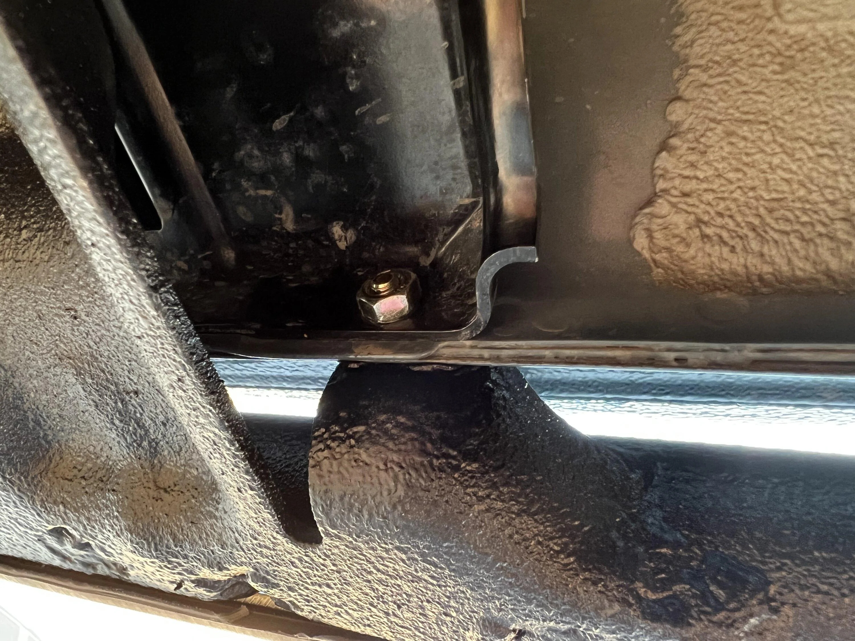

Well the ford brackets got me thru my lil bit of time up at super celebration…..I did manage to bend one a bit with a hard hit to the front outside corner of the slider on iron chest. This weekend I went back and designed and built my own brackets…
