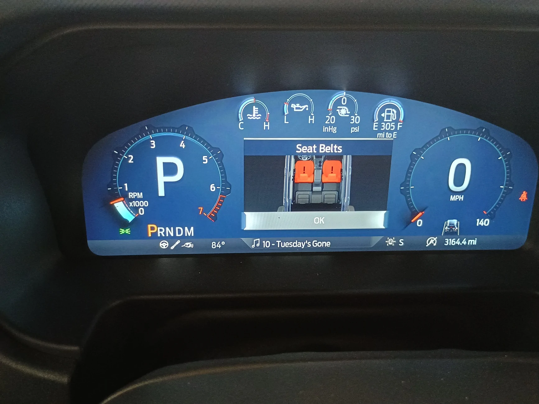

My '23 Wildtrack did not do this when i started it up. My '24 Raptor displays this every time I start it up, until I press the OK button. I've been thru settings and driver assistance and have not found a setting that turns it off. Is this a "Forscan" mod and if so, does anyone know which Forsacn setting it would be?
Thank you

Don’t know but it’s on my ā€˜25 every time I start it if my belt isn’t clicked before I hit the button. Slightly different graphic but same thing. Will be following this.

Mine goes away after a few seconds once the belts are snapped in.
