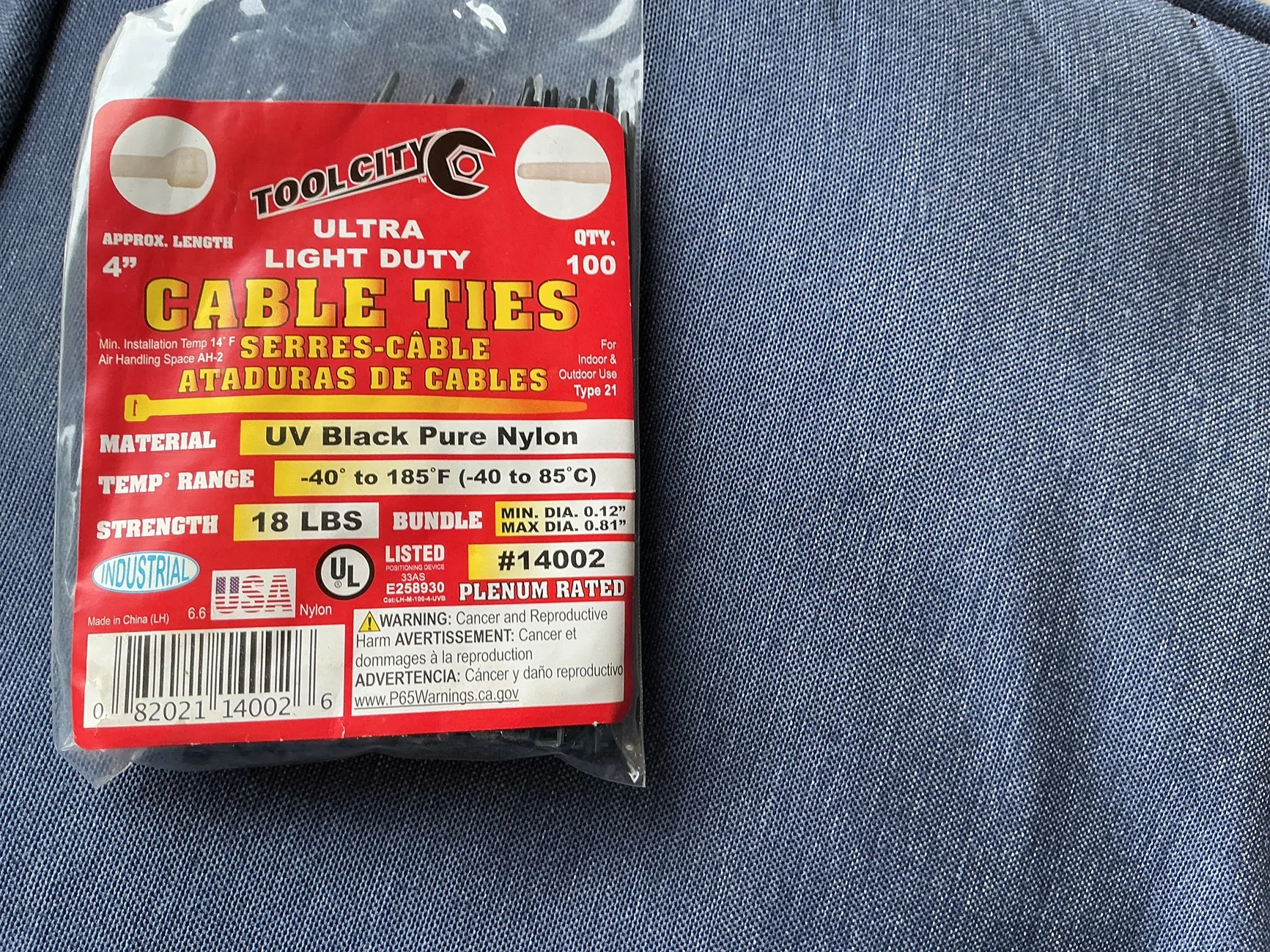

I wanted to disable the start stop feature but am too cheap to spend money on an eliminator. I used a zip tie that holds the button in all the time. I already had a package of zip ties ( see photo) that measures 1/32” thick and 3/32” wide. I cut a piece off at 3/4” long. Push the button in and put it at the top gap of the switch. It still shows the dash icon as being disabled but it also keeps the “off” light from lighting up on the switch. No dash disassembly and you can use a toothpick to remove it when going in for service work.
