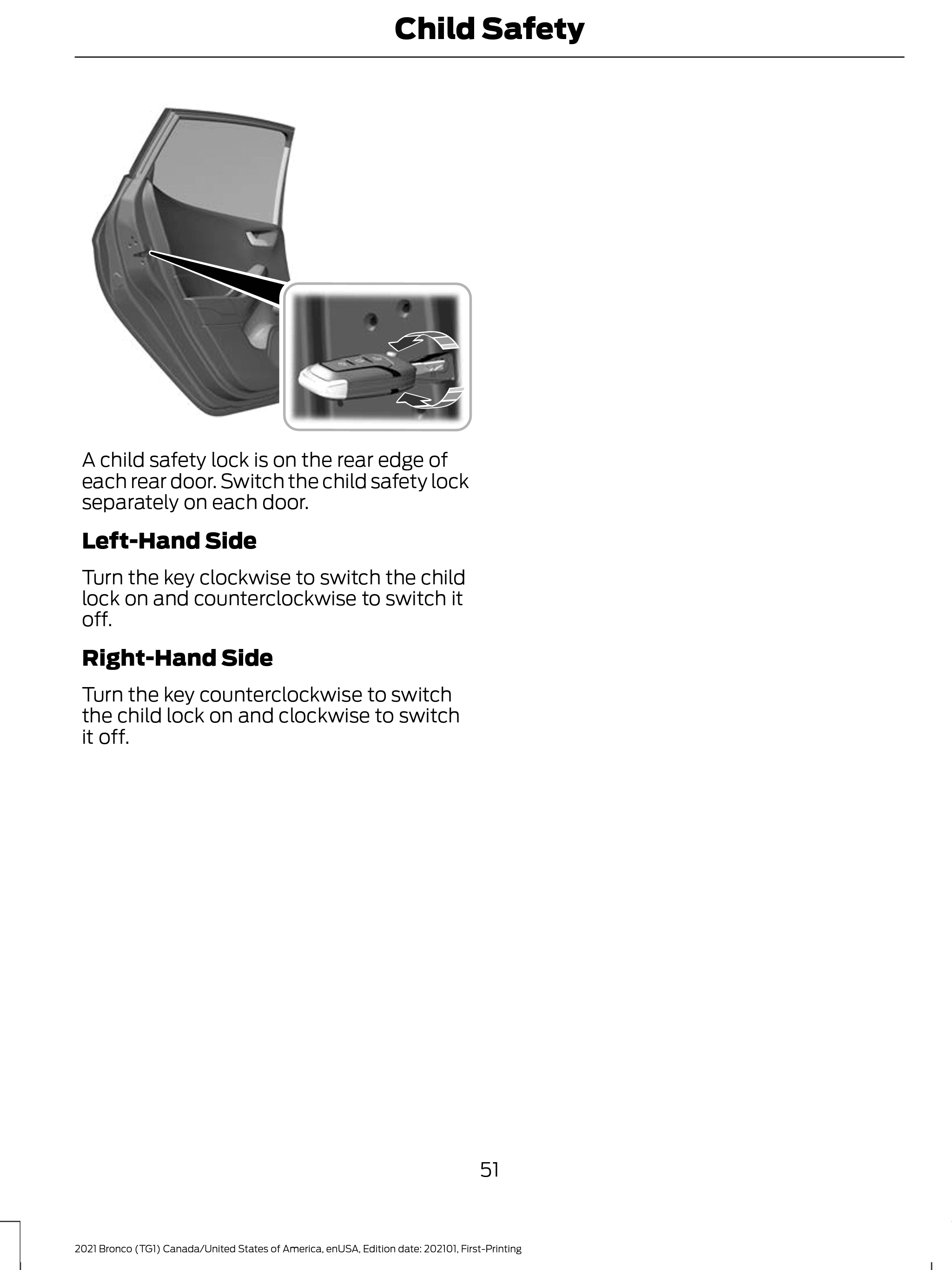

Did you activate the child safety locks? They must be manually activated with a key or screwdriver by the owner. They are not activated by default at the factory.
Child safety locks are covered in the Bronco Owners Manual. For 21MY, they are covered on pages 50-51. For 22MY, they should be covered in a similar location…
