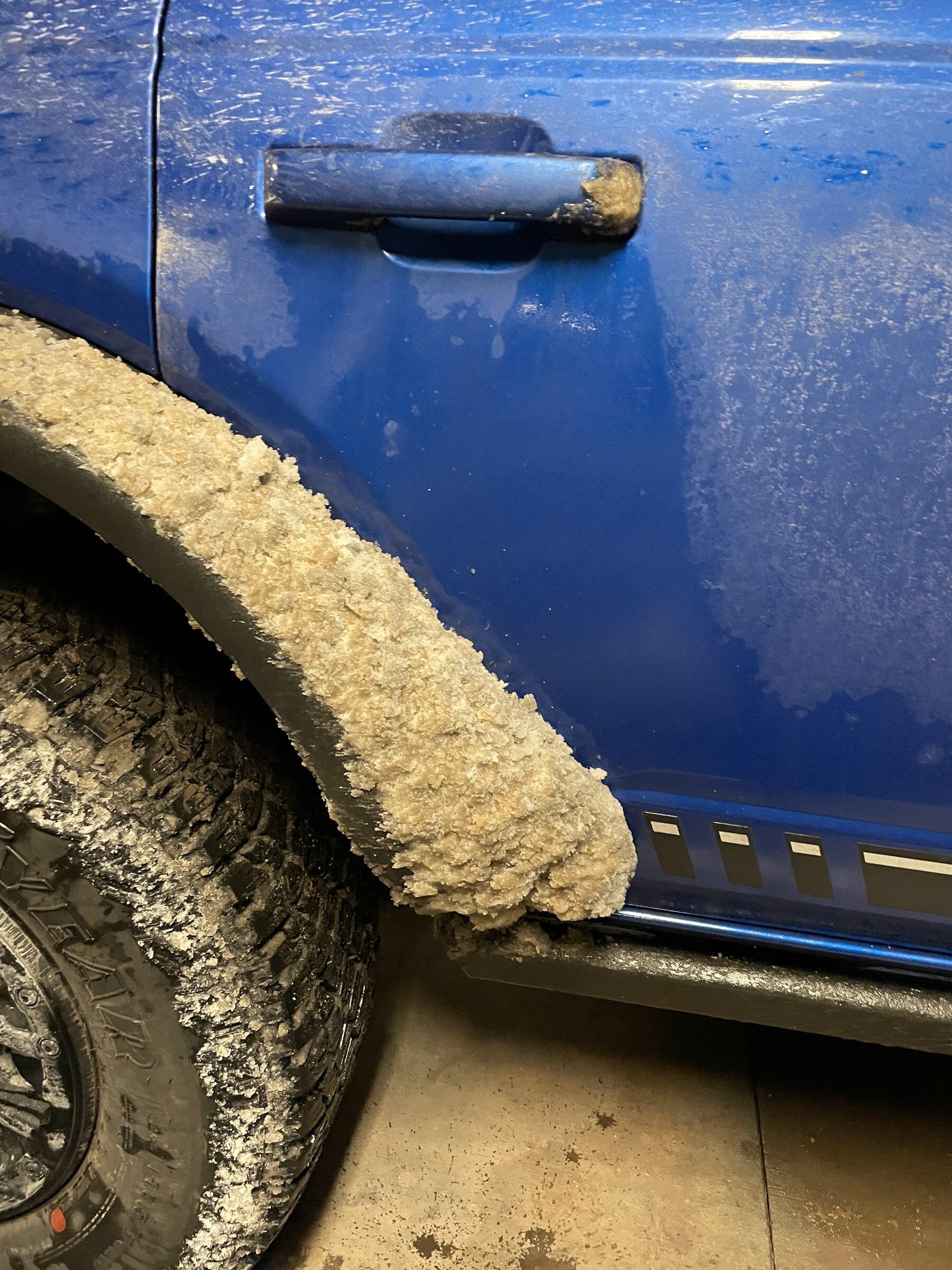

I don't love the look of the Gatorbacks, but my rear fenders look like this every day so I don't think I can wait for Rokblokz or Weathertech to make some. I may just bite the bullet and get the plain black Gatorbacks (and seeing what spews up behind me...probably should be nice and get rear ones also.)

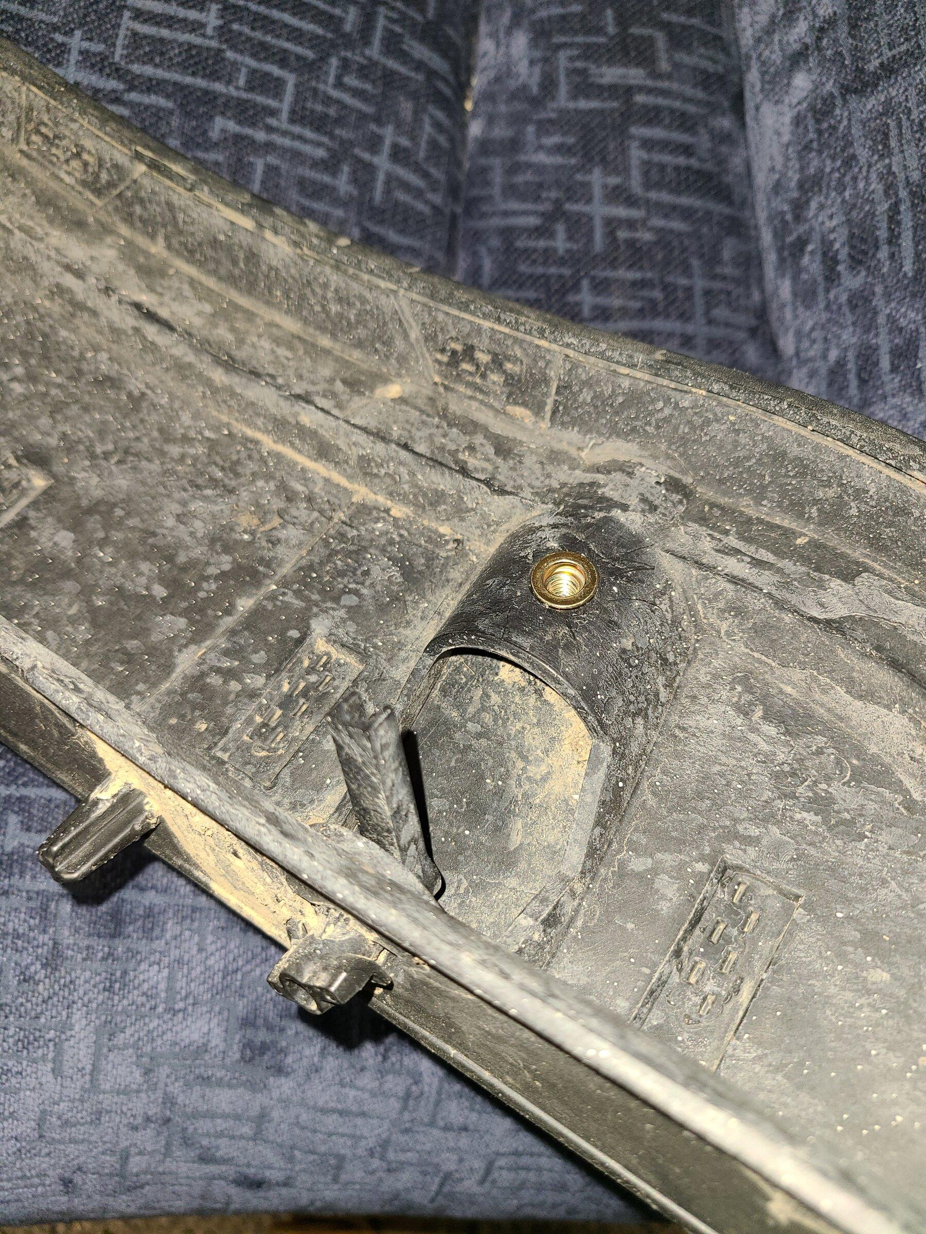

If anyone else is DIY'ing I recommend using a nutsert in the boss under the flare.

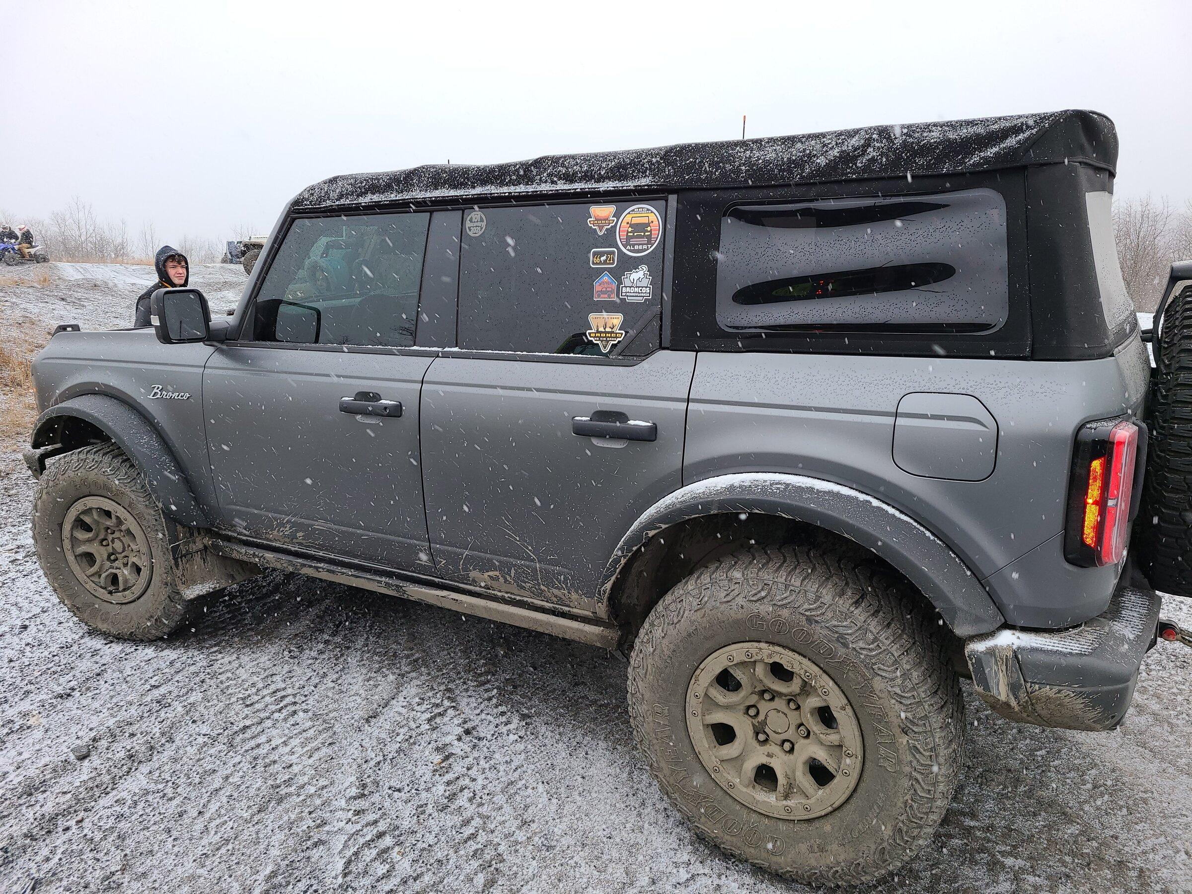

These are holding up well.

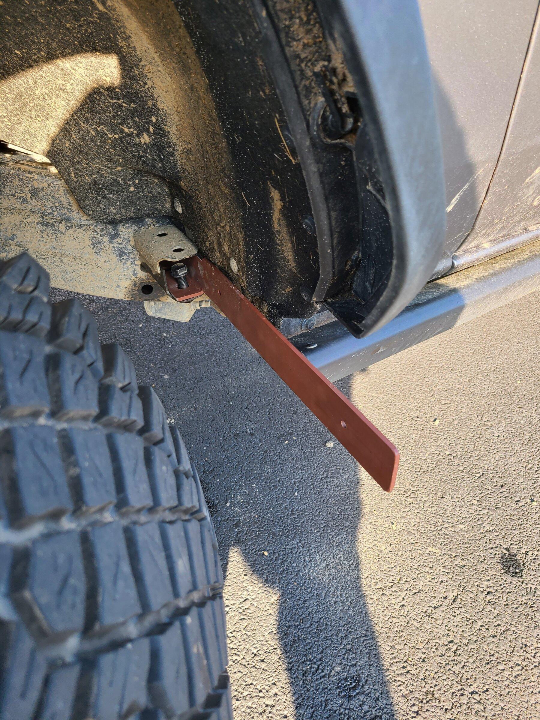

I used 1/8" thick rubber flooring so no need to remove them for wheeling.
Made the mounts out of 3/16" steel and used the intrusion bar mounts that are unused on our models. Repurposed the bolt Ford left in them by removing it from the bottom and turning it face down inside the channel.
So they give me a little cabin intrusion protection as well.
