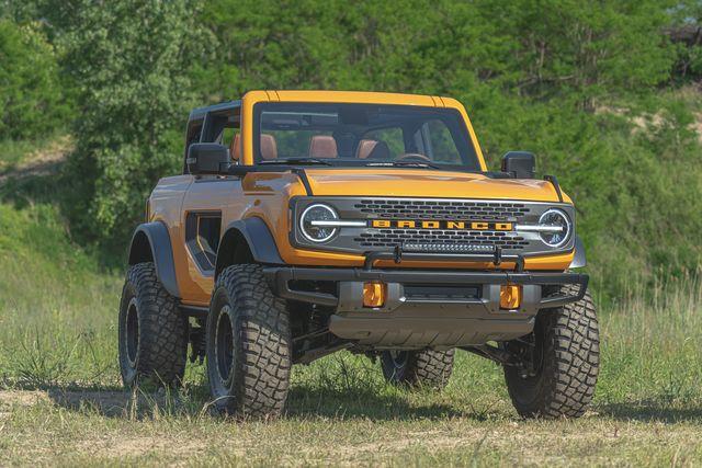

OBX wheels look like they belong on the bronco sport.
Where's the option for this beast we were teased with:
Ford Bronco Sasquatch lite package -139-1594328607.jpg?crop=0.811xw:0.811xh;0.105xw,0
100% agree.
However the lack of that pretty saddle leather, warmed up to the marine vinyl and saved me few grand. I did have to cough up the $$$ for the upgraded wheels. The base wheels are terrible. Almost an exact copy of jeeps.
