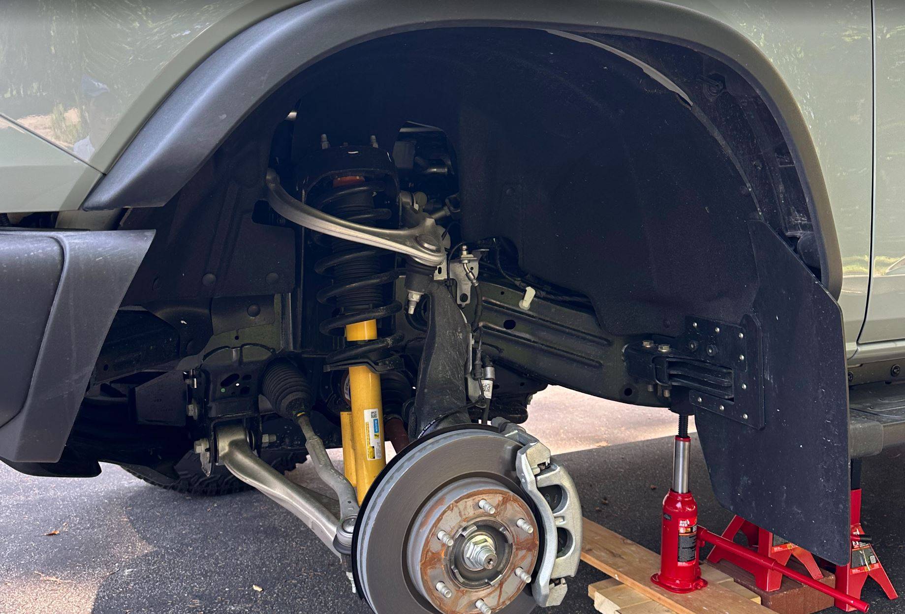

here are some images of front and rear bars. you can see it better with the pix when I was rotating the tires. I have the Rokblokz mud flaps and the bar sits flush against it.
Oh thats awesome! Thanks for the pics.

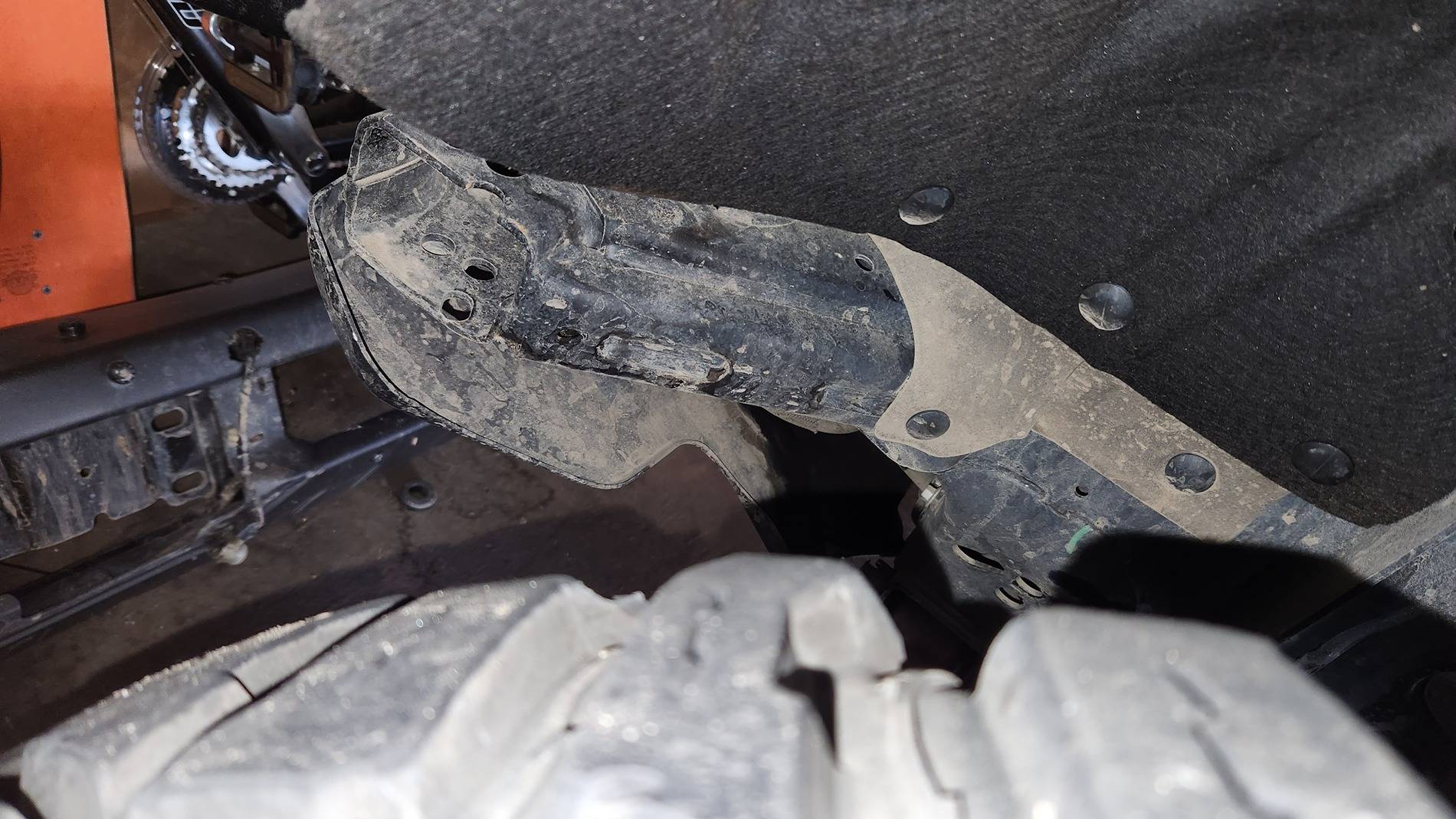

I have been running 37s now for over a year with +25 Icon Rebound Pros rims. I only had to cut the front bar off at an angle and it never rubs. I did trim the rear bar.
