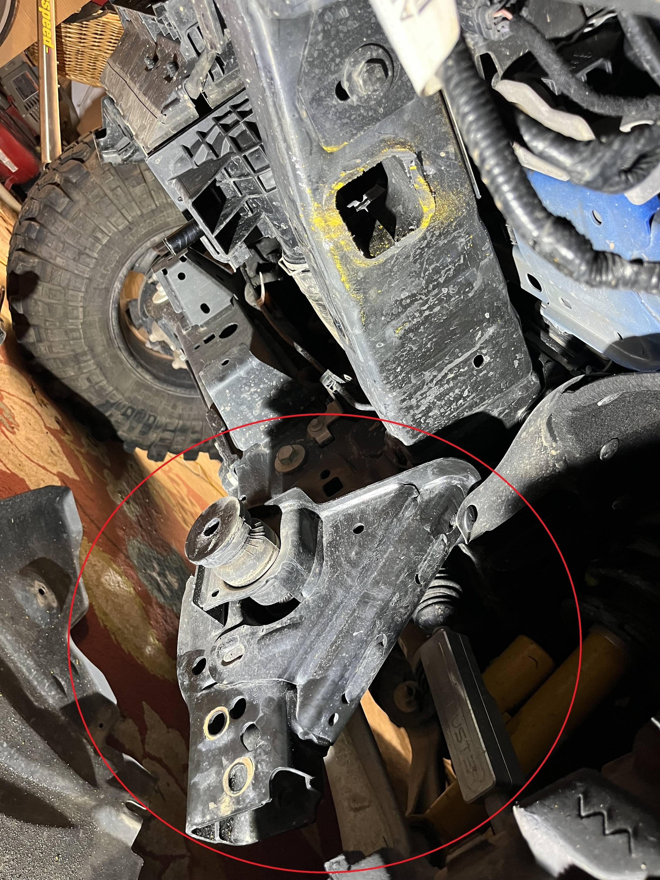

This is what the front crash bar holder looks like in the process of removal:
Ford Bronco SAS Package Crash Bar Removal HZRZ2lP
There is also a crash bar with a removable insert at the rear of the wheelwell, but I left mine in place when I went to 37's. My setup causes the tire to rub the frame and sway bar disconnect bolt much more forward than that rear location.

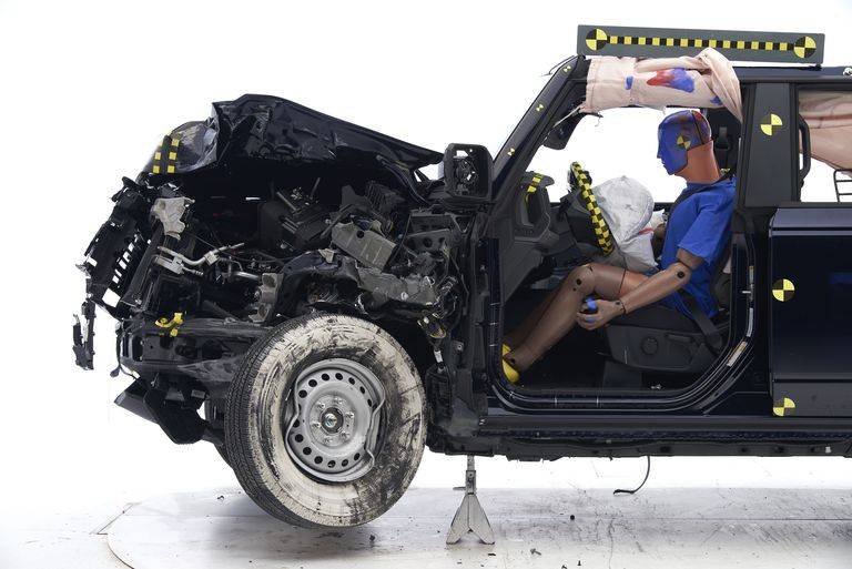

Note the flattened sides of this wheel, that is the crash bars doing their job, containing the wheel inside the wheel well during a crash.
My personal choice is to run crash bars. I have the Extreme Terrain ones linked upthread that fit 35’s.
Thanks for sharing that photo. Puts this into perspective. I'll check out your link above.
