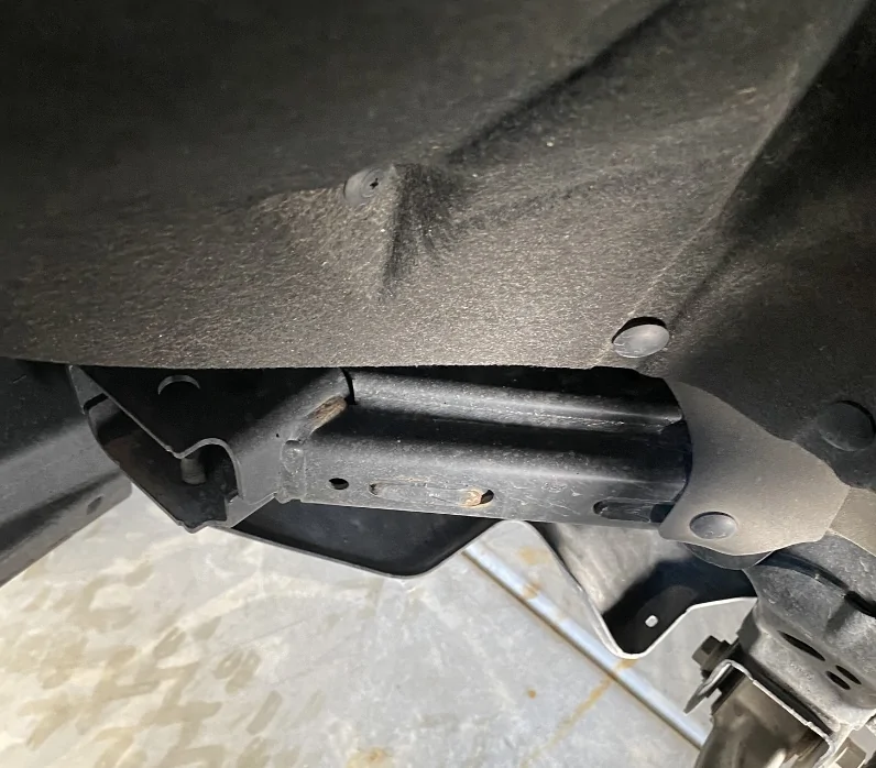

I’ve seen lots of great post from people who’ve cut off the front crash bars/body mounts and installed kits from JKS, Stinkyfab, Lobo and others. They all seem to be good quality and work for their purpose.
As I’ve looked at my crash bars trying to decide what to do, I keep thinking, if I’m going to pull out the plasma or saws all, why not just cut away the unneeded bulk of the existing mount and leave the rest in place.
has anyone done this? If so, do you have pics? What am I missing?

You can do that, plenty of people did before JKS and the like came up with their kit.
It's just a bit more difficult to do based on how that mount is constructed, the entire thing leans around the fact that you have to preserve the intercooler mount that is shared on that bracket.
That entire bracket just has a small 1.5" square tube connection to the frame, makes it easy to cut the entire thing off. But you do that and you lose the intercooler mount. It takes a lot more cutting to keep that frame mount and work around the intercooler mount. But it can be done.
I can also say - for most people, cutting off the crash bar mounts wasn't really required. Depends on your tire size and offset. The little bracket that comes with the JKS to pull the front fender liner back was really the only thing I needed out of the whole kit. But I suppose it was good insurance. And the wheel wells look a lot cleaner.

Agreed with @Brian_B
It would be way more work to cut around what’s there vs simply cutting it entirely off. I’ve seen a few where they cut off the ends, and it just looks janky. Spending $50 from stinkyfab was worth the money. Looks so much better even if you don’t need the clearance. Those things are an abomination.

That's good insight. I'm running 37's and I get a little bit of rub on the crashbar if I have a wheel stuffed at full lock. I probably wouldn't even worry about it, but I'm going to be putting on a new front bumper in a couple of weeks and been thinking about doing it while I have bumper off.

You do make a good point that the existing kits really clean things up and look much better than the crash bar mount.
