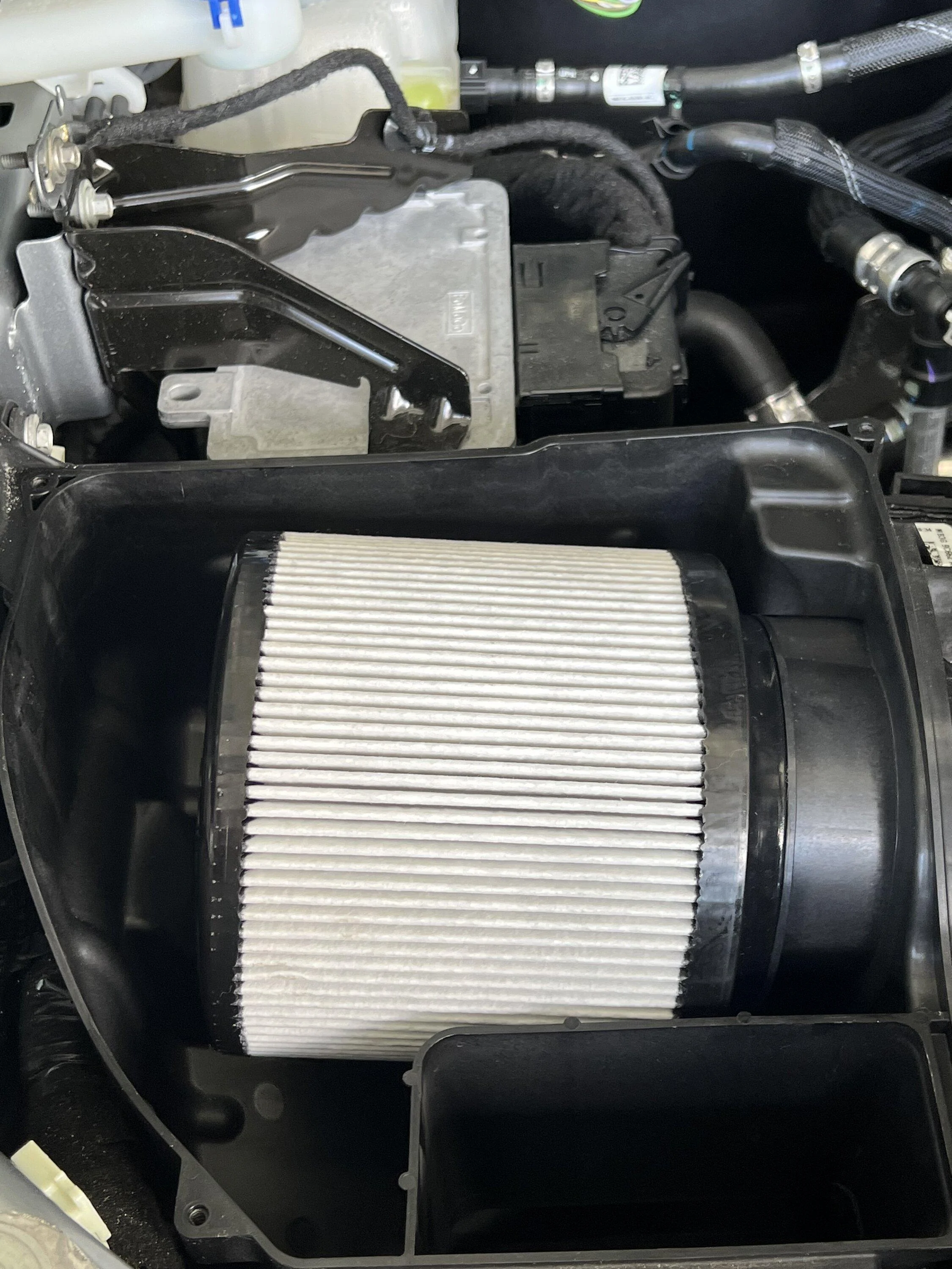

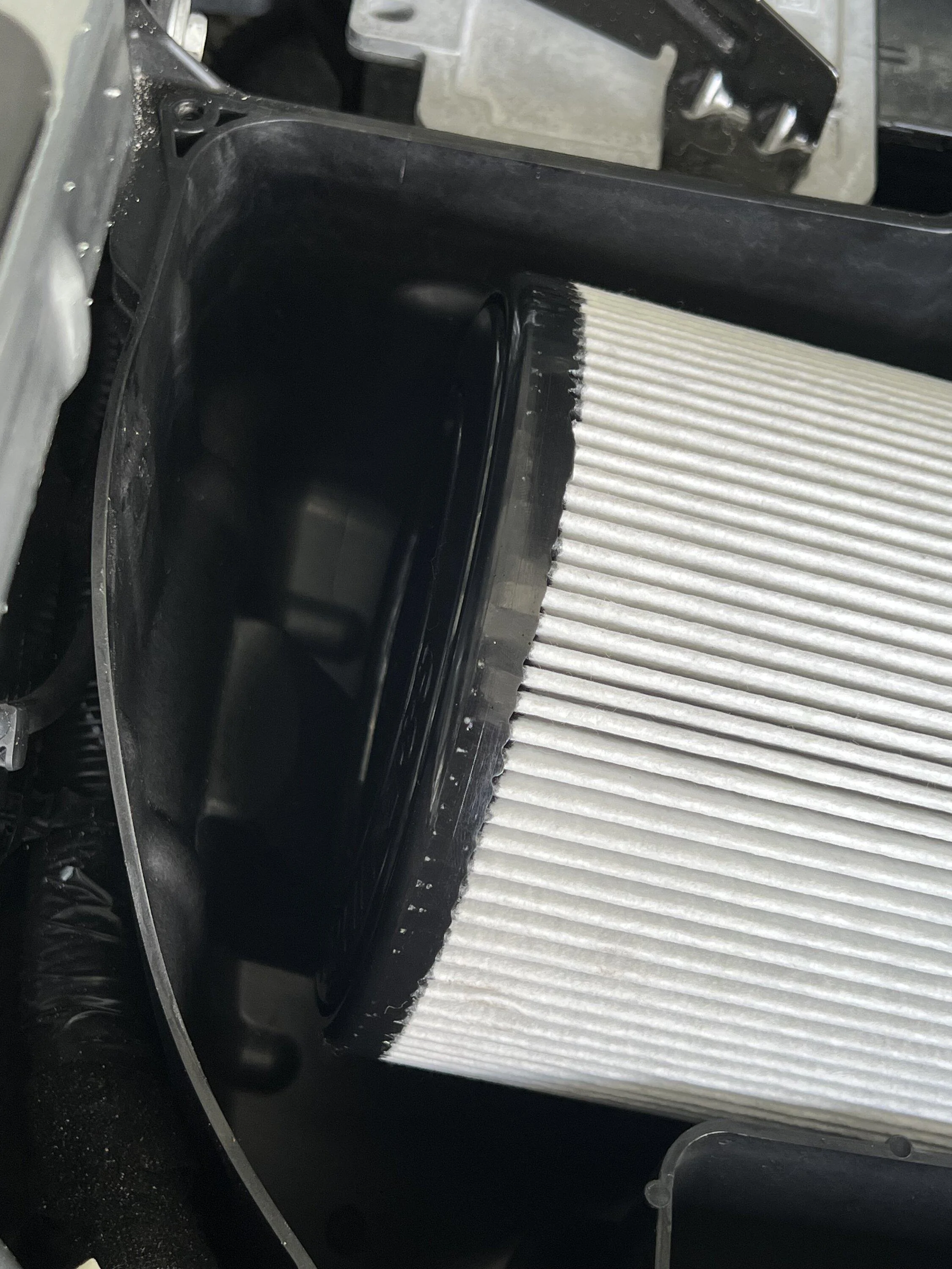

Got mine installed yesterday, definitely an upgrade over the factory filter. Also definitely very snug fit in the airbox
yes same thing for me, thought it wasn’t going to fit at first. Just have to pull out a bit on side and it’ll pop in. 👍

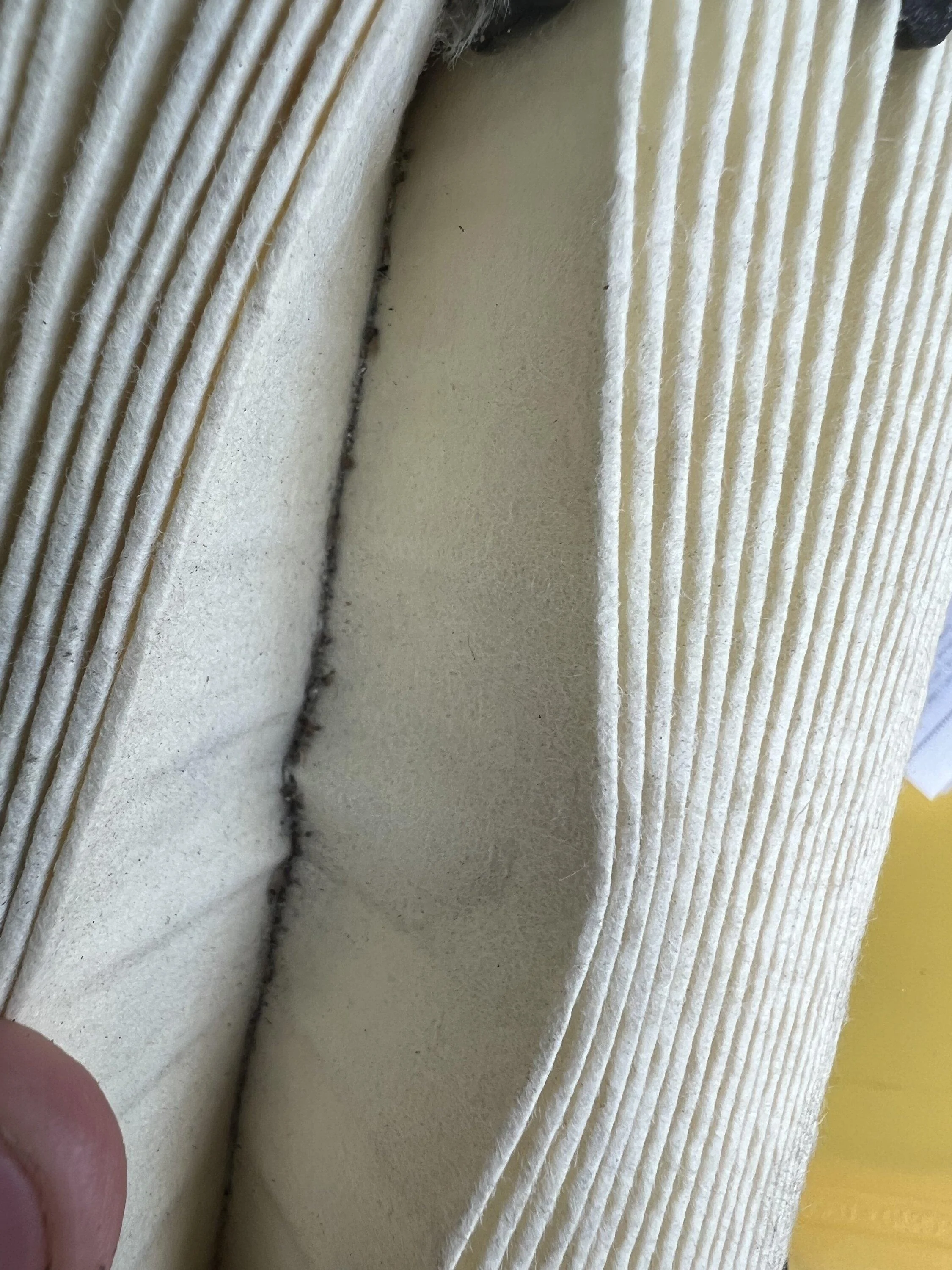

That OEM filter with wavy/deformed paper pleats looks like garbage
S&B looks like a much better made filter
And that's why looks can be deceiving! lol

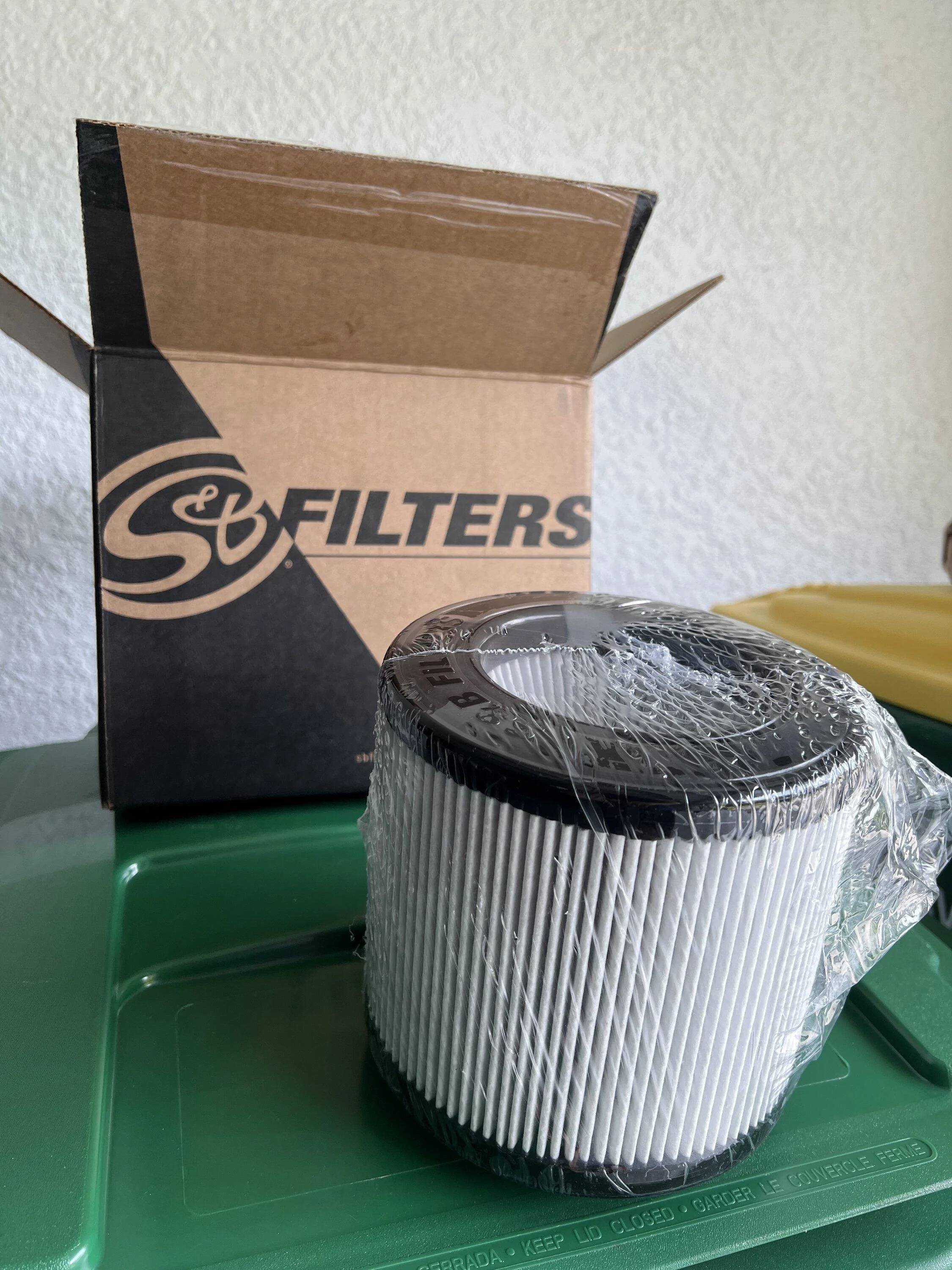

I got my new air filter delivered today and wanted to put out a review as I’ve seen this topic going back and forth. Lid has 4 t30 screws that need to come out, and a plastic push pin on the front, and then comes right off.

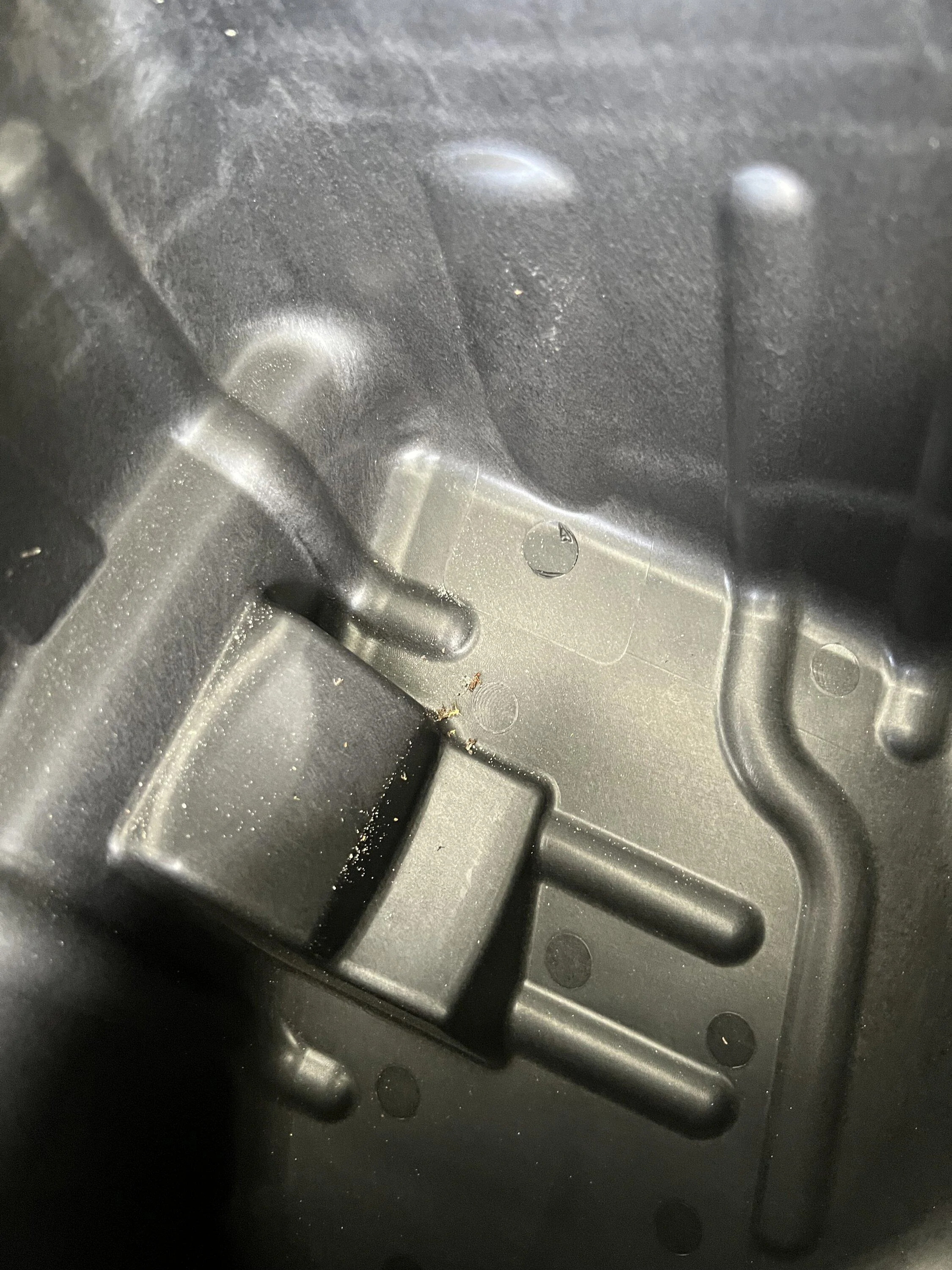

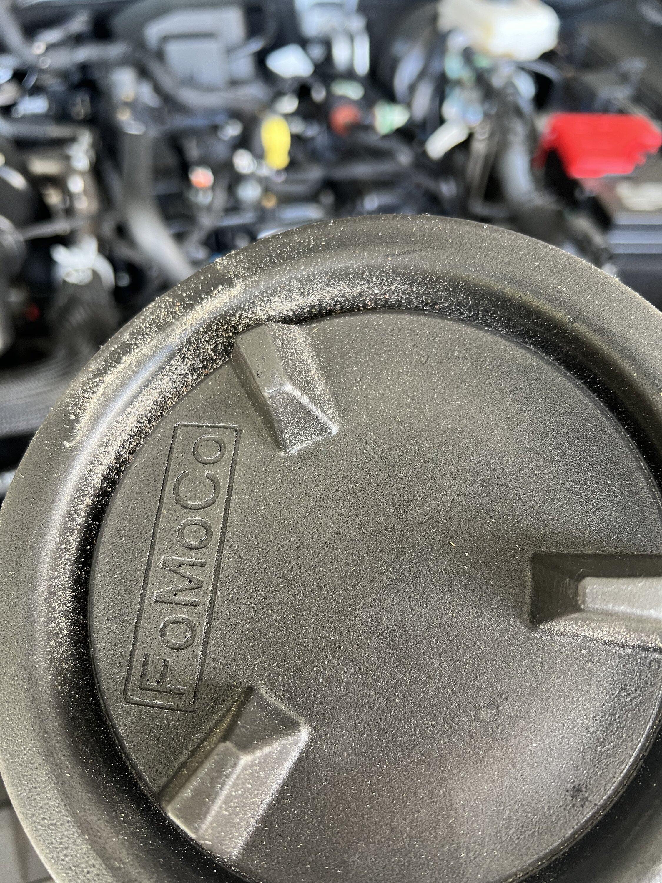

First thing I did was inspected the stock air filter, and to my surprise, there was a decent amount of dust and dirt in it. My outer banks has roughly 4,000 miles on it. There was even some dirt in the bottom of the air box. The stock filter does a great job of filtering, but I also believe it’s limiting the air intake a decent amount. Install was super easy, no hose clamps or anything needed. It’s actually held into place by a piece of molded plastic in the bottom of the intake. You have to put in a good amount of force to get it in so it will sit flat.
once you do that, screw lid back on and done. I was able to take it out for a bit of a test and there is a pretty noticeable improvement to throttle response. I was actually quite surprised. Feels like it’s opened up a bit of response that was already there. The stock intake is actually a pretty good design, I really don’t think anything more than a drop in filter is necessary. Also, I wouldn’t use anything more than a dry filter. Cost me $70 for the filter and it was definitely worth it. I’m going to pair it with a whipple intercooler and a tune. All those paired should wake it up quite a bit.

If I'm seeing what I think I see, the S&B doesn't have an end cap like the factory filter an has filtering area inside as well as outside. This could greatly increase the flow potential without reducing the filtering effectiveness.
It’s recessed. I’m sure someone can post pics…mine's already installed.
