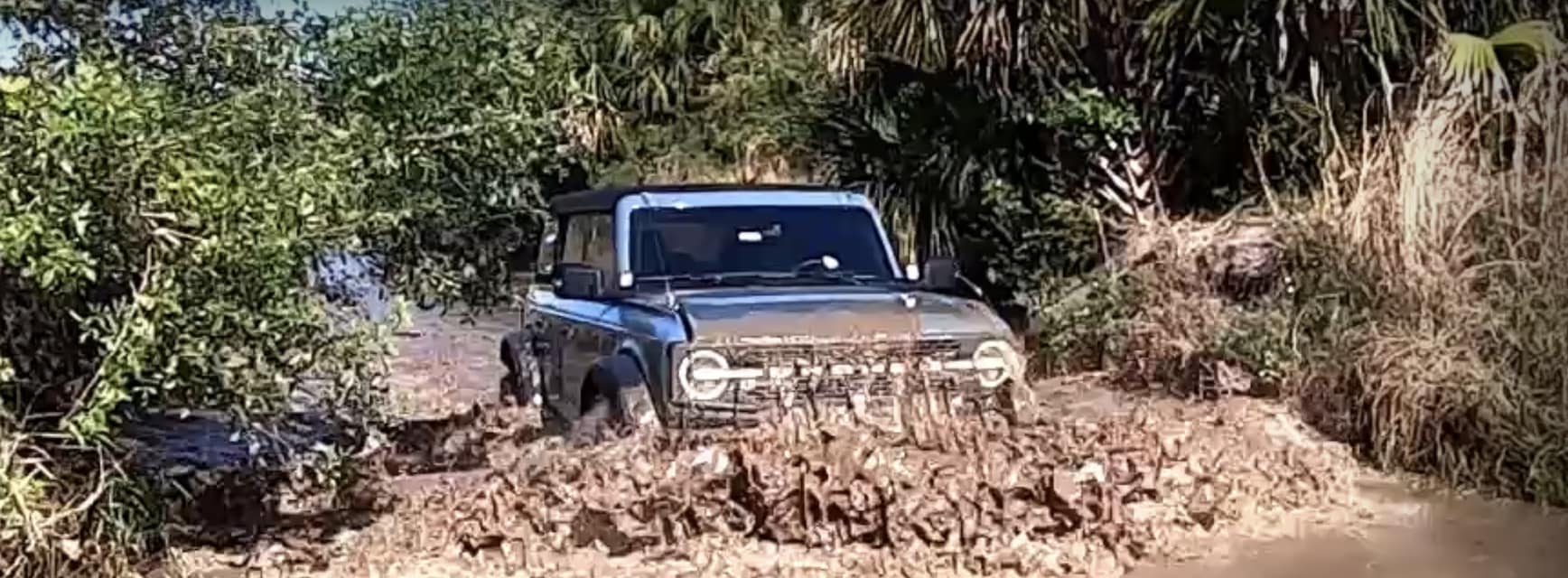

How fast were you going through the mud hole to get that much sediment that high on your inner fender support?
What else have you had to replace? Alternator?
It looks like you had a lot of fun, can I come next time???
I haven't had to replace anything. The alternator has been fine, but I replaced the alternator cover with the revised version from Ford found in other threads.
The more the merrier, if you are ever in FL lol but honestly it doesn't take much to get that much sediment into the airbox. This was also after a very very dusty run at an off-road park here in FL.
Here is a screen grab from a video a friend took. Once water goes by the hood and grill, it is getting into the airbox, even with the little flap they have on it. I agree you should be at a crawl going through water but a little fun (speed) and this happens. Sometimes you need a little speed to get through a water/mud hole... I remedied it with a snorkel since there is a lot of water in FL.
