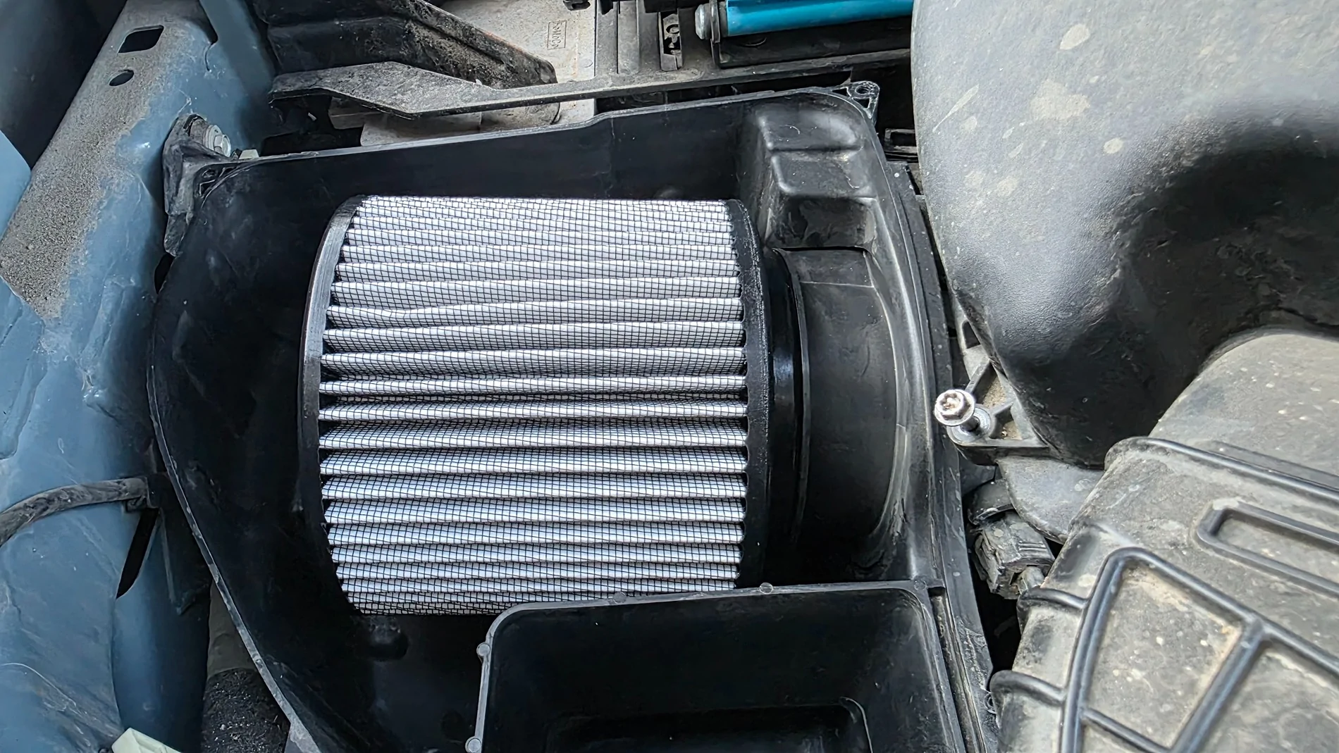

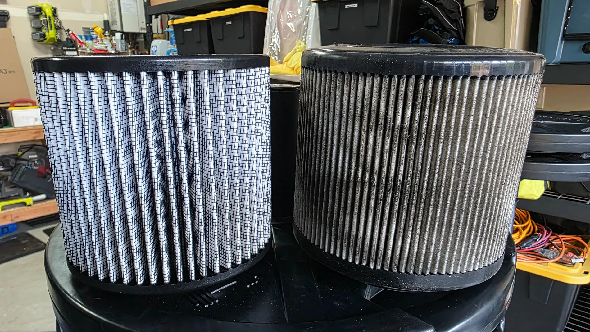

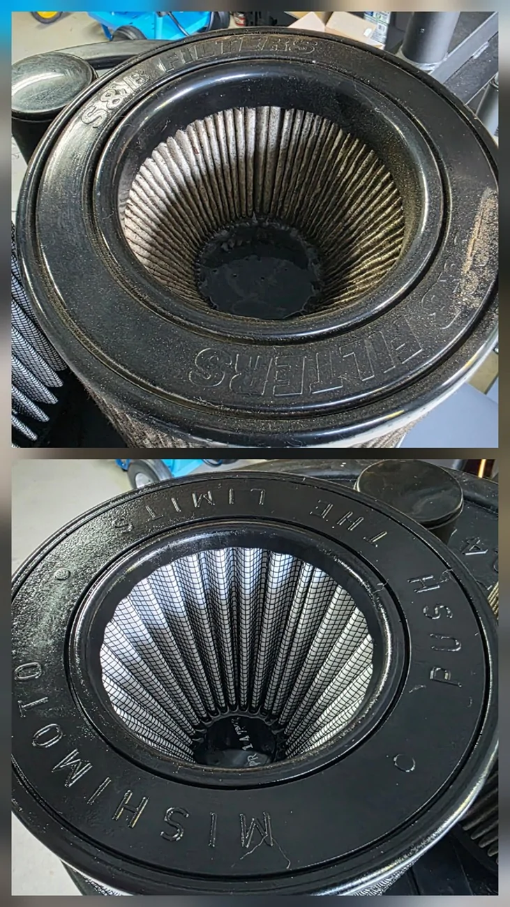

In case anyone is curious. I've gone through a few S&B. Quality seems great. They are out of stock currently so decide to try Mishimoto Powerstack dry/washable drop-in for the time being.
Obvious differences between the two (S&B dirty versus Mishimoto new):
1. Mishimoto has significantly less pleats.
2. Mishimoto appears to use a thinner paper/medium
3. Mishimoto has a significantly deeper front recess
4. Mishimoto is less tight in the OEM box
My guess is the Mishimoto has better flow. Not 100% sure if I trust it for dusty offroading. I'll hold onto the S&B for trail since it doesn't seem dirty enough.
