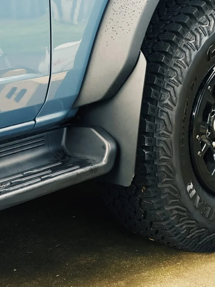

We designed ours to be as low profile in the fender wells as possible. Typically if you rub on ours then you’ll be rubbing the fender-liner. Broflaps.com / USA made. We only do flaps for Broncos.
Ford Bronco Rubbing on 35s IMG_4527

it not hitting the flaps themselves, just the quick removal thumbscrews. I'l replace those with buttonheads and see where i go from there.
turns out also, rokblokz acknowledges this issue and sells a kit to sort it out that looks nice. saves me a trip to the HW store.
