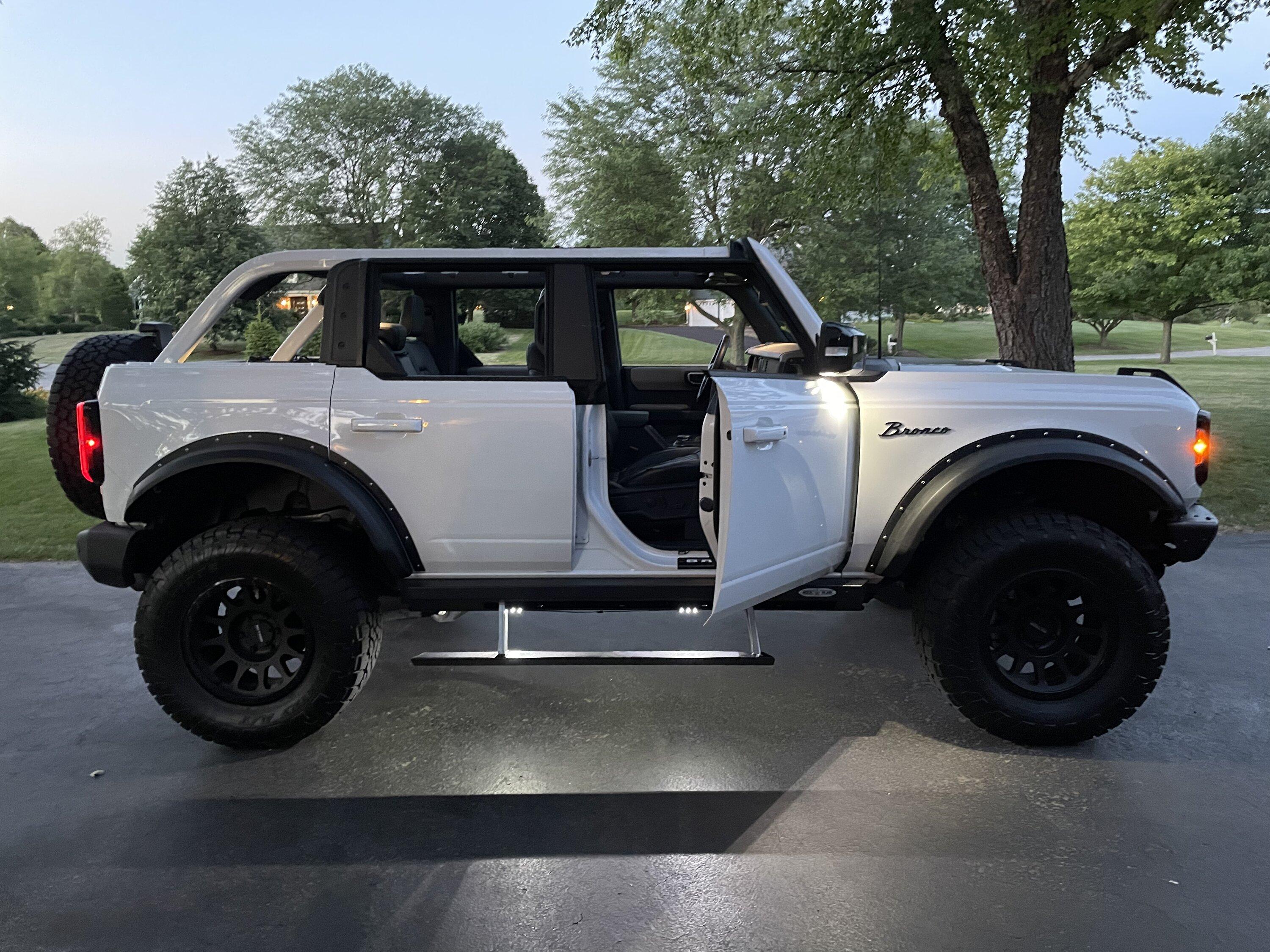

Mine been sitting in the garage for over a year and finally got to install them last Sunday. Spent the whole day but could greatly reduce the time doing it the second time. I still need to put on the lights but I don't think that will take long. I was amazed how beefy this setup is. Compared to the factory rails, its a night and day difference.
A couple of things though. It appears that I received the wrong grommet that goes in the floor. Mine is just a rubber ring and it looks like I should have gotten a solid one. Anyone else get the wrong one?
I think these steps really help getting in the Bronco but I'm still trying to figure out the best way to get out of it. Every way I've tried seem awkward or my leg/pants rub on the upper black portion which will either have mud or salt all over it at some point. Just doesn't feel natural any way I do it.

Yeah that was common on the first batch. I emailed their support and they sent the correct grommets out immediately.
I have a leveled badlands and the stup up is perfect for me ... Only problem is if they ever break or get stuck closed, they will be awkward to climb over.

I was part of an early group buy purchase and while waiting for my bronco, I saw a lot of other sliders coming out. I was contemplating if I made a mistake with the early purchase, but when I finally got my bronco I was very happy after installing the RSE sliders. Each time the door opens for my passengers or myself, I know I made the right choice. Also when I look at how other sliders mount, I feel so much better about how the front and rear mounts use the frame to body mount points.
