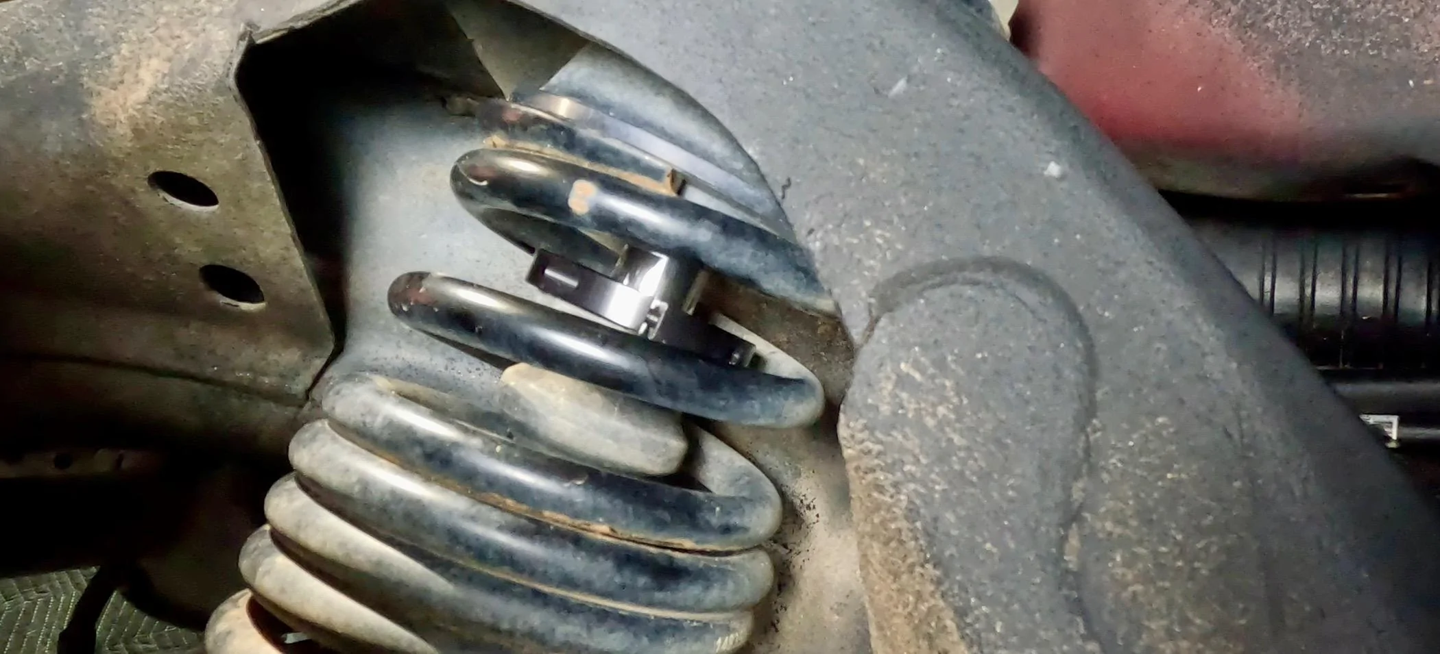

someone on here mentioned that Icon makes a “bump stop spacer” for the coilovers I’m running… and they’re installed, just waiting for an opening with a forklift to see if it solves the TOO MUCH ruck issue!

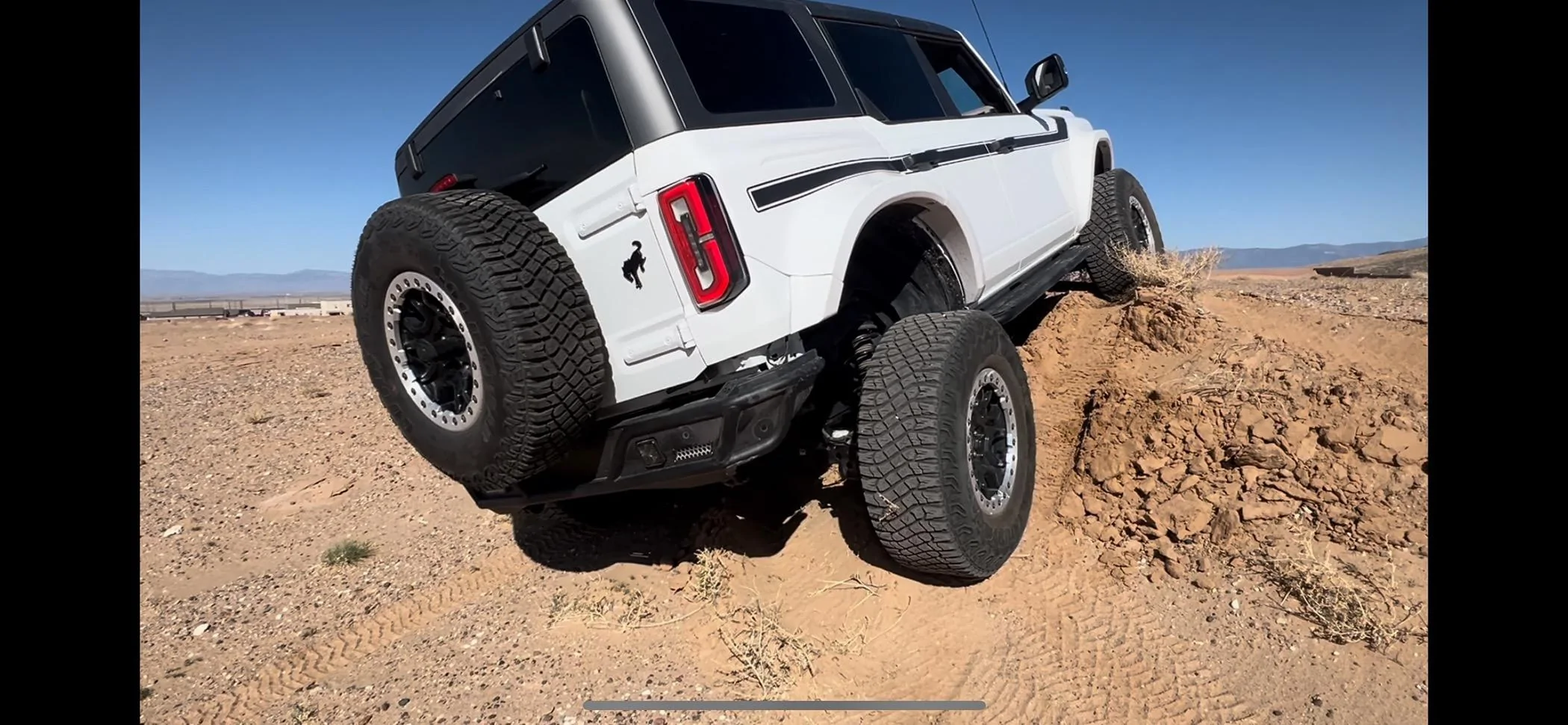

Thought I’d add to this thread after getting our kit installed.
Wow. The on-road manners have improved. I never felt the kick that people talk about going over expansion joints or anything, but the steering somehow feels tighter. Wasn’t expecting that part. It’s tracking so well I’m not worried about taking it in for an alignment check either. Just going to run it as is. But we did a quick check on a little mound we’ve previously tested articulation on for the Boss Links. Previously we were able to get the rear tire to lift before making it to the top, but now (assuming the mound hasn’t been worn to erosion) we make it all the way to the top with both rear tires still firmly planted. Very impressive. I’d recommend this to any bronco owners.

We just tested our bumpstops out today… will be posting the update video soon.
needless to say… these are worth the $55
