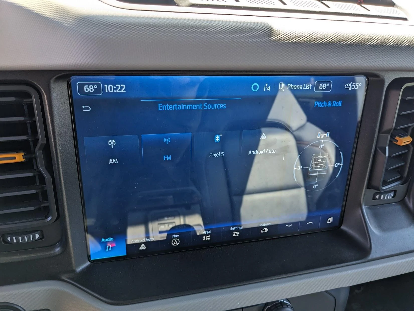

I was able to successfully remove SiriusXM as an audio source option from my 2022 Badlands with FORScan!

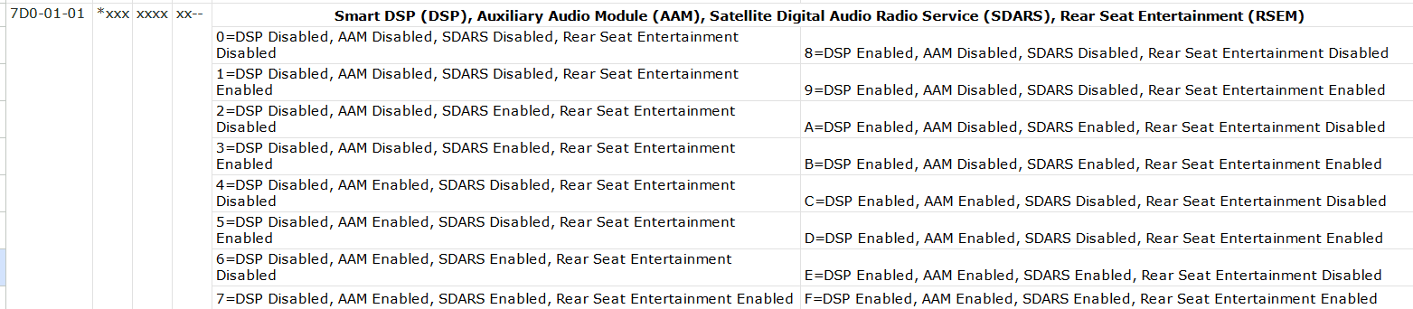

What you need to do is go into the APIM and find this address/value: 7D0-01-01 *xxx xxxx xx--
Decrement the 1st position hexadecimal value by 2. For example, my Bronco had "A" in that spot, so I changed to to "8".
For reference for those (like me) who aren't familiar, hexidecimal is in this order: 0 1 2 3 4 5 6 7 8 9 A B C D E F
The F150 forscan spreadsheet for APIM/Sync3 has the list of options for that 1st value (SDARS is SiriusXM). Based on it working perfectly on my Bronco it seems safe to assume this information is also correct for Sync4:

No more XM option!

I would think that you could check the value on your APIM and increase the 1st value by 2 to enable SDARS and keep other options the same. This should at least enable it as a source option on the APIM, though I don't know if you would have to make any hardware changes.
