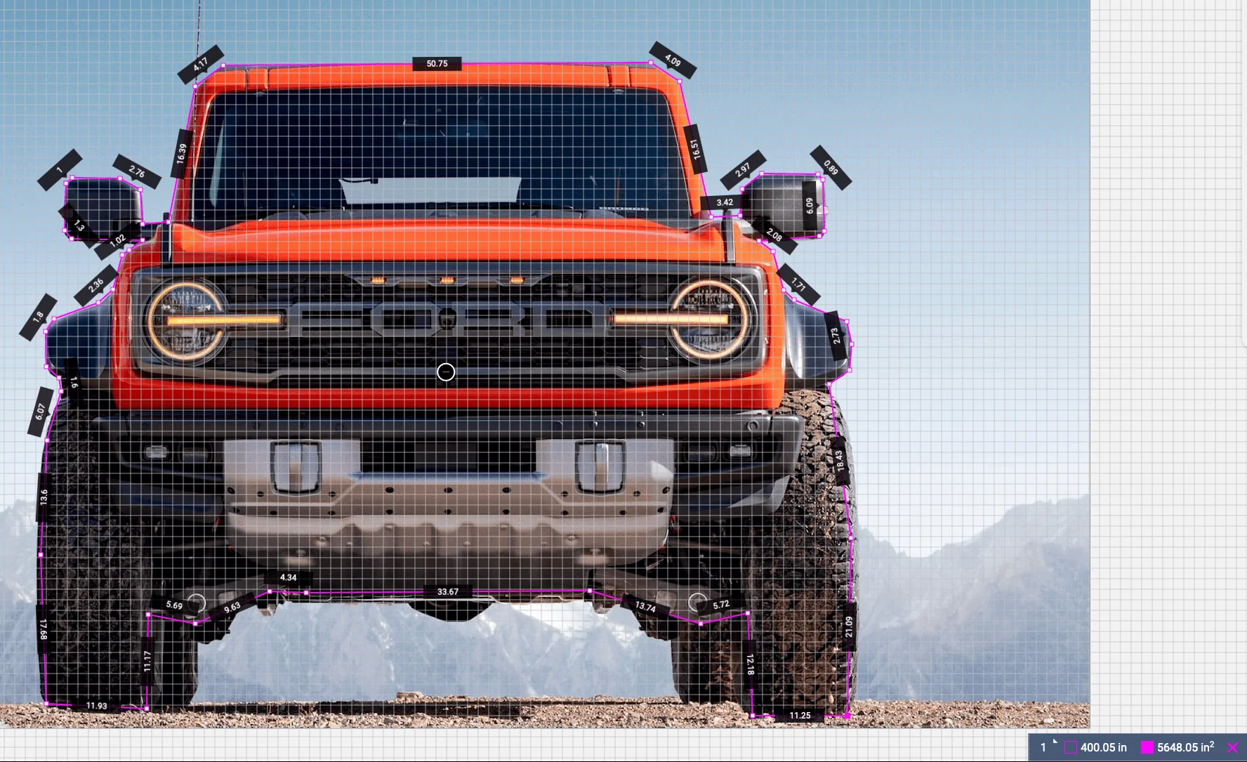

OK. Here is a much better frontal area estimate. This scaled image gives the correct 77.8" height, but I reduced the entire area shown by a factor of 0.873 since the width was off by a factor of 1.14 (too wide), based on the known front track width. This app has no independent scaling of x and y separately for an imported image...
Ford Bronco Any way to remove the speed limitations... Screenshot 2023-07-15 at 4.07.53 PM
Thus A = 34.3 ft^2 . I'd guess this is within 5%, more likely a low estimate due to perspective on mirrors and cab and that the diff should probably be included. Due to this and not even really knowing the 1's digit accurately, lets round this to:
A = 35 ft^2 +/- 2 ft^2
This also bumps my top speed calculation (delimited of course) to 129 mph.

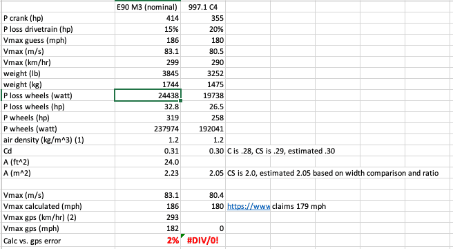

Disagree. Here are some sample calculations I did for an E90 M3 and Porsche 911. The M3 is within 2%.
Ford Bronco Any way to remove the speed limitations... Screenshot 2023-07-15 at 4.33.11 PM
This is probably a bit lucky as drivetrain losses are an estimate and tire losses a very rough calculation (emperical I'm sure).
