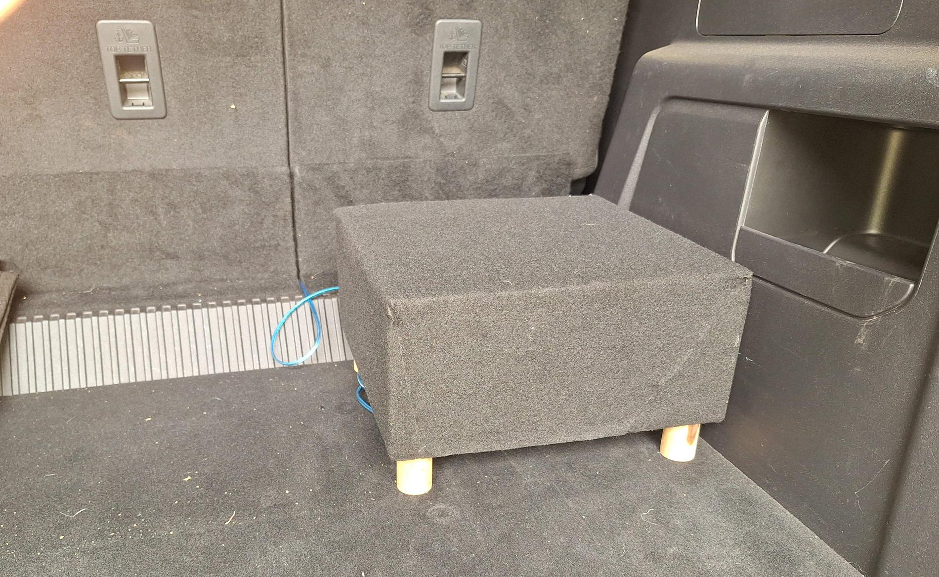

Looks good!
I'm a cheapskate and build my own. I have built several over the years. They are not hard to do at all. I also use glue, along with screws, when I assemble them so there is no chance of rattles.
3/4" MDF or 3/4" plywood minimum. Here's one for a 10" sub. It's heavy duty and will support virtually anything stacked on top of it. I'm 250lbs and sat on it before it was installed.
Used large wooden dowels for the legs.
Use the push type connectors for quick removal if needed. You can see the extra blue wire for moving it around as needed.
There is a formula for correct "cubic inches" sizing to the woofer. Lots of help on the web.

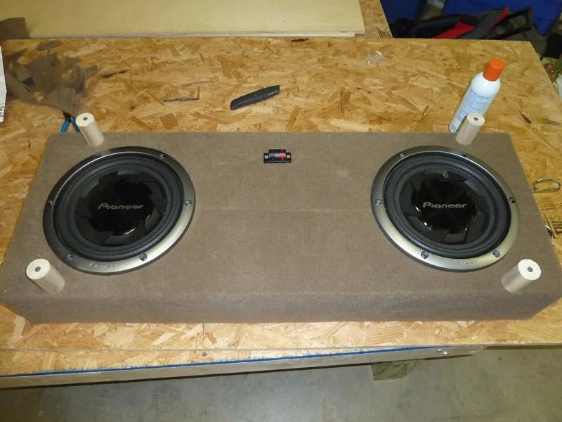

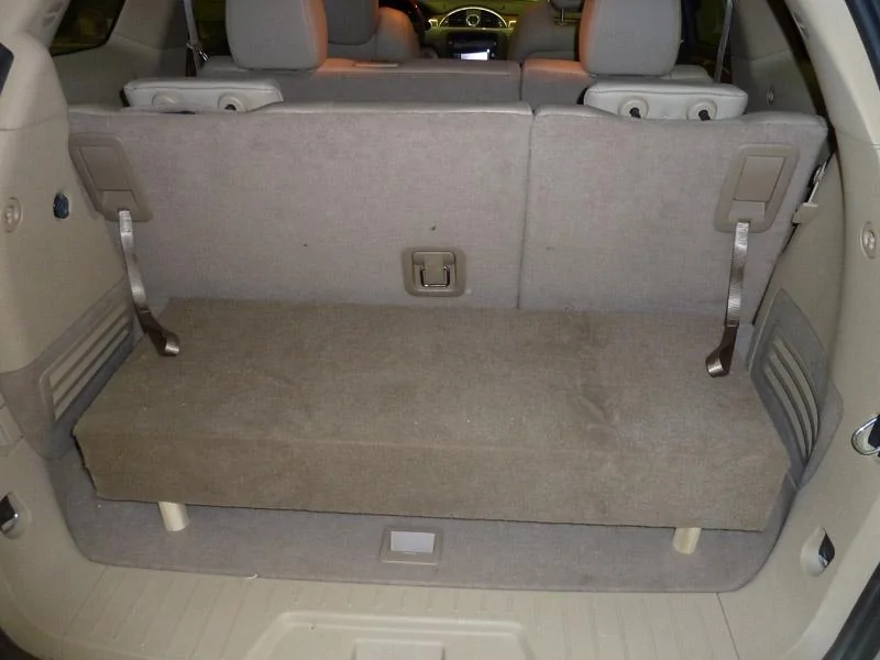

Here is another one with 2 10" subs that I built for our Buick. Sides are made from ripped 2x6s and top and bottom are made from OSB. This unit is fairly heavy.

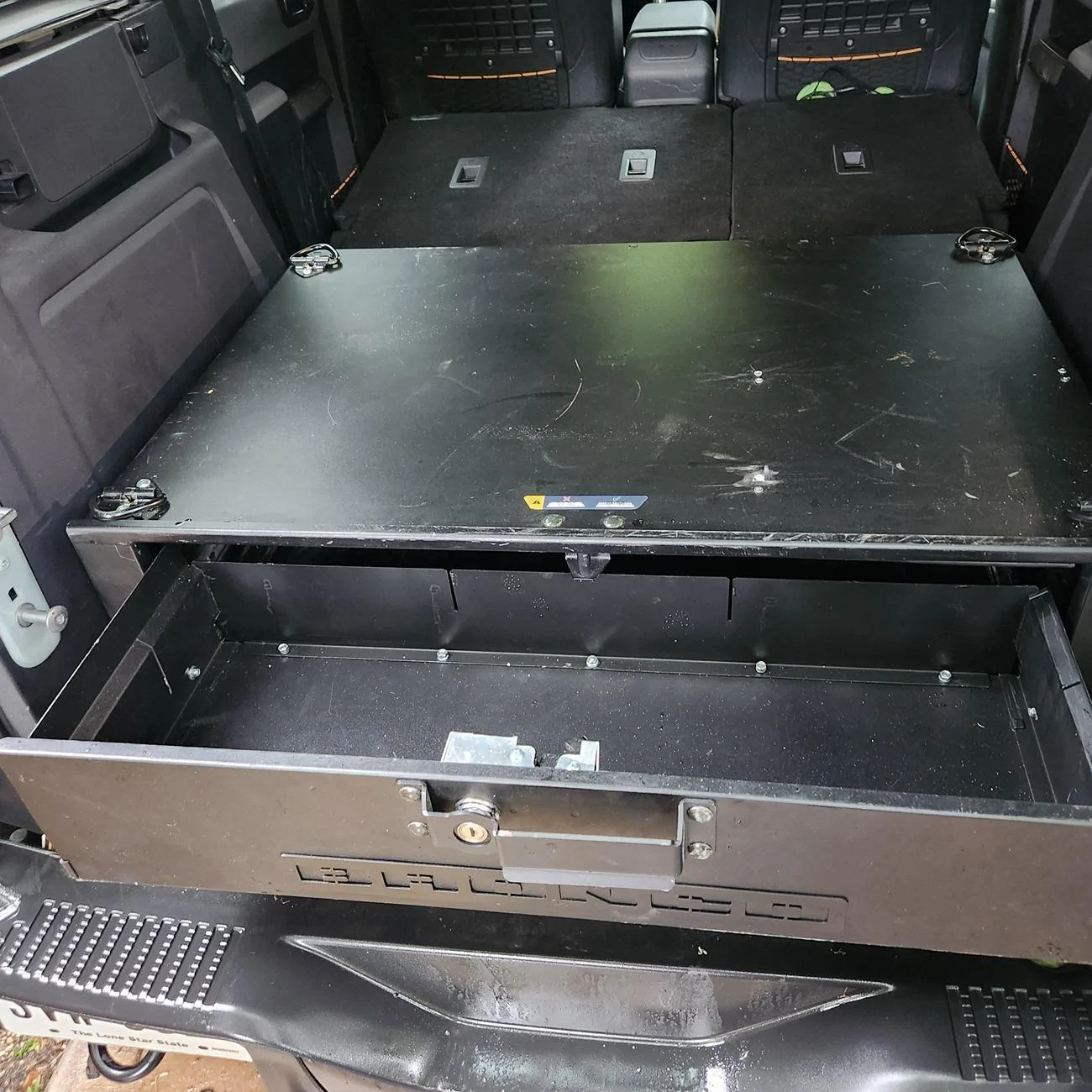

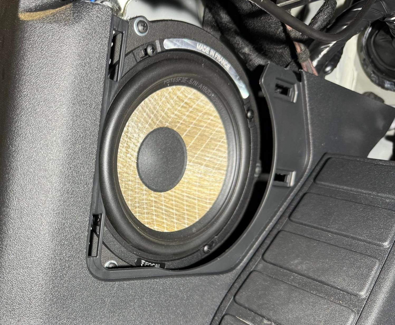

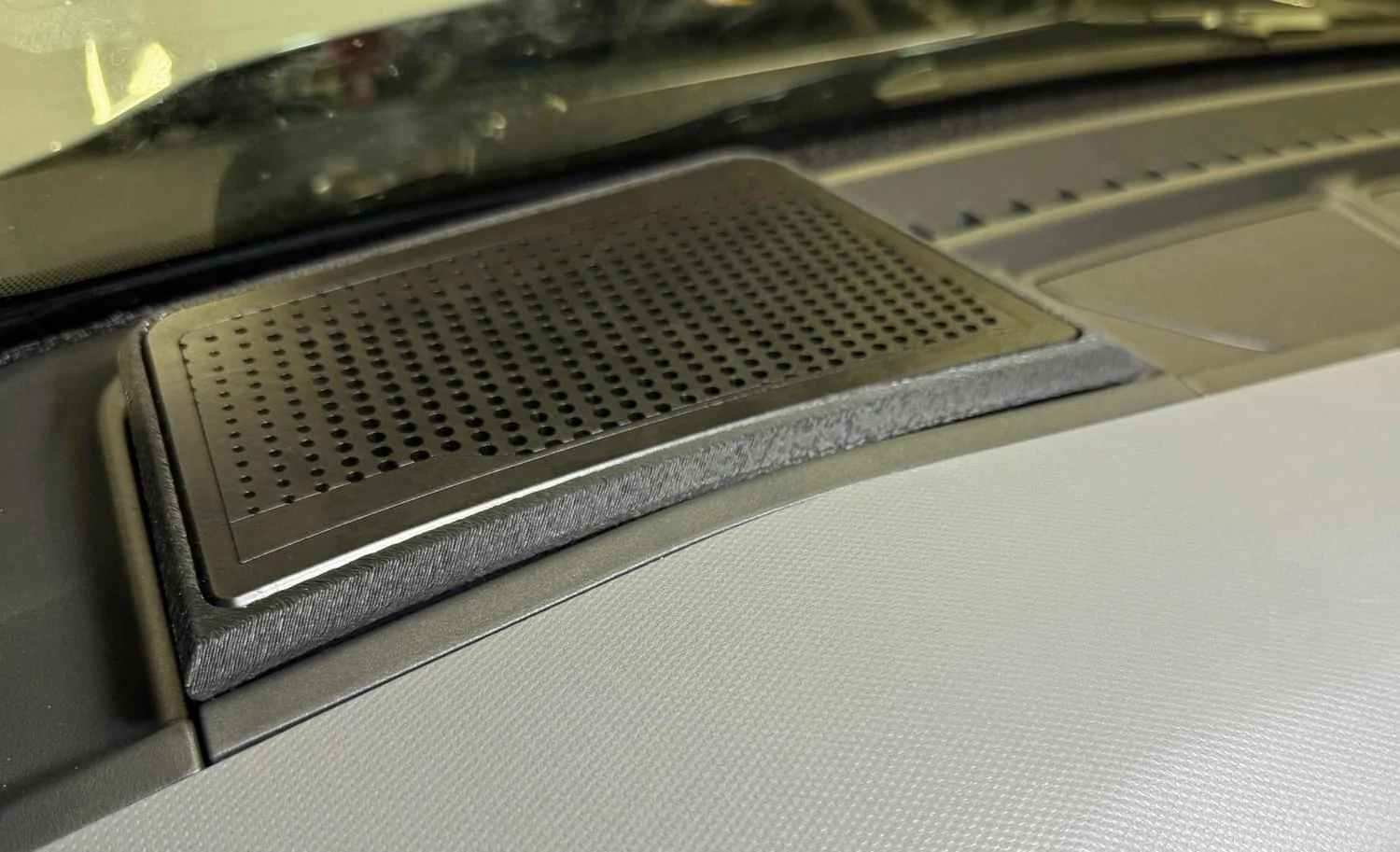

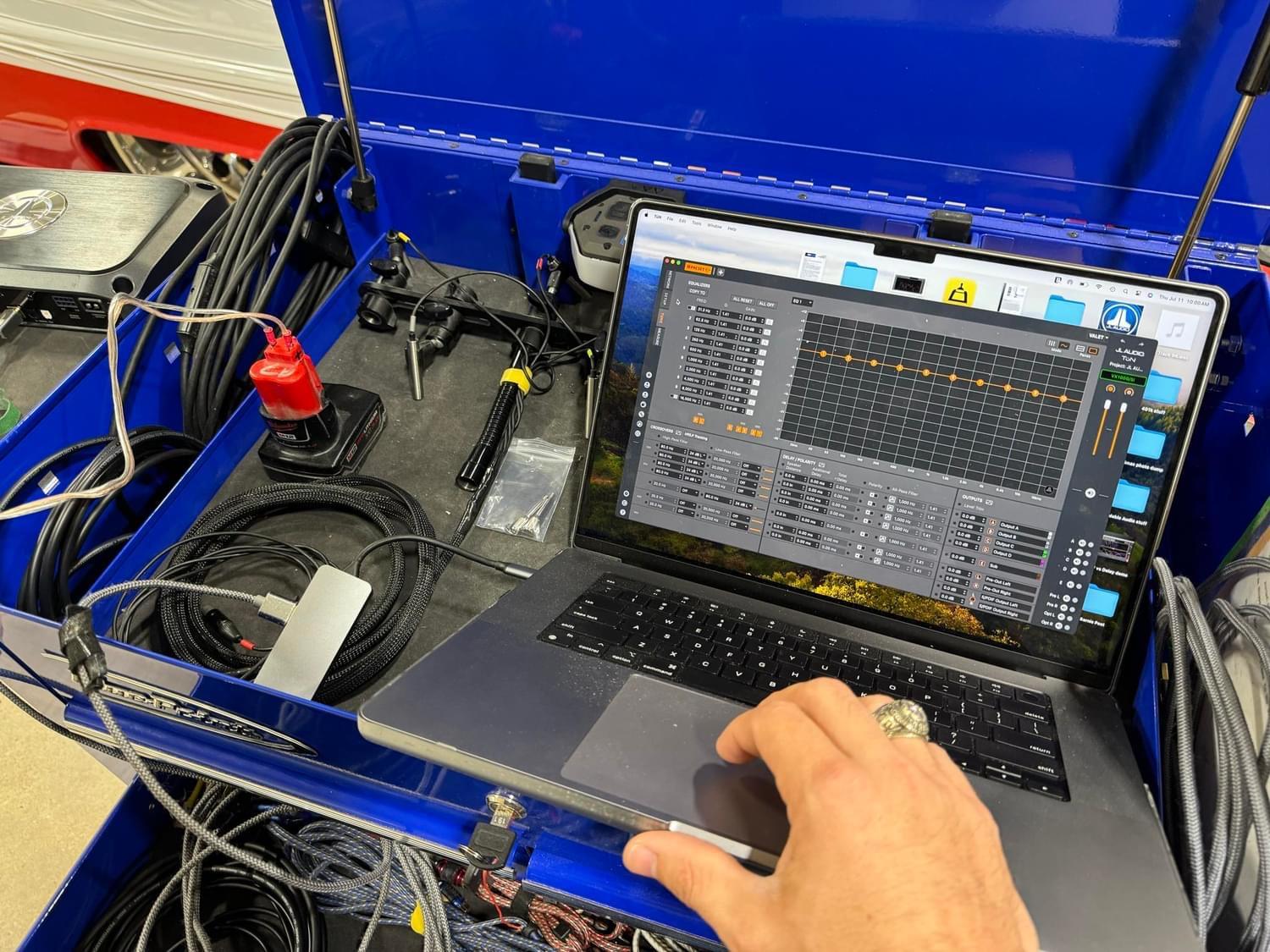

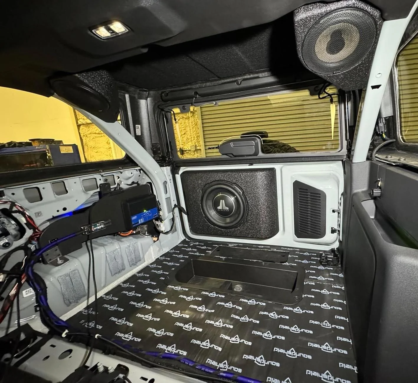

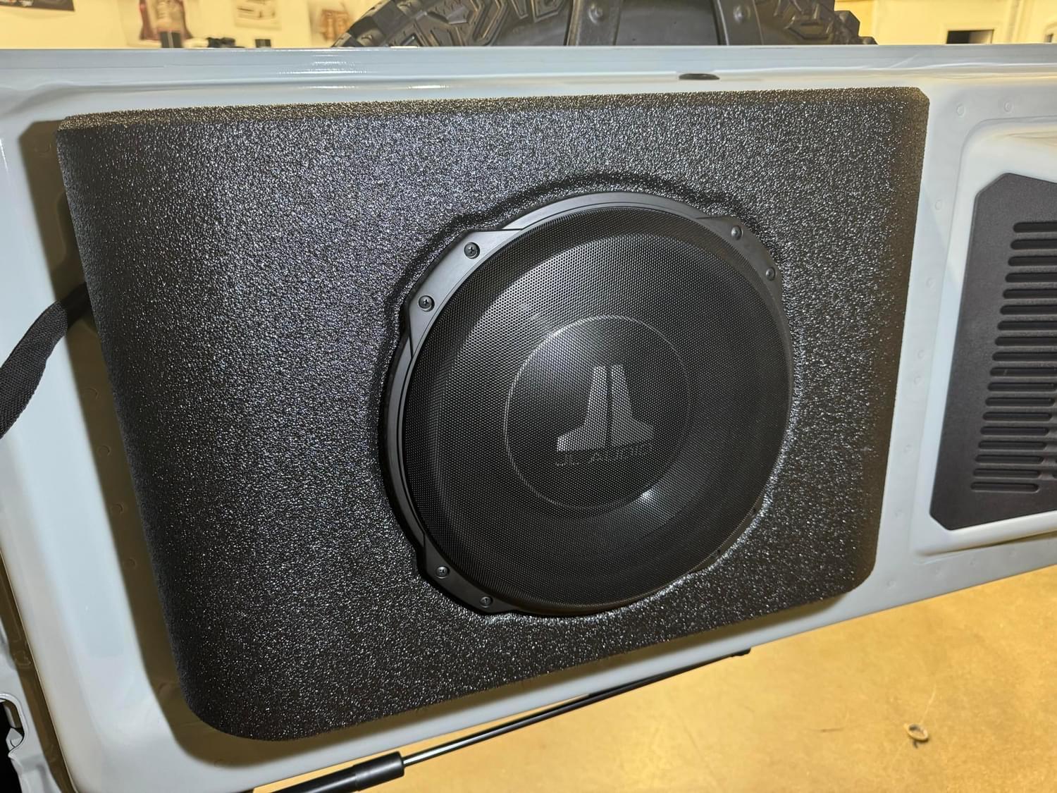

I just did a complete system from MTI and it sounds fantastic. Focal Flax 3ways in the front with the MTI dash plates. Focal Flax 6.5” in the rear using the MTI rear pod enclosures. MTI tailgate sub enclosure with a JL TW3-12. MTI stock sub enclosure amp rack with JL VXI 800/8 on the mids and highs and a JL XDM 600/1 on the sub. Jeff Hald from MTI did the JL max tune. If anyone has been wondering the MTI tailgate sub box clears the ford pull out

Jeff seems to do wonders with his tunning skills. Enjoy your build!

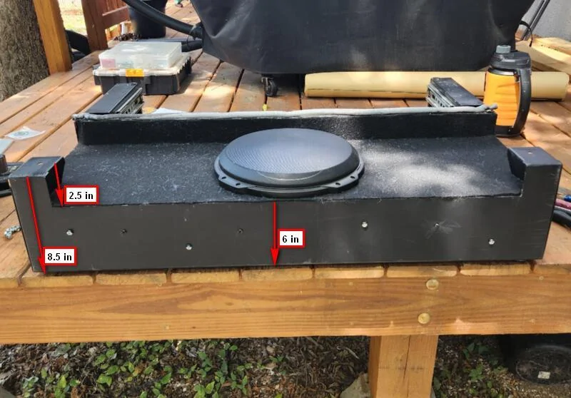

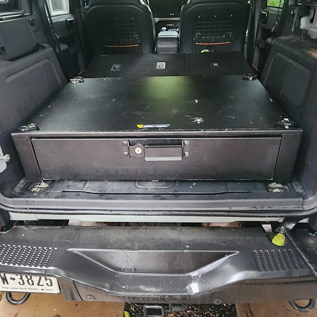

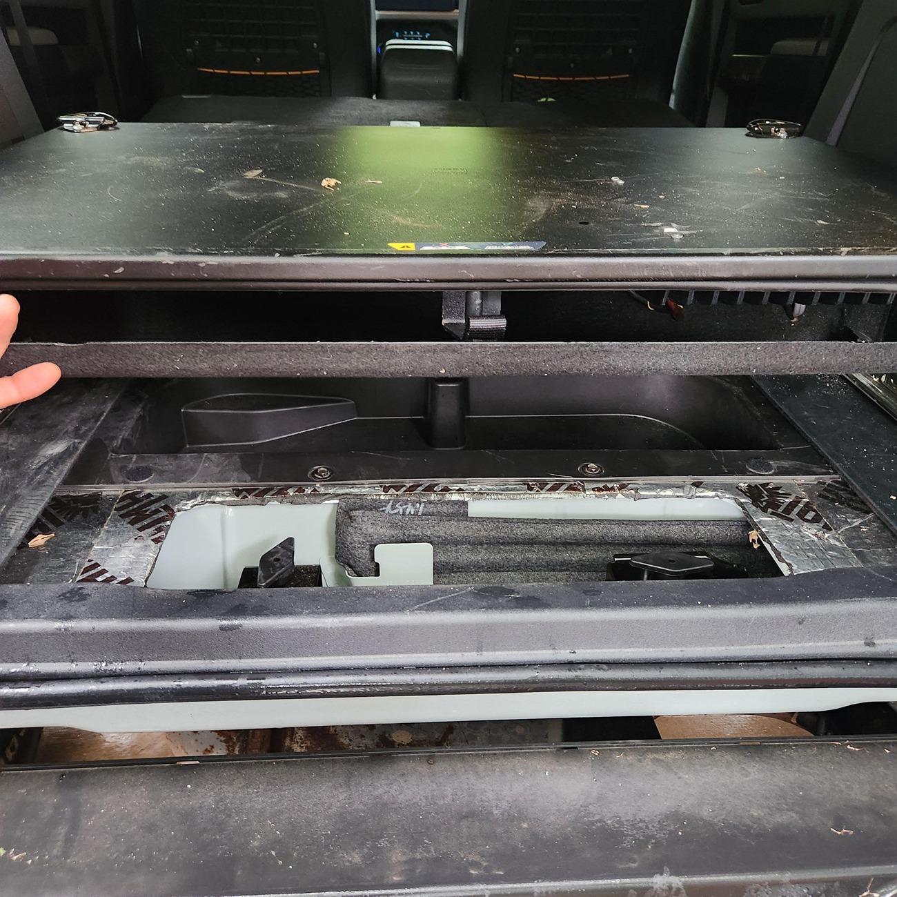

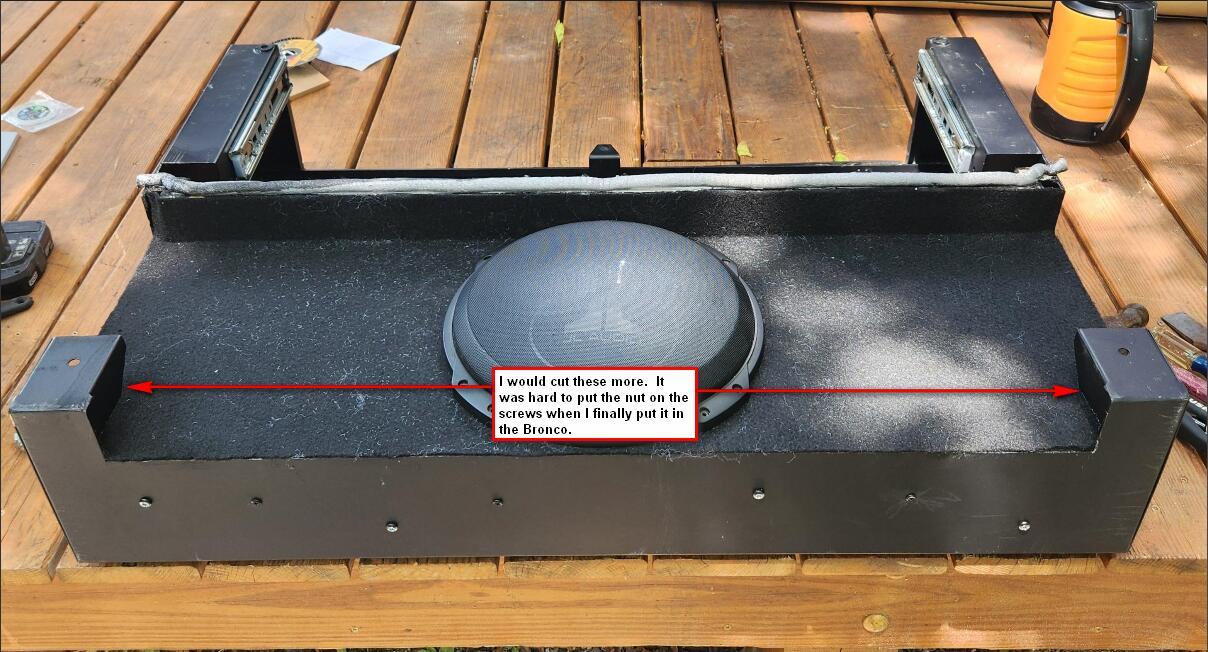

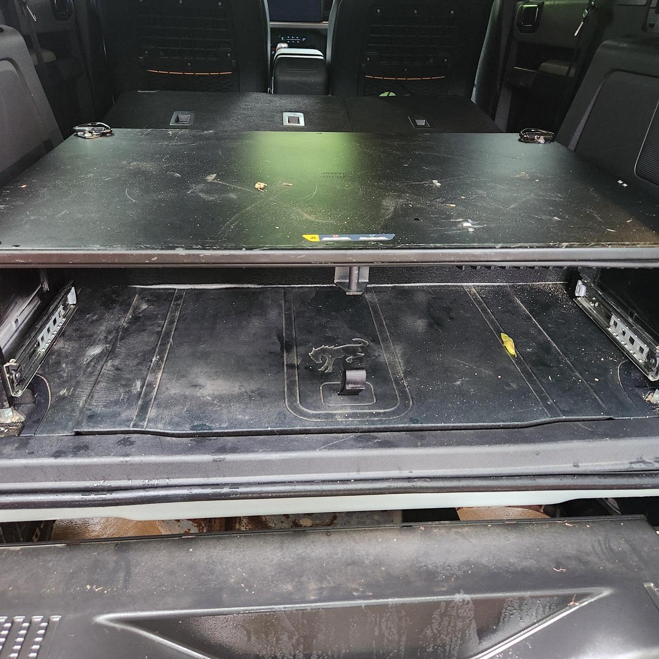

Reading through this, I was thinking the same thing....1/2 speaker box, 1/2 security box. Would like more details on the security enclosure you used and more pics, assuming you don't mind sharing.
Ford Bronco Removable MTI Acoustic Downfire Subwoofer Box 1
Ford Bronco Removable MTI Acoustic Downfire Subwoofer Box 2
The outer dimensions of the box are 14X39X6 and I used 3/4 inch particle board.
