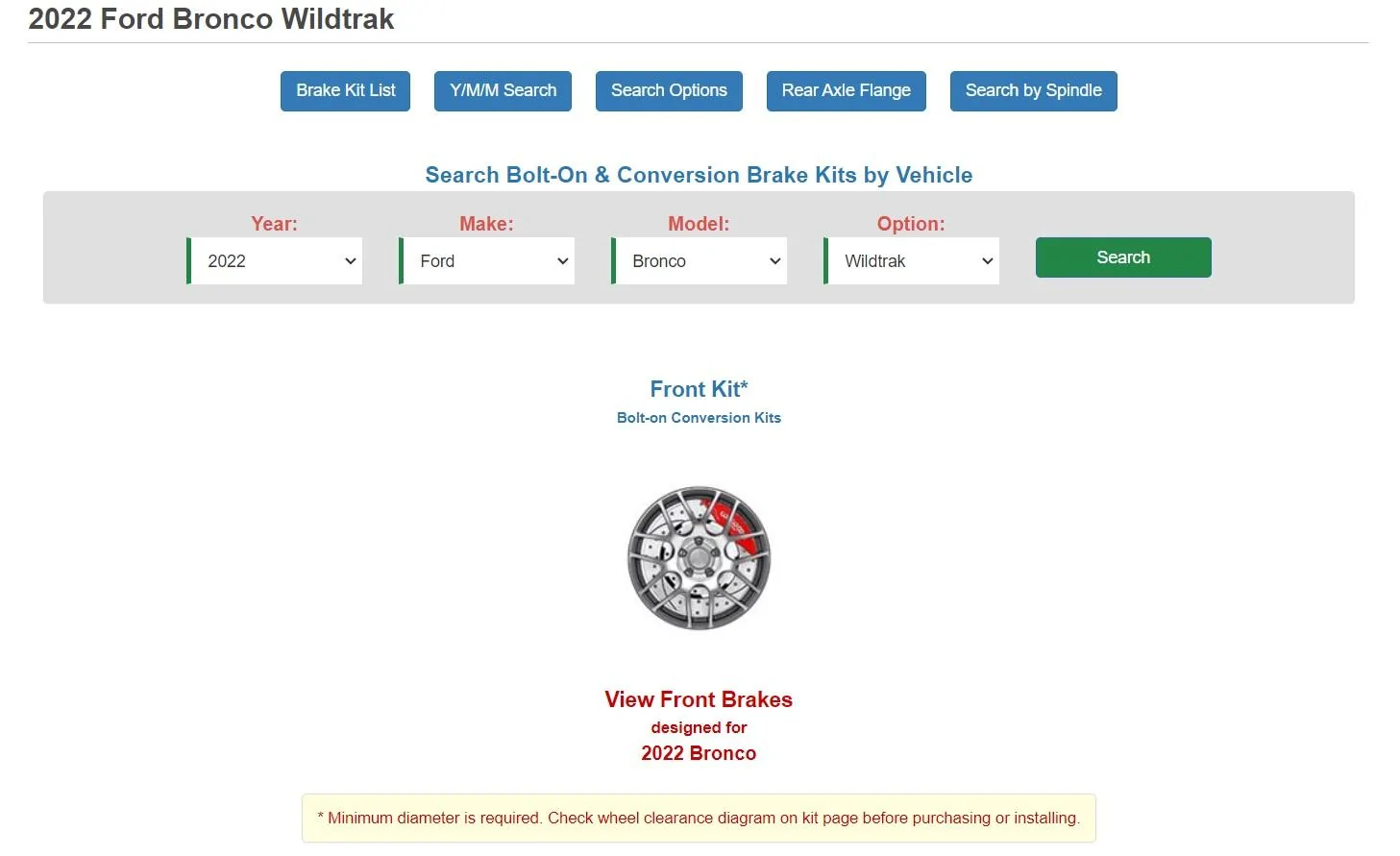

In any event a true upgrade to the best will set you back $3000 but for how much increase in performance? $700 or so at buybrakes dotcom gets cross drilled ND slotted rotors with maybe 10-15% improvement depending on how you read their own ratings

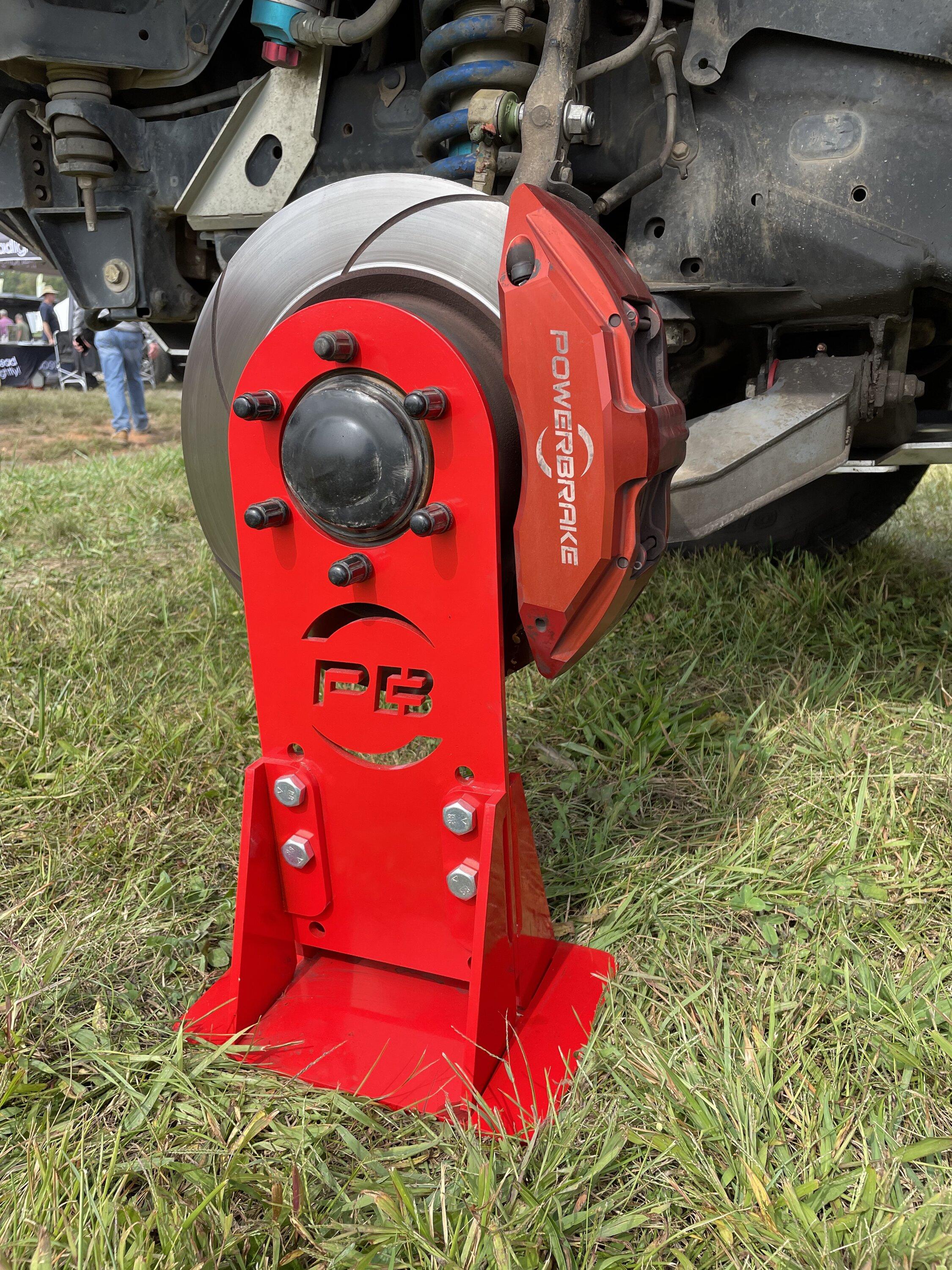

Powerbrake (not to be confused with Powerstop) from South Africa. Their brakes are designed / used for professional racing. They’ve entered the U.S. market and have been showcasing their X1 Stage 1 big brake kit for the Bronco at Overland Expo for the past two years. Currently sold thru Main Line Overland.
From their literature:
‘Powerbake
Ford Bronco Reasonable brake upgrade IMG_4383
X-Line 4x4 big brake kits are engineered from the ground up to be the ultimate brake upgrades available on the world market for 4x4 vehicles. They deliver significantly improved brake performance, reduce brake fade and vastly improve pedal feel and modulation. The performance gains achieved when fitting our big brake kits vastly outweigh the benefits that can be achieved by fitting upgraded, standard diameter discs and pads. Our civilian X-Line 4x4 big brake kits feature direct technology transfer from our R-Line off-road race brake systems that have been used by works race teams to win multiple FIA Cross Country World Championships as well the infamous Dakar Rally (which is regarded by many to be the most grueling motorsport event on earth).

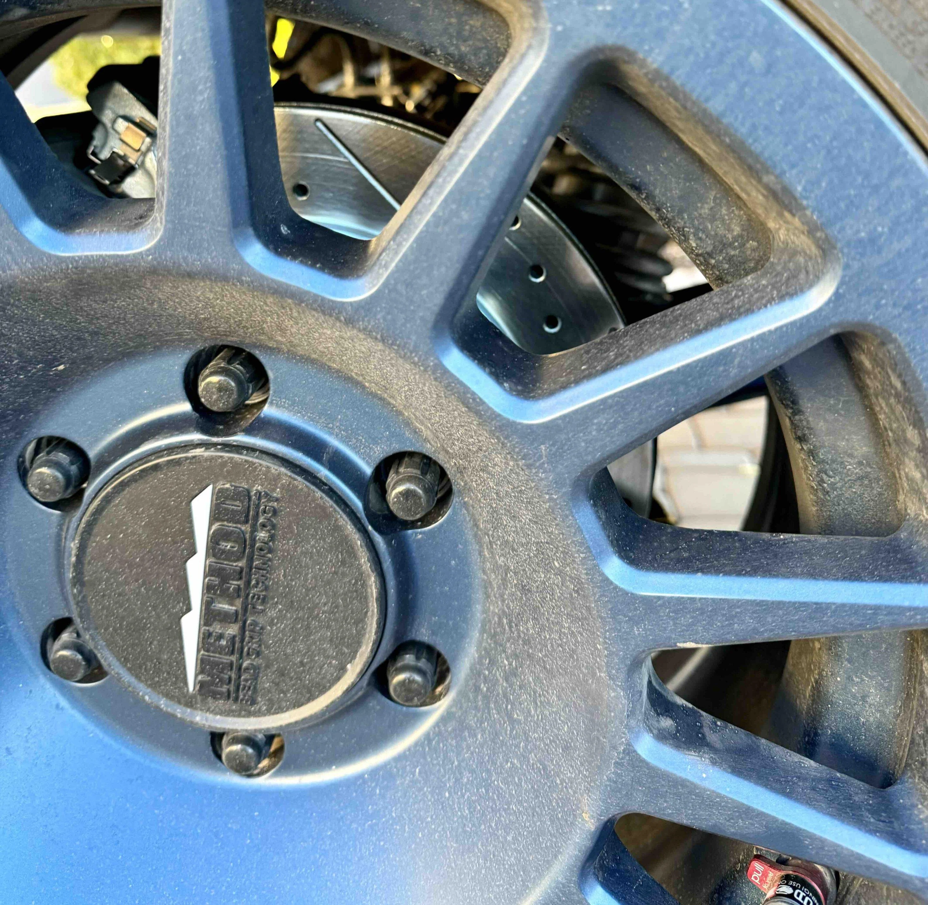

Is there a reasonably priced brake upgrade for the Bronco OEM brakes? They seem a little undersized or weak to me.
I have the 2.7 as well and did not find any reasonable brake upgrades. I did install the PowerStop truck and tow drilled and slotted rotors with pads. After a proper break in there is a noticeable difference. I could not give you an exact percentage of improvement, but I was pleasantly surprised. I tried these on the recommendation of a Ford Tech of 20+ years who runs them on all his vehicles. With 38-inch tires, armor, and accessories, I feel these make up the difference.
