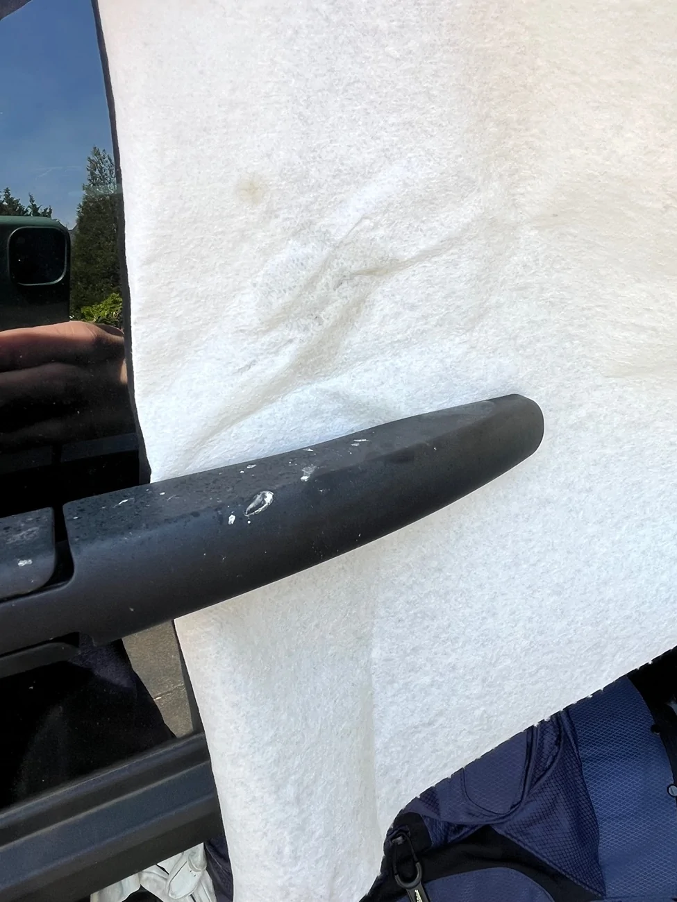

It’s off! But it took a ridiculous amount of force. Probably in the neighborhood of 75-80 pounds. Once it popped free the first time it became much easier to get the blade on and off.
Just found this thread and like you, it took a lot of force and nothing happened

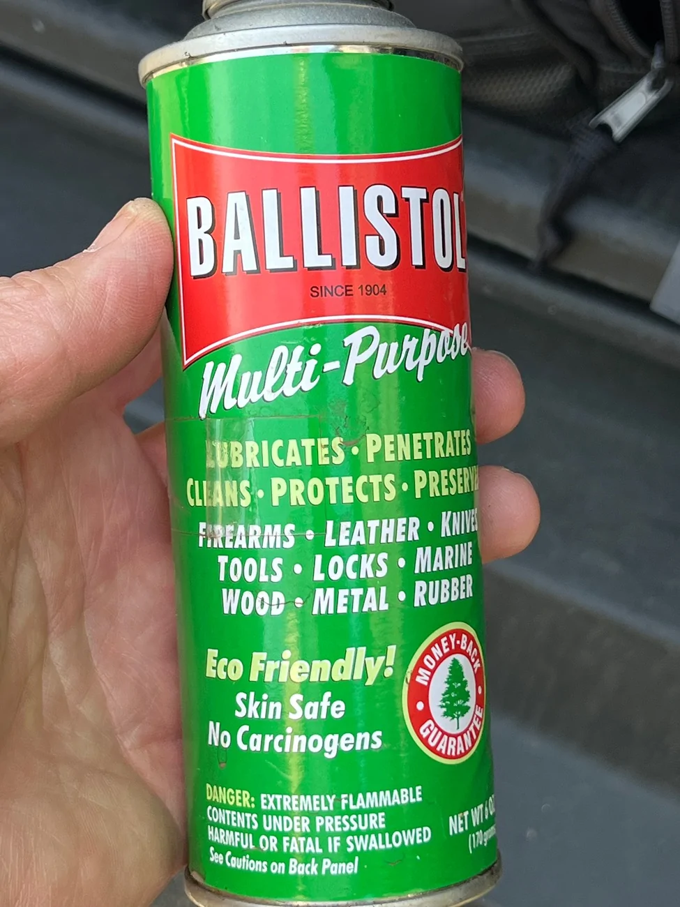

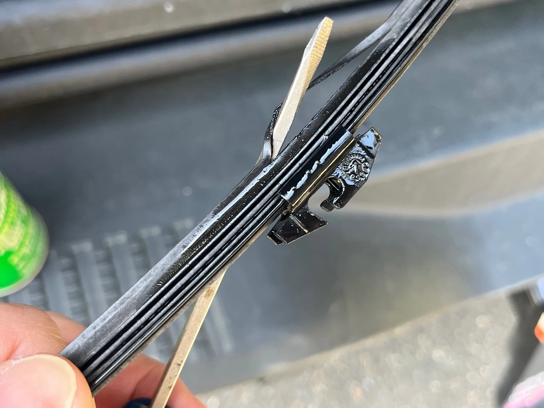

I ended up using Ballistol, which is what I used to clean my guns and sprayed it all around the attachment clip. Waited a minute or so, gave it a tug and it popped right off.
just put a garage rag behind the blade, sprayed the area liberally with Ballistol and that was it.

Like the OP, I applied a LOT of force to remove the blade according to the video but it wasn’t budging. Definitely using some sort of lubricant helped a bunch.
