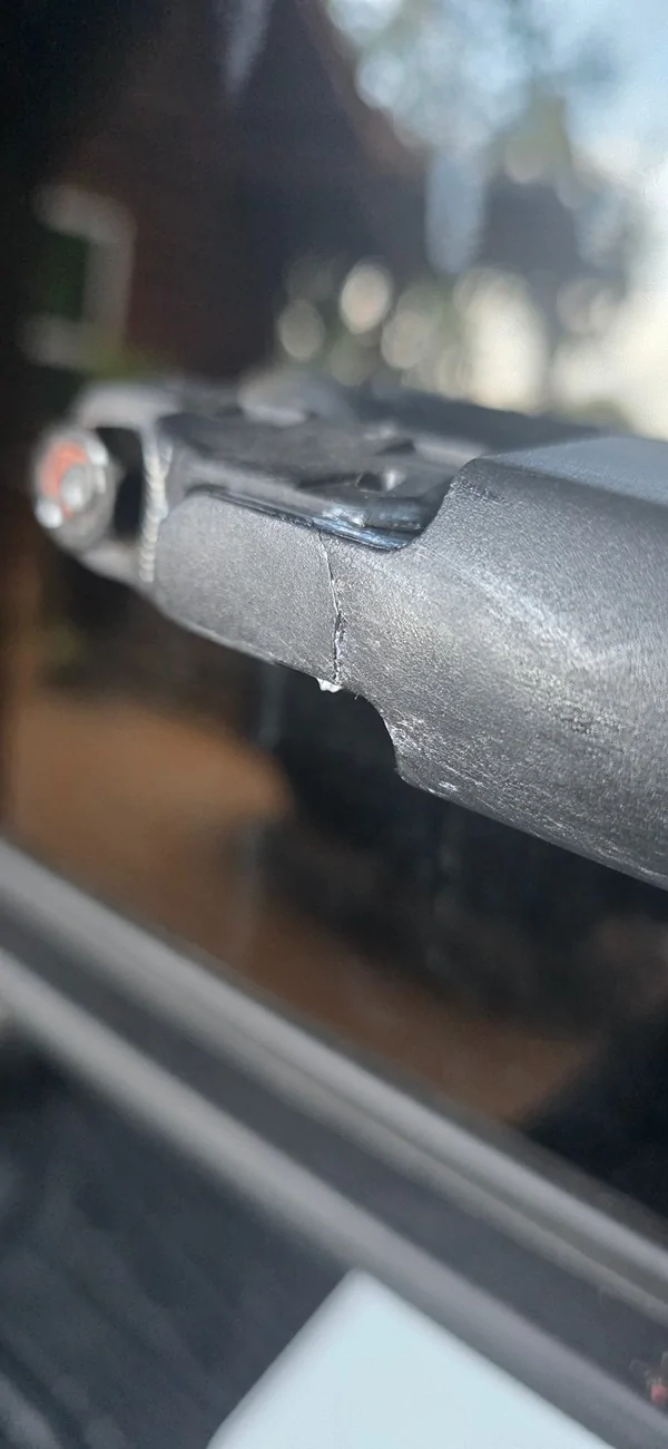

OK I know I'm going to feel stupid when somebody answers this, but how on Earth do you remove the rear wiper blade?
Mine is completely shot and has strands of rubber dangling. But I can't figure out how to remove it. I've tried pulling, pushing, twisting, sliding, looking for release tabs, and pretty much everything. I even watched a couple of youtube videos but nothing seems to help. It's like the darn thing is welded on there! This is embarrassing. I'm at the point where I actually spent a few minutes thinking it might be easier to replace the entire arm just to get a new blade on it. What do I do???
Don't pull on it like my Ford dealer did and then try and superglue it back together.
