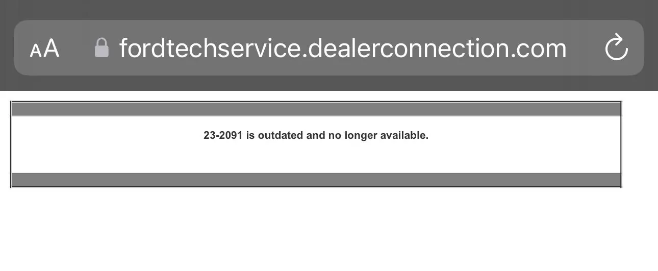

I recently snapped the plastic tabs off the rear window that keep the fabric connected to the frame. I found a service bulletin for it
23-2091
https://static.nhtsa.gov/odi/tsbs/2023/MC-10233597-0001.pdf
Briarwood Ford in Saline Michigan says the only way to fix it is replacement of window with a cost of $750 Even after I showed them the TSB. They said the TSB does not exist and would cost $750 for the window as it’s not covered by extended warranty. should I just perform the servicing myself or take it to Bill Brown in Livonia where the truck was purchased?
Why is the bumper to bumper not just 3 years but or 36000 miles? I’ve put almost 40,000 miles on the truck in 2 years, how does milage affect the soft top? Seems it should be covered for 3 years regardless of milage.
Anyway, anyone affiliated with ford have info on this TSB and are the dealerships avoiding TSB repairs to sell parts?

My window was covered under this TSB. Had it fixed in 22 by my dealer in Florida. Maybe call a few dealers, or it could be the TSB doesn't exist anymore? Don't know, but just thought I'd let you know my experience. Good luck!
Ducati1098
10,056
23,429
Midwest

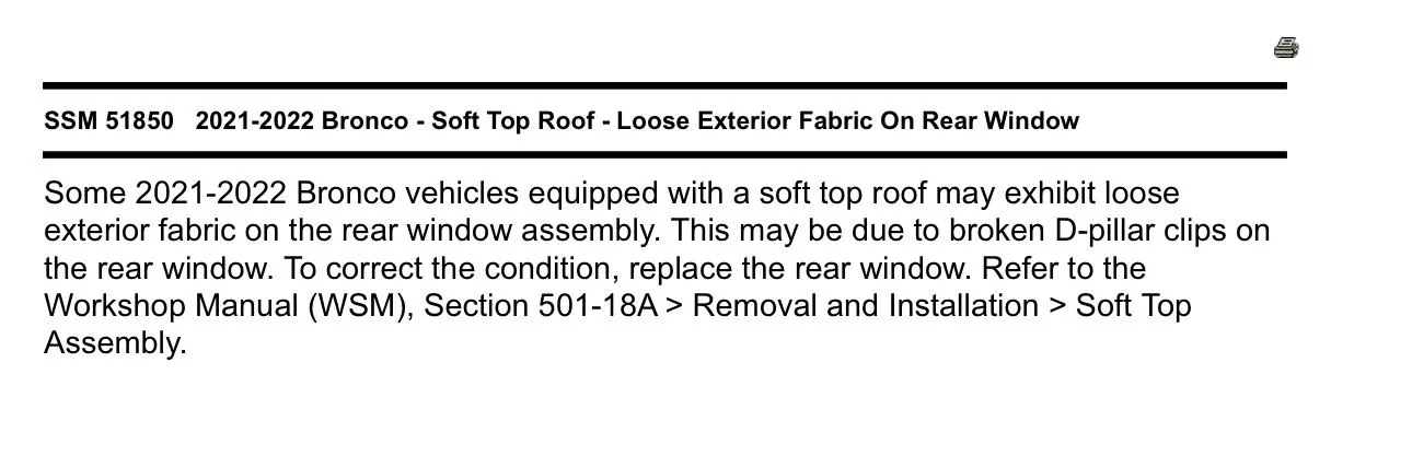

Ford did remove the TSB and they have replaced it with an SSM it looks like. Replacing the whole rear window is now the recommended repair. But either way, if you’re out of 3/36 then it likely won’t be covered.

The window was not being taken out of the tabs. The bottom tabs broke while popping the bottom of the window out of the latch mechanism. If you push from the fabric like I did and not be delicate from the inside they just snap like crispy bacon, terrible design
