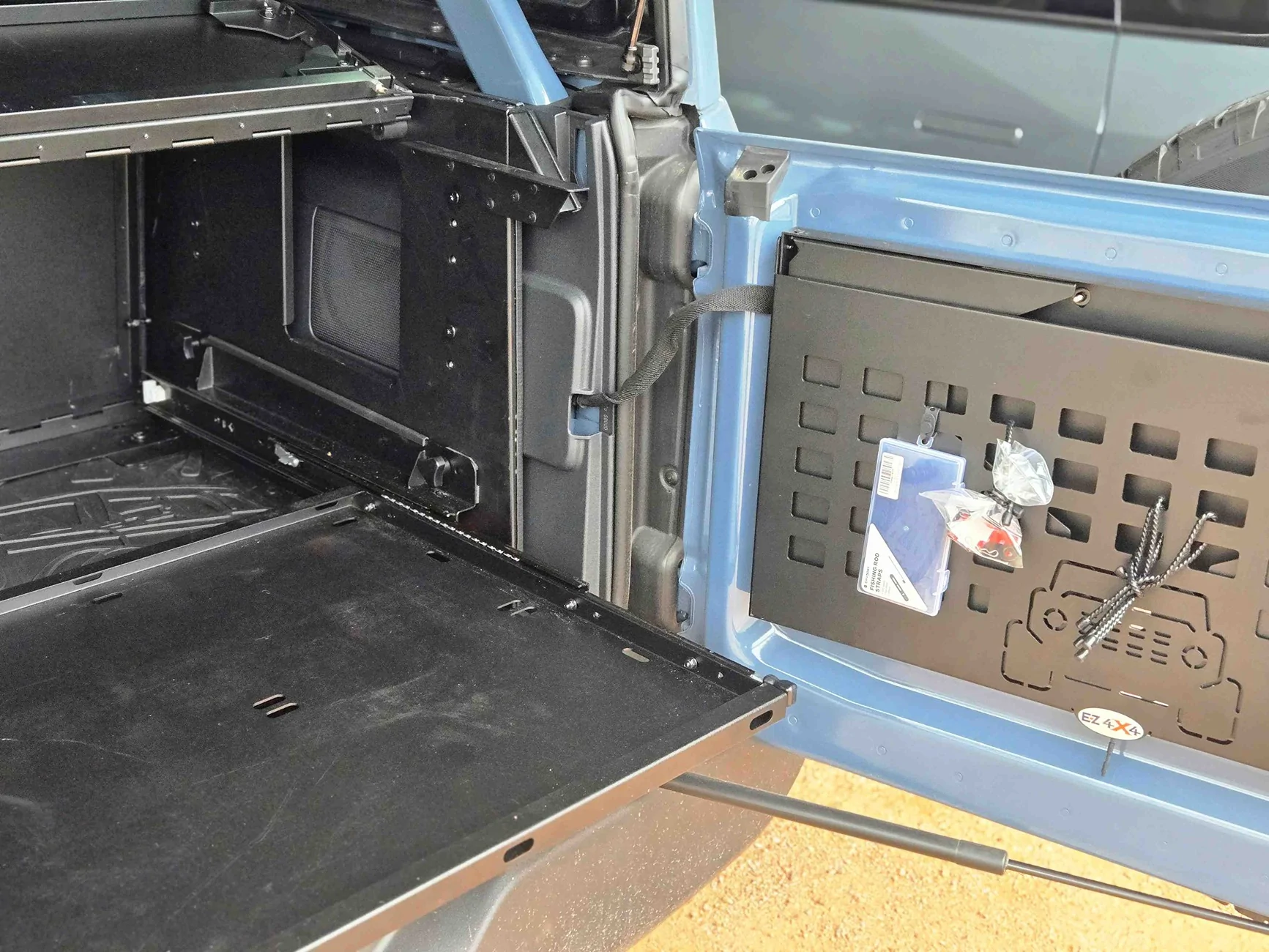

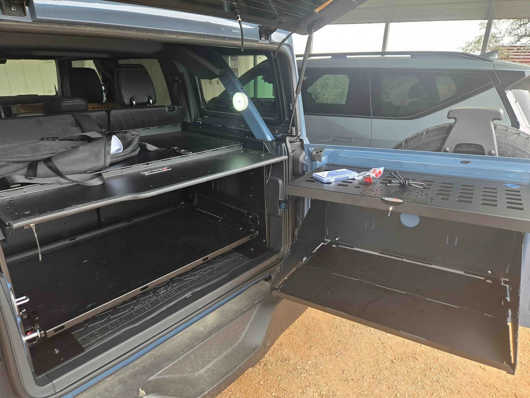

I did get the ez4x4 slide out and molle fold down hatch table. Both work well, closes without hitting and you can adjust the height of the slide out. I had hoped you could fold down the whole enclosure and then put the slide out on top of it (giving you full height of cargo area). But they didn't have proper holes to make that work. Might could drill/tap it yourself though. Overall happy- haven't loaded heavy but works and slides well.

To be clear, the slide out tray does fit on bottom. You just couldn't fold down the enclosure and then have the slide out right on top of it. Since we don't always have top off then that would be a great "daily driver" alternative. AS of now you have to remove the slide out and fold the enclosure down and then the slide out is either tall or unattached.
