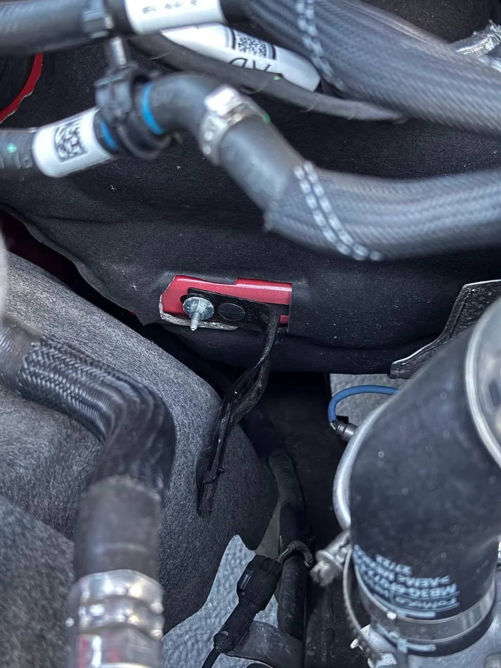

Rattle coming from the passenger side dash.

Ford Bronco Rattle coming from the passenger side dash. 1784598376840-e0
Bringing some old threads to light in case I can help someone. I was chasing a passenger side dash rattle for months. Ended up being this "L" bracket on the passenger side inside the engine bay. It was loose.
