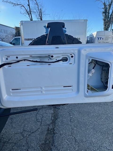

hi everyone,
i have the same problem i think. its rattle and plastic rubbing noise.
looked all over the place and could resolve the issue.
i decided to try and take my plastic covers off the tailgate that covers my wires and latch.
almost all the noise was gone. i still hear a very little squeaking sound but it helped a lot. im going to try and put fabric like pcs on the metal clips.
hope this helps
