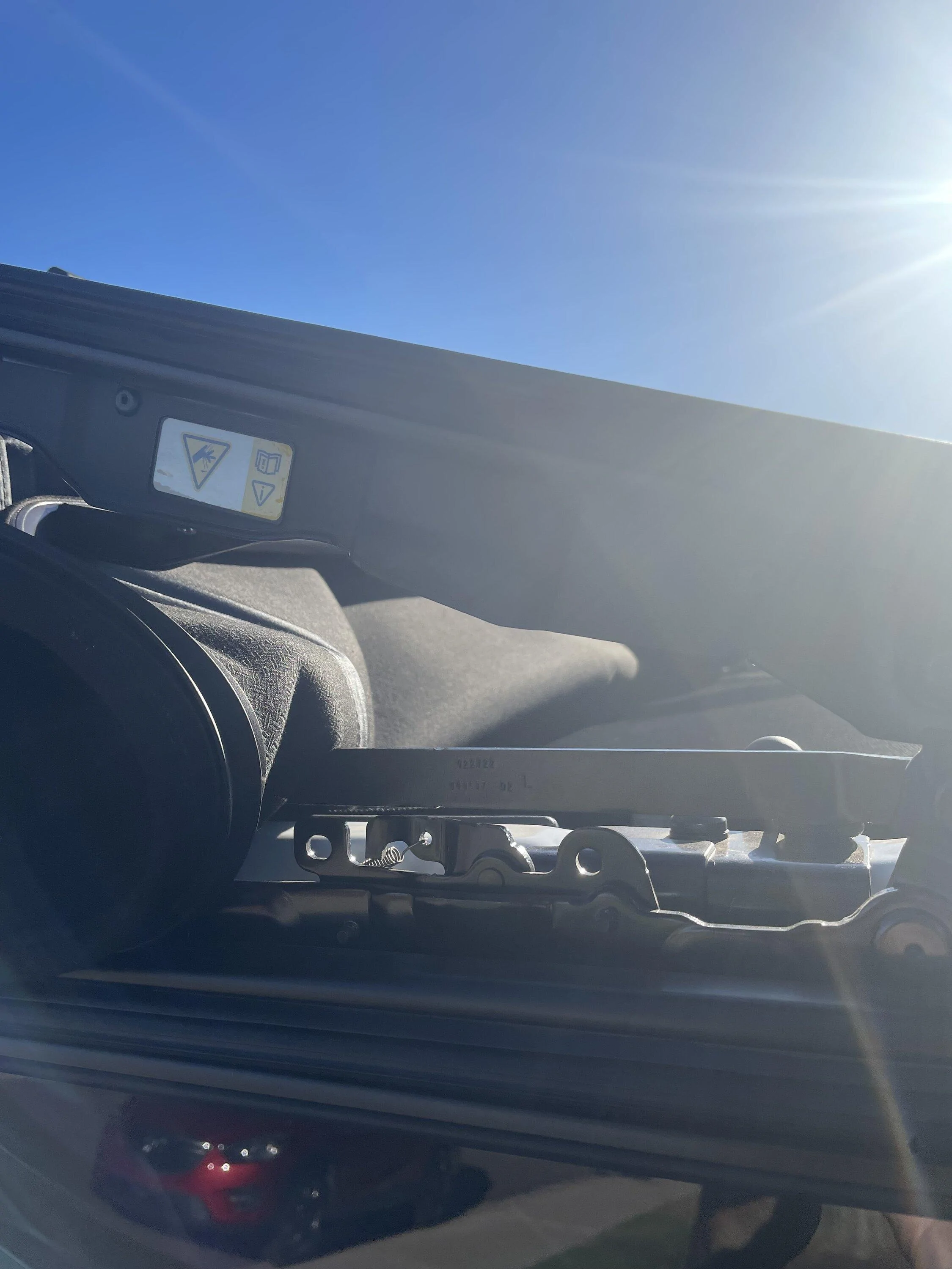

Not the greatest pic thanks to the sun, but I’m referring to the middle latch on the passenger side.
Looking again this morning, the spring is what actually holds it closed an latched. The cable seems too tight and that’s what is pulling it open on its own.
