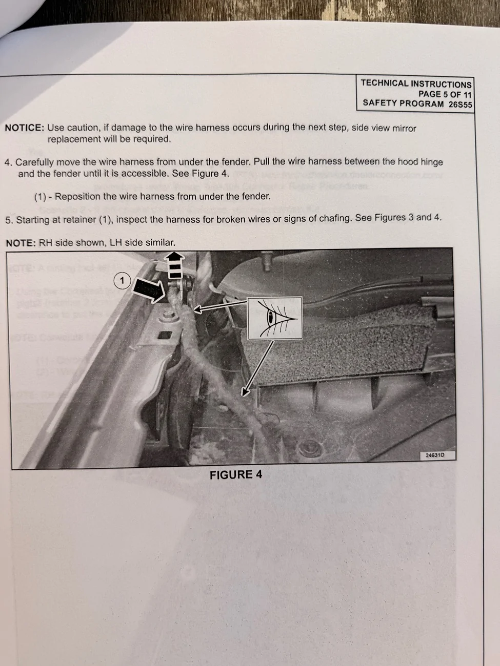

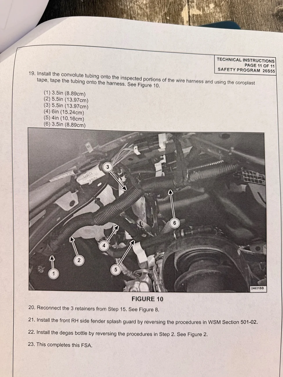

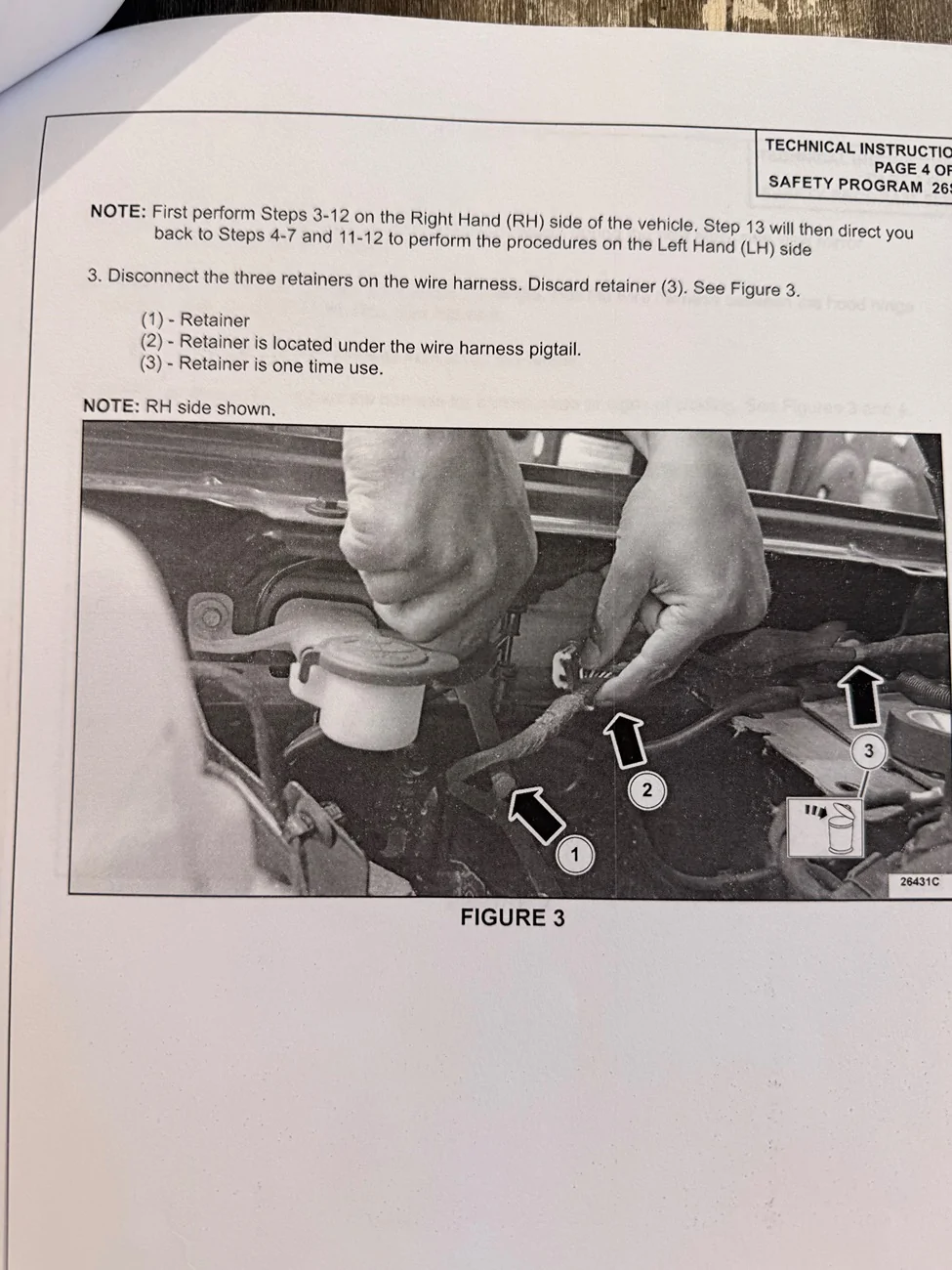

Had my Raptor in this morning for a right front wheel flare attachment pin replacement and they told me the repair is out for the wire harness recall and printed it for me. It checks an upper small wire harness on LH and RH side that runs along the front fenders and a larger harness on the RH side that runs behind the fender liner. Inspect and add colorplast tape and convolute tubing, zip ties. More involved if damage found.

They will order the supplies and then complete the repair in a week or so.

Thanks for this. Having a little trouble figuring out the first picture: It's take inside fenderwell with inner fender liner removed? Passenger side? Sheathing the harness behind the washer bottle? It looks like the wire by the hood hinge on both sides is also involved, but that is all on the drivers side, correct?
See this post's attachments on the main thread dealing with this recall. The diagrams in the pdf attachments are color coded so it is easier to see.

Yes the top bundles run from hinge forward along inside fender down to wheel well. Both driver and passenger are inspected and taped. Just the passenger wheel liner gets pulled and that bigger harness gets inspected, taped, and corrugated.
