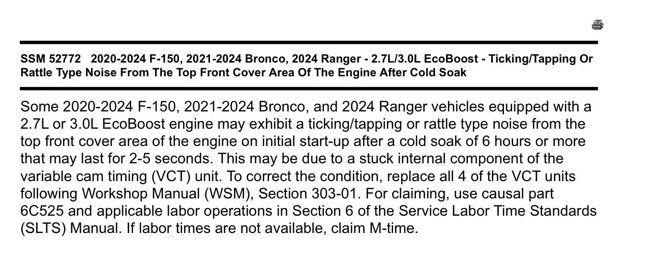

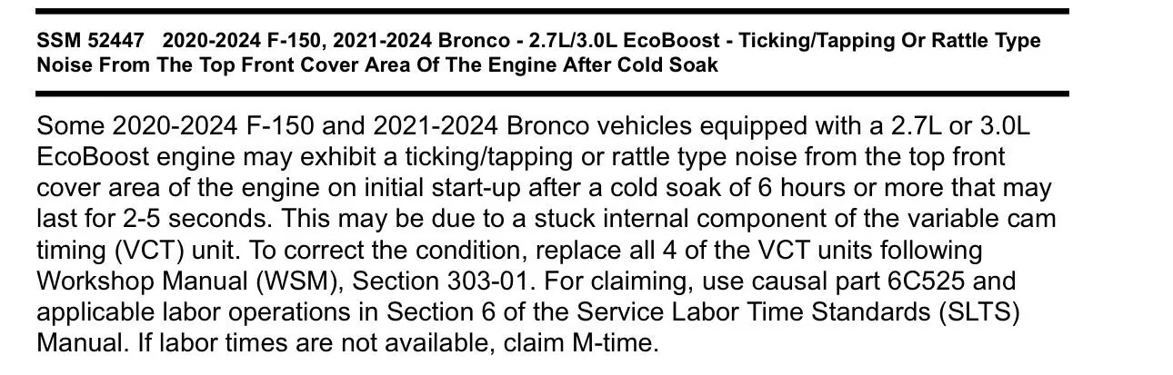

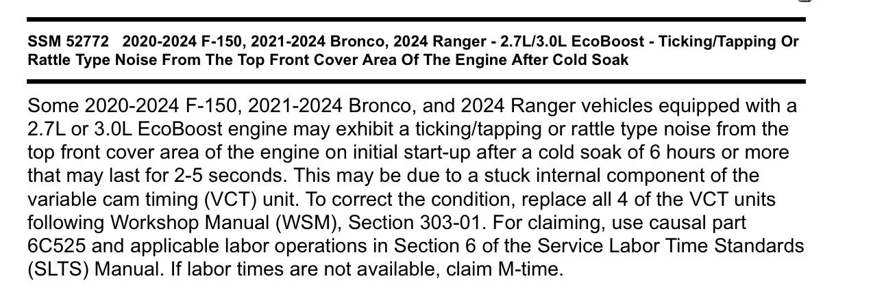

Your dealership is lying.
Ask them why there’s an SSM for the concern if its “normal”
Bring it to a different dealership, that isn’t a bunch of idiots.
It is worth saying, this noise only happens for 2-5 seconds on start up. If you’re hearing something else randomly while driving it, then it’s not the same issue as the original post.

Thank you for info, Yes I hear the knocking sound randomly while driving it. Not sure what is causing it so I will need to due further research. I know it's definitely not a normal sound from an engine. I'll pick the Bronco up today from the dealer and go from there.
