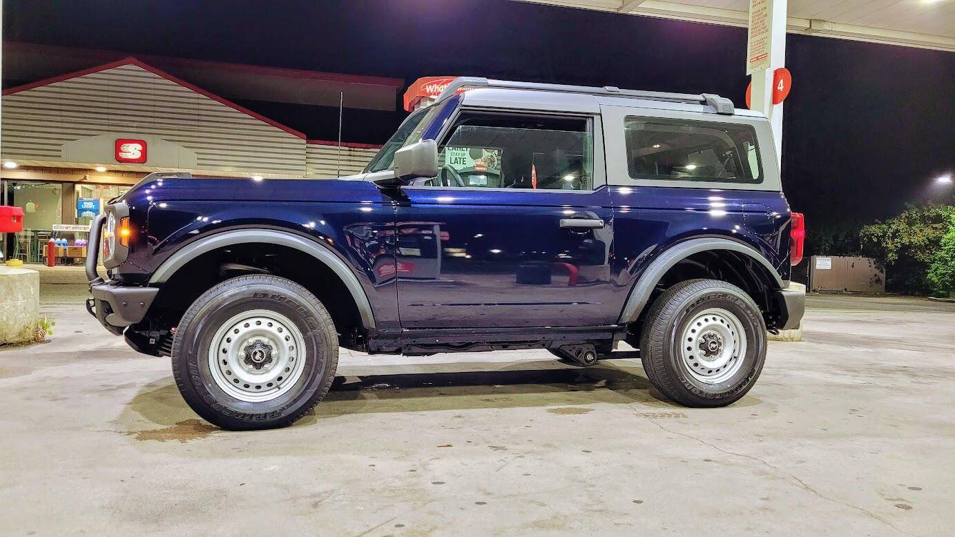

I think they'll fit just right...
Ford Bronco Ranger rims on a Bronco? 20231214_142704

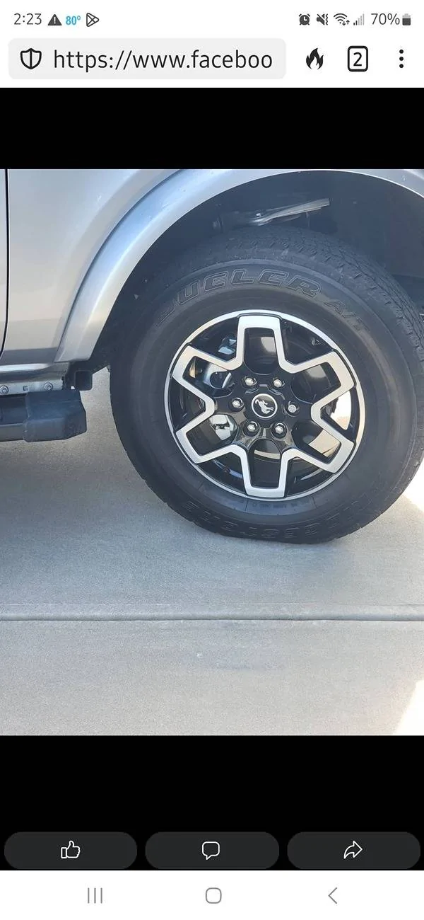

Ford Bronco Ranger rims on a Bronco? 1726328740894-9m

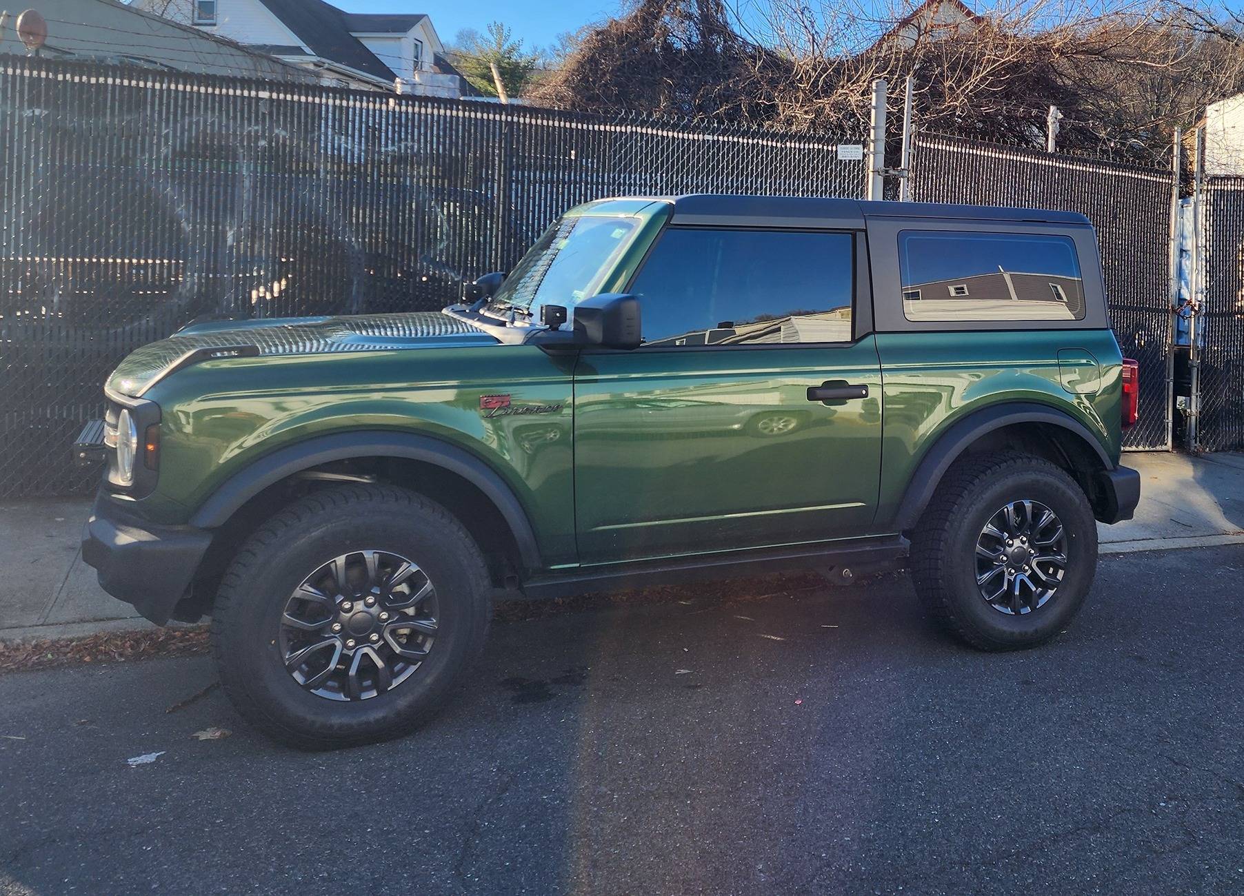

Ford Bronco Ranger rims on a Bronco? 1000001437
I'd probably get severe snow rated all seasons in my area. We get too many random warm days in the middle of winter. I hate winter tires in warm weather.
I've got a set of 5 wheels and tires here in South Carolina. 19k on 4 of them. One is like new. No flaws on the rims, if anyone is interested.
