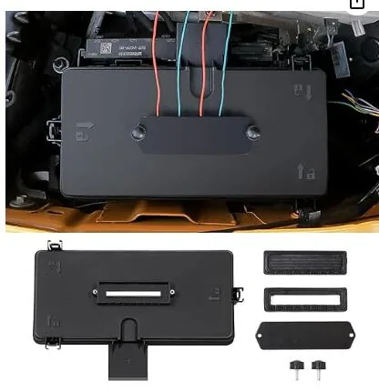

You may want to get one of these:
Mabett Waterproof Fuse Box Cover
Ford Bronco Quick fuse tap question 1737040453702-0t
Spawn2031
Sep 19, 2024
Central Wisconsin
2024 Bronco Big Bend
Yeah I was highly considering that since many people reported not having enough space to get the fuse tap wire out without notching the fuse box lid. But then I've seen many various install vids were people don't have issues, so I'm gonna see what I can do first. If nothing else, it'll make it look nicer.
