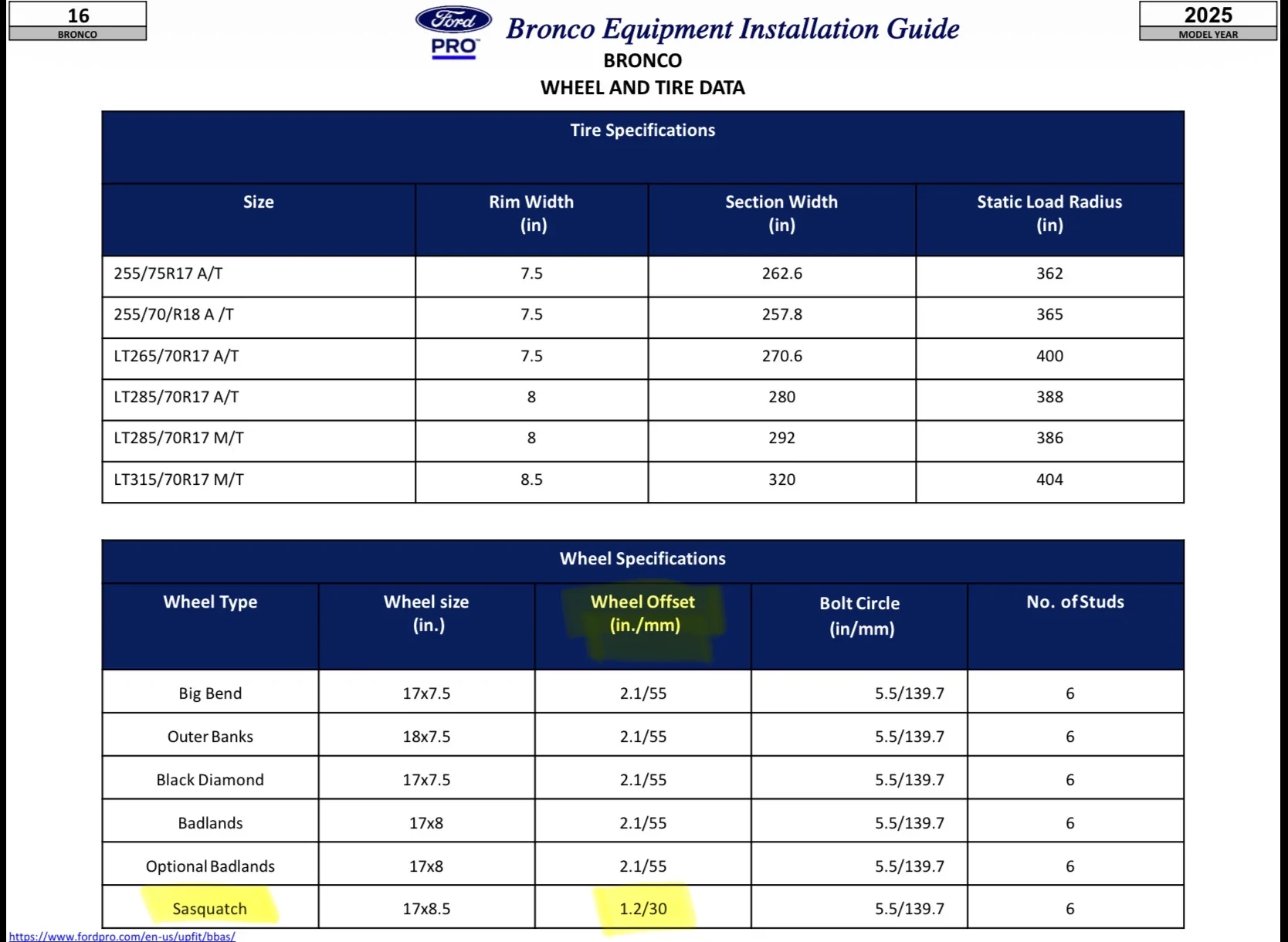

Please pardon the dumb question … I’m just starting to research my next (non-stock) set of tires and wheels for my MY25 2DR Badlands SAS. I’m very likely going to put on a heavier tire than the stock GoodYear MTs, so I’ve been researching lighter wheels. I optioned Everglades wheels when I bought the vehicle, which were a nice carbonized gray match. But I’ve learned that the Everglades wheel is particularly heavy at 36 lbs. It also has an offset of +30. (Please confirm or correct me if these numbers are not correct). Here’s my question(s):
Isn’t it true that the stock SAS wheels are a zero offset? Does that mean FORD installed spacers on my vehicle with the EG wheels because of the +30 offset? Does that mean I could buy new wheels that are ET0, or do I have to look for a new wheel that is close to +30 to maintain the zero tuck/poke I have now? Thanks in advance, knowledgeable folks — this got confusing fast!

All SAS wheels are the same offset of 30.
You can run the wheels you have now with any size tire that fits that size wheel.
I run 37x12.5 on my Everglades wheels, it has plenty of power still. (Other mods are needed to off-road this tire size)
What size tire are you going with and what are your use expectations?
This will determine if you should keep the wheels or if an offset change is needed.
If your staying in the factory tire size, keep the wheels if you like them.

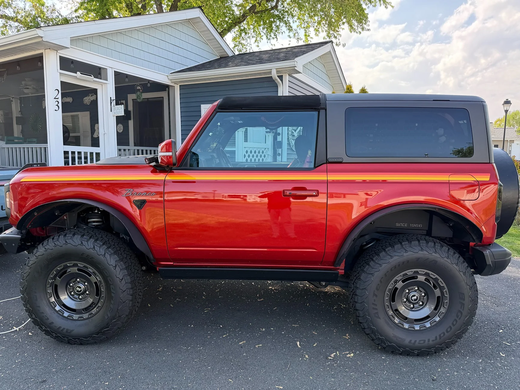

Gratuitous picture of my old one.

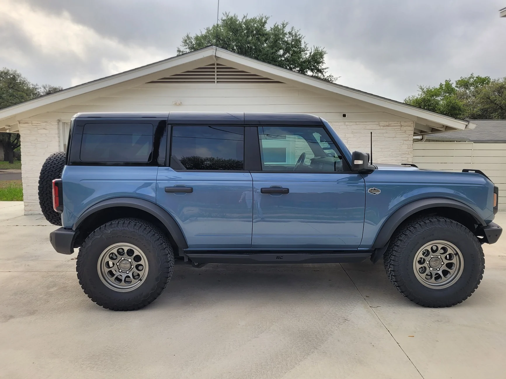

I have 37 K02 on the everglades wheels and combined they weigh 10 lbs more than the stock 25". My MPG has been better which shocked me. Now that I am older my lead foot is lighter :)
