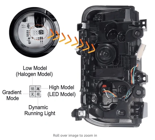

I think I have the same taillight as you do.
There are two little toggle switches behind the rubber cover.
Ford Bronco Problem with mabett taillights 1703785496281
Halogen/LED and Startup animation/ no animation.
Make your other one matches.

What do you mean by smokes internally? Like smoke coming out of the taillight?
Make sure you got the halogen/LED switch set correctly. If you had LED, use LED, vice versa.
Could be bad connection or wrong connection? Though the plug only goes in one way so... I'm not sure. I guess just make sure they are snug.
It could be simply just a bad unit too.

Yes it's switched the same as driver and yes it is odd only when I press brake it smokes internally
