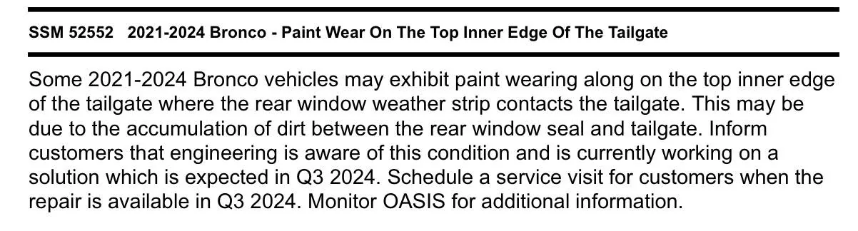

Is there an updated repair from ford on this?
That SSM is still the most current information.
Ford isn’t very reliable at all on their timelines to release a repair. Knowing them this repair won’t be out until Q3 of 2026
