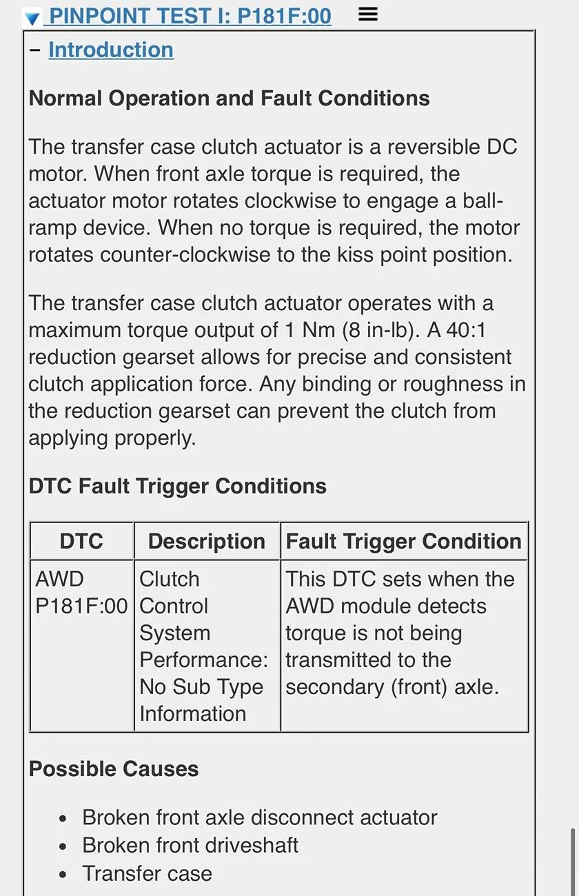

P181F isn’t referring to the transmission clutch. It’s just a generic DTC description mainly meant for the Advanced TC.
@Brian_B
You may need to remove the TC shift motor and make sure everything in the transfer case can move without binding. If everything moves like it should, It may be an issue with the shift motor itself. This is what typically sets this DTC.
Ford Bronco Powertrain Malfunction / Service 4x4 IMG_5634
@Brian_B
That’s a good idea - I kinda figured it was the Advanced T-case clutch and not the 7MT one, but your description of torque is pretty spot on of what I saw: 4WD would engage, the light comes on the instrument cluster like normal, but as soon as I’m in a situation where the rear wheels spin and I needed the front wheels: wrench. Just kinda confusing since I don’t have 4A and didn’t think there was a clutch in my Tcase - sometimes codes get reused though

Ignore all the clutch stuff. If the shift motor can’t move it into 4H, this is just the code it sets.
They basically just use this one so they don’t need another specific DTC for the part time TC.
