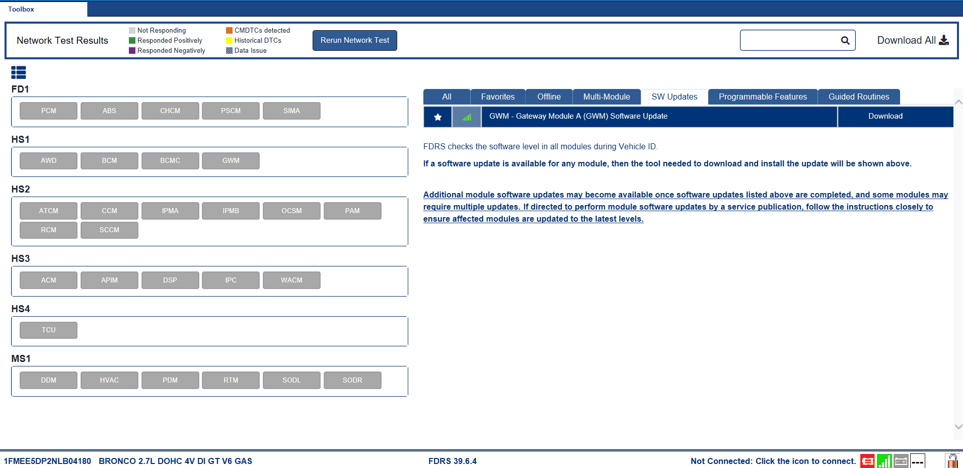

The only one you're showing is the GWM you need. Once you do that, it'll should release the APIM. If it doesn't, message me while your FDRS license is active and we can fix it.
Thanks sir!! Guess it was too much to ask of the Ford gods for an OTA trigger 😂 . Will probably get around to loading up FDRS on Saturday and will reach out if the APIM doesn't appear after!

Alright finished off that Gateway update, which released a Telematics update. Got that one done as well, and now nothing. Next step would be to get with Jesse?

Well, damn.....I feel kinda bad now because I boosted you up into firing up FDRS. Turns out, the new APIM update has only been released by Ford for the 2023 Broncos. I know Ford does weird stuff like this, but since I don't follow these vehicles as closely as I do the F150's, Lightnings and Mach E's, I didn't know this.
Remind me every now and then to check for you. Once they release it, I will get you the update so you don't have to spend another $50.
