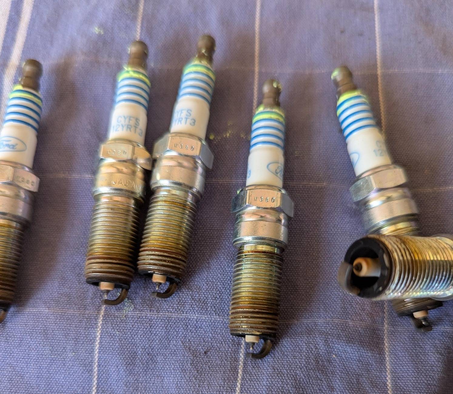

Does this look normal, after one year of ownership and ~15k miles? Mods include Procal tune, Mishimoto intercooler + larger charge pipes, ported throttle body/intake manifold. I've been using 93 gas since day 1, almost always the same Shell station unless on a road trip or out of town. Truck was running fine, just wanted to try out one step colder plugs because I have too much time on my hands.

Interesting although they seem to look normal to me. Plugs do look like a nightmare to get to. Did a lot of stuff have to come off to access them? I was not planning on plugs for very many miles.

looking at them I would not go to a colder plug....maybe a step hotter but I wouldn't go colder.
You think they look fouled?
Guess I can always pull these new ones after a few months to take a look unless I start having clear/obvious misfires or bad cold starts.

I like to run my plugs around a light brown. your porcelain looks ok but outside of it looks too black. Send the wideband readings from a pull to your tuner and see what they think. Why do you think you need colder plugs?
Those are perfect.
1) You want a dry plug.
2) You want some discoloration around the insulator.
3) You don't want a completely worn electrode.
4) You want an evenly worn electrode.
5) You don't want any grit buildup around the insulator, ground, or electrode.
6) You absolutely don't want any oily, gunky residue.
If those conditions are met, the color of the threads, insulator, electrode or ground makes no difference. In other words, dark is not bad.

Personally, I would not risk running a hotter plug in a turbo-charged engine, especially if I'm not always using premium fuel. The chance of detonation is much greater, with no reward to be gained when the correct plugs are already operating perfectly. If I were OP, I'd put those plugs back in and not think twice about them for quite a while.
