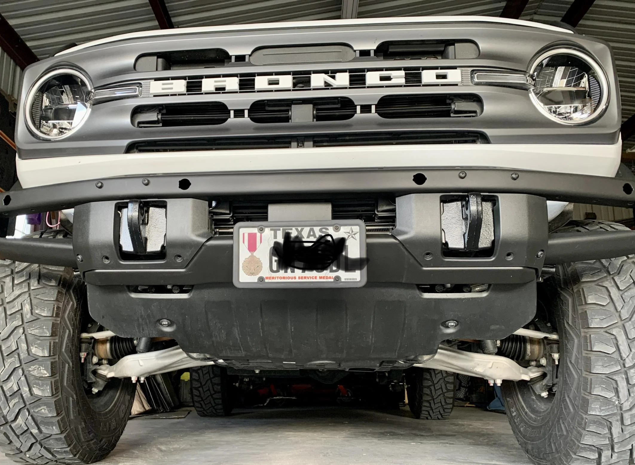

Easiest/cheapest way would be to cut off the tow hooks from the brackets. The plastic bumper should fit with a little bit of trimming (see other member's photo below). Alternatively, you can order the brackets from the factory without the tow hooks integrated with these part numbers:

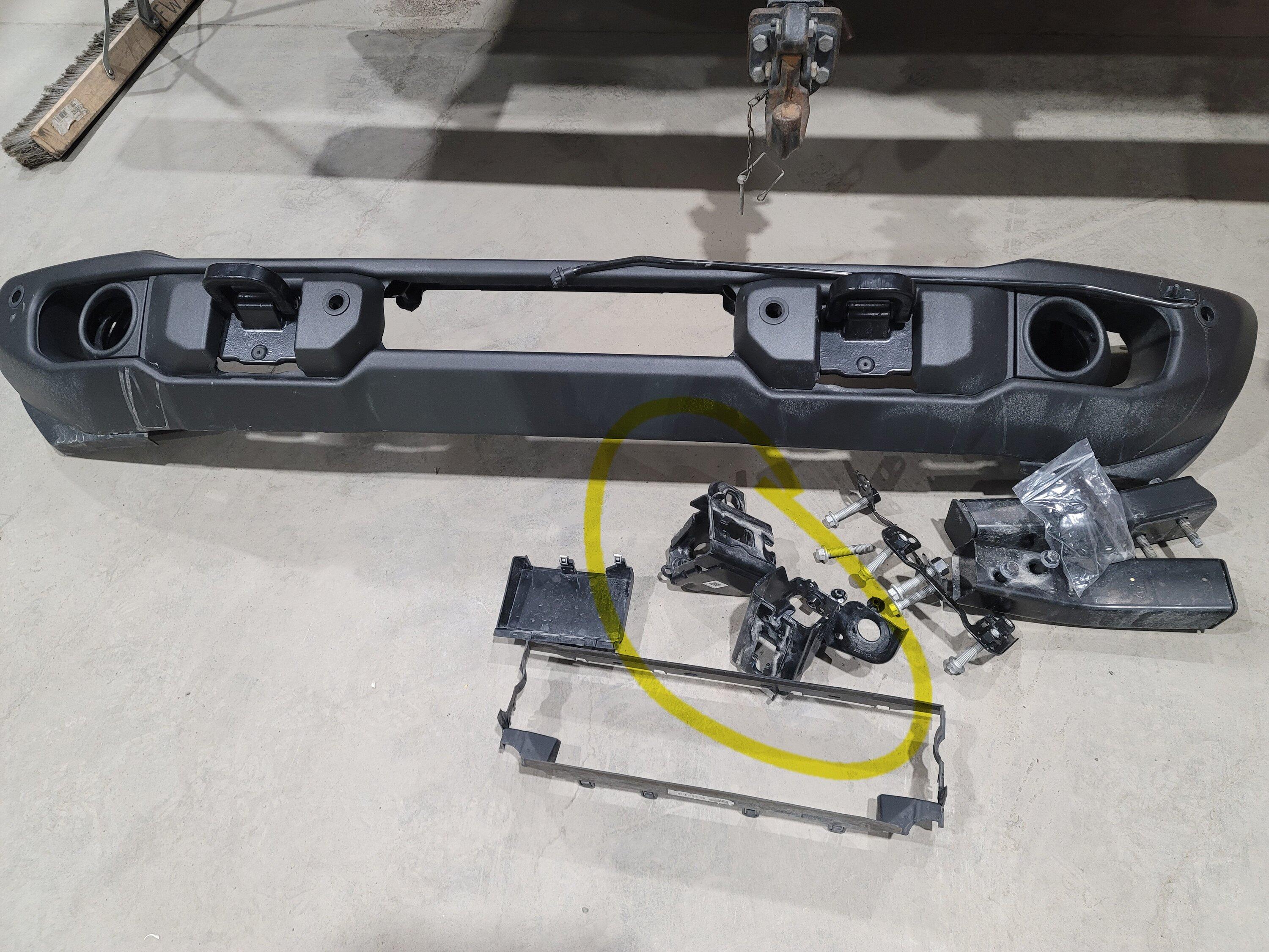

I ended up with the intercooler brackets in my OEM parts pile after my bumper install. The Brave Offroad Bumper/Skidplate package has integrated intercooler mounts on the new skidplate itself.
So a Badlands VIN will have the PN for them. They look like this, circled.

There is a plastic square bracket around the intercooler that has to come out too. You can see it in @Chrome_Pony picture there - the bottom squareish piece.
