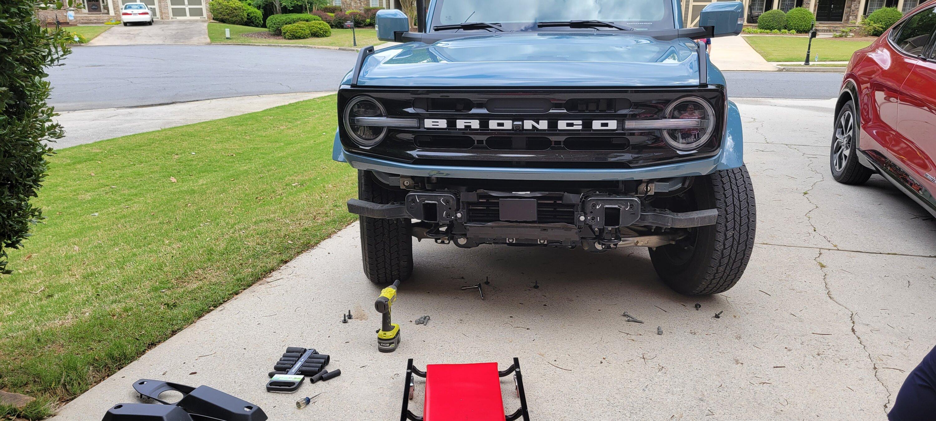

I scored a Modular bumper and front skid to wap to my OBX. Thanks to all the great resources here and videos took about an hour including cutting the old tow hooks off.
Still awaiting some final bolts etc. But very happy with the look so far! Those darn bronco bolts are about $5.50 each! Geese, spent $85 for 14 bolts and 8 plastic push pins!

did you use the same inner mounting bracket from the plastic bumper to install the modular bumper? I cant seem to make the modular bumper i purchased mount. Here is how i bought my mod bumper

I presume you have all the plating on the inside of the bumper , the tow hooks and the bolts etc?
I used a saw and cut off the original toe hooks that interfered (also hit them with some spray paint. Or you can but the original intercooler mounts from Ford that support the modular bumper.
