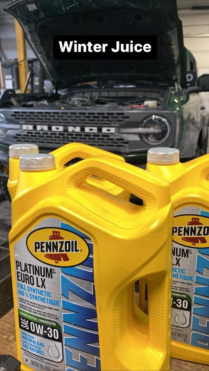

Just loaded up some Pennzoil Platinum Euro LX 0w-30 up with an OEM filter. We’ve had our first few nights of -35°c, swapping it out from Pennz. Plat. 5w30 ~10,000kmsOCI

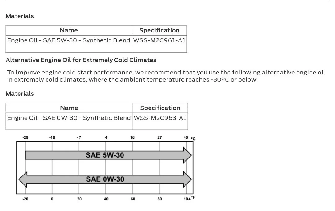

I would note most 0w30 oils are euro spec. If you’re trying to keep your warranty intact you will have to search for a 0w30 that meets the ford spec (Basically API SP). Mobil 1 AFE is the only one that comes to mind.

I'm not Bob so I'm not an expert. But one thing to keep in mind is that a 0-30 a 5-30 are usually not as identical as you think. Now I haven't looked up and compared every single brand, But remember each of these oils ranges within those weights. So at your engines operating temperature, those oils could have different viscosities.
Unfortunately in the specs of most oils, the only one listed is the viscosity at a 100° c (212° f). If you look at those two numbers on your two versions, are they the same? To our engines run at 100° c?
Another thing you need to make sure of, it's just the slight difference in oil can put it outside of the engine specs per Ford.
For example Pennzoil premium meets the specs, but Pennzoil ultra does not and will not.

The above mentioned oil from Walmart is exactly what I have in mind and it meets WSS-M2C963-A1. Not bad for $5/qt; one would think.​
