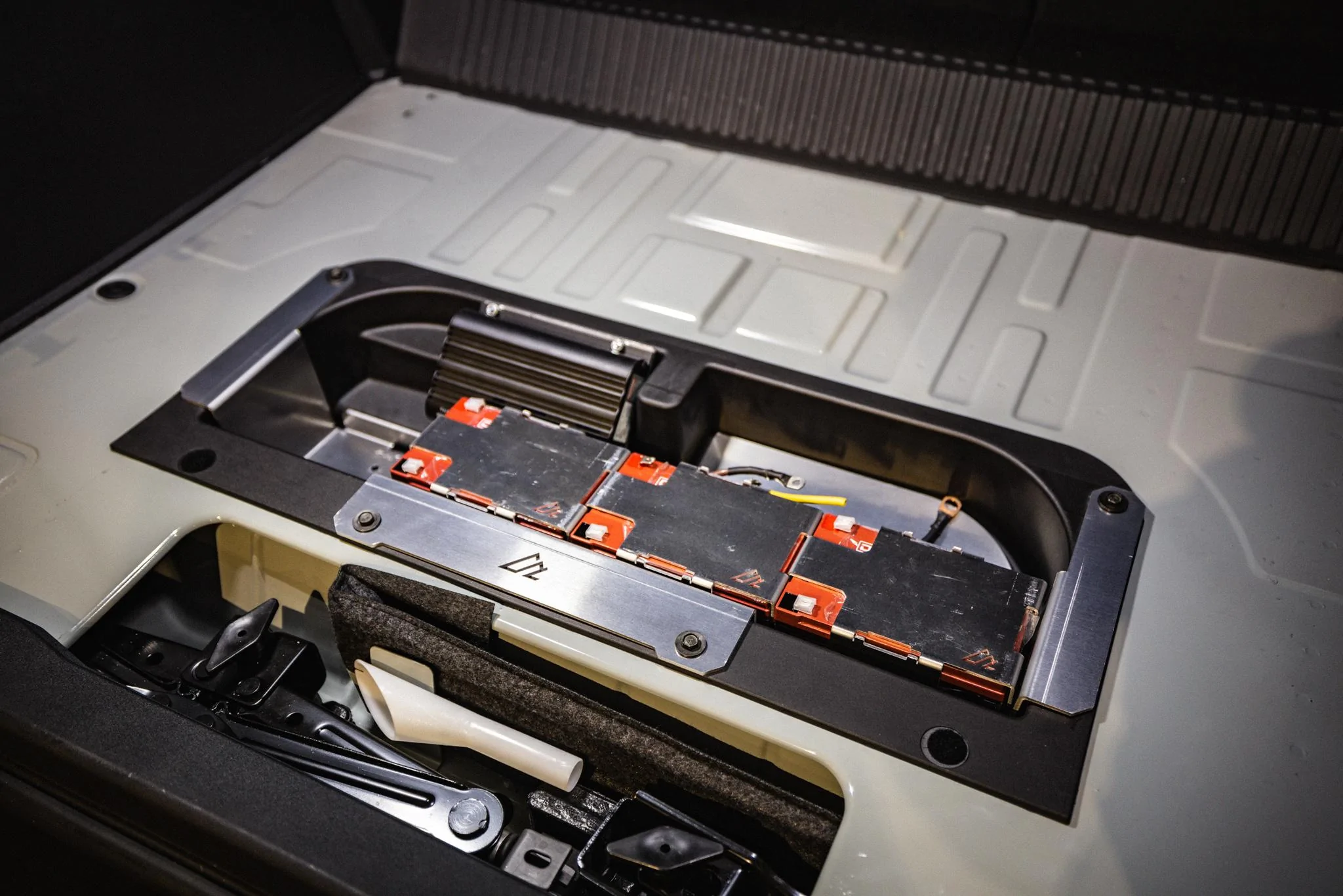

Anybody got thoughts on a lithium battery? They seem to be pretty nice for the "modern lifestyle" (especially glamping and influencer overlanding) but are very expensive.
In general charging Lithium batteries when the temps are below freezing will damage them, so they are not recommended for use as the primary vehicle battery. That being said, I have four Dakota lithium batteries in the rear of my Bronco being used as an auxillary power source for my fridge.
