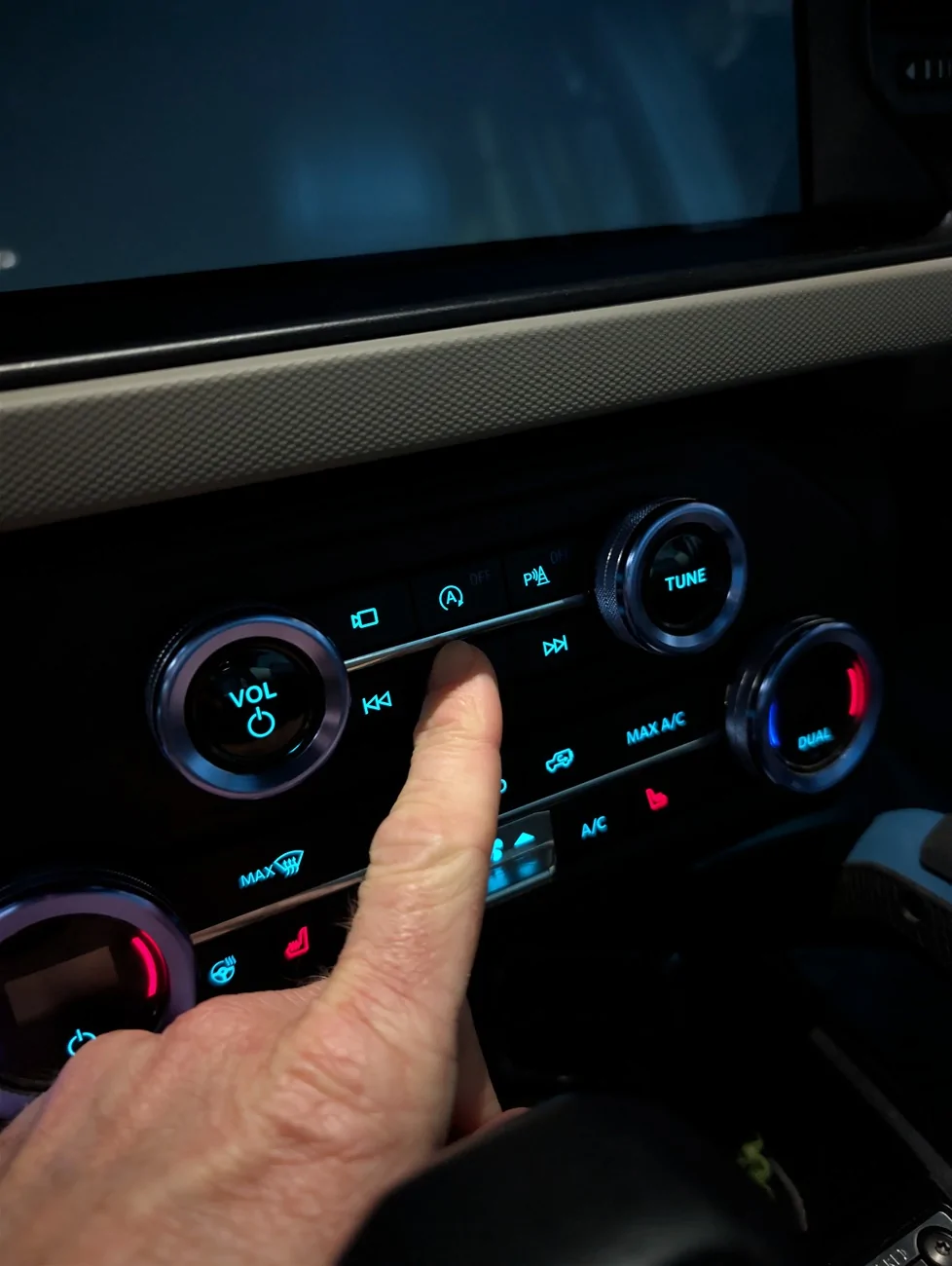

You can also purchase an auto start/stop eliminator so it will stay off all the time. There are quite a few options out there on Amazon. I can’t remember which I bought but it works great. It plugs in behind the radio panel using the wire that comes out of the start/stop button Wildtrak Whitey is pointing to. Super easy
The IAG start/stop works perfectly on my ‘23.

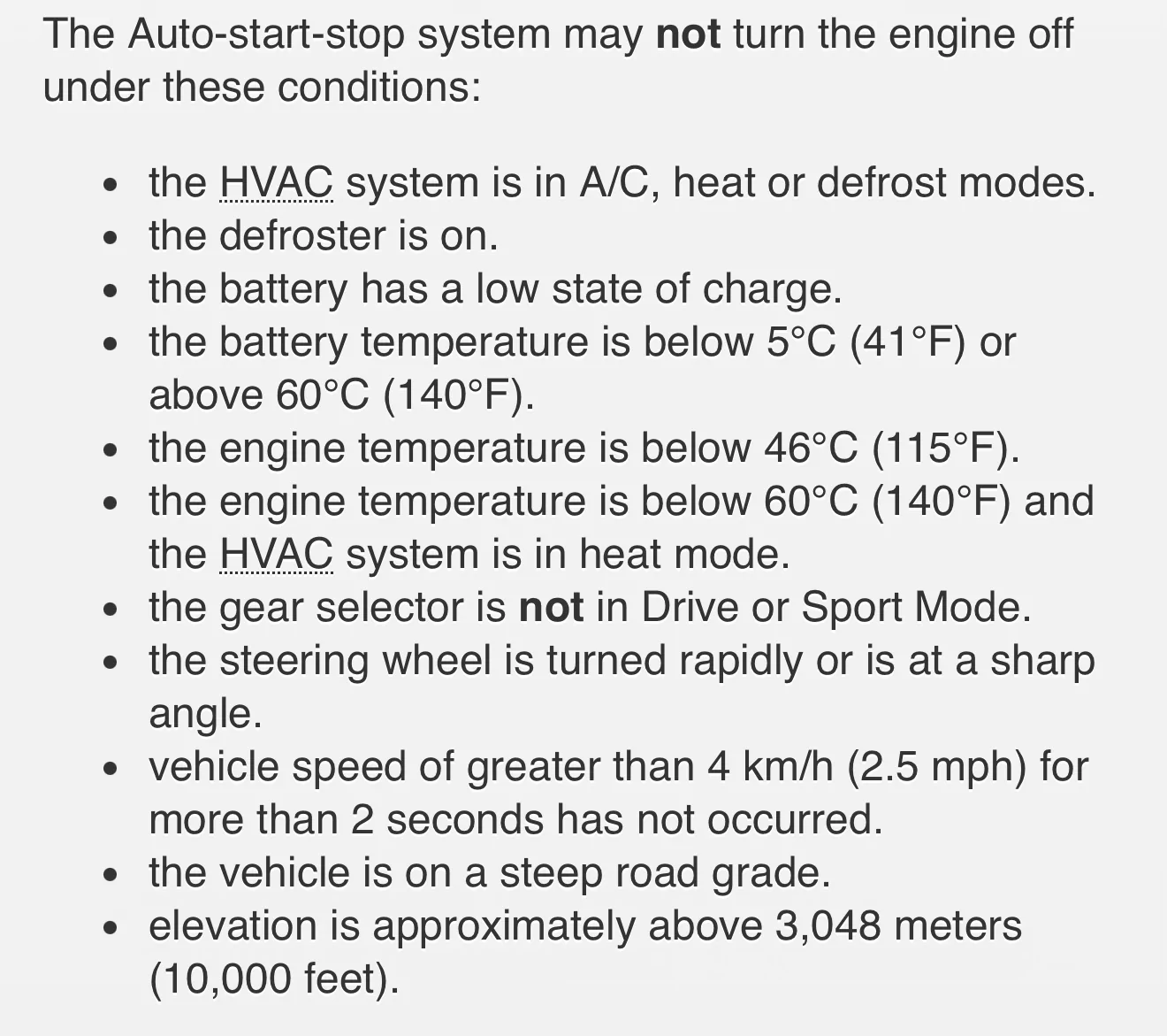

There’s quite a few things that may prevent it from working
feels weird to label a post with a bookmark called ASS PARAMETERS, but here we are... 😅
Thanks for the info, as always.

Seriously, I never had my auto-stop button killed with Fortran, but for some reason it remains off most of the time, which suits me fine.
I remember going WEEKS sometimes between ASS events.
Now that I see the list, I realize "defrost" is my default choice for the HVAC, which apparently eliminates ASS events.
Also, with my manual trans, the ASS is MUCH less intrusive than with the automatic trans Badlands I had.
With the manual, it never bothers me when it does shut down, I've come to expect it at train crossings and really long traffic lights, which are about the only time it happens.
The automatic , on the other hand, I hated the ASS in that thing with a passion.
It happened way to often and at the worst possible moments.
Like trying to cross a busy street, it'd die the moment you went to smash the go pedal.
Absolutely maddening.
