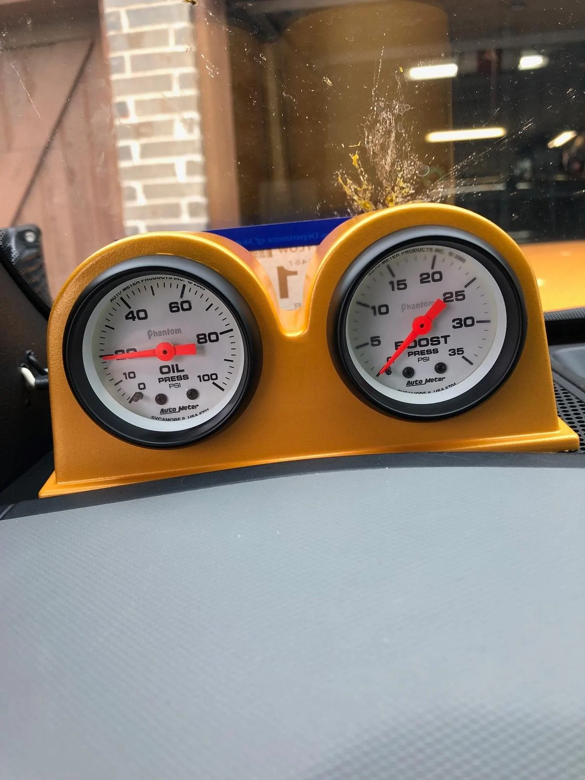

Here's a picture of my oil & boost pressure gauge installation.

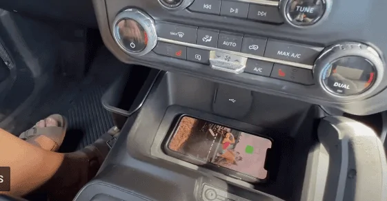

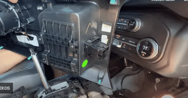

Has anyone added gauges to the center console ? Seems like it would be a tight fit buy maybe possible?? On either side of the charge port

Im interested in adding gauges to the center console - maybe oil temp and pressure
Looks like there could be enough room... theres 2"++ on either side both vertical and horizontal

Looks like a couple of 2" dia. gauges would fit down there and make a clean install. The location, for me, however, is to low and out of line of sight. I don't want to take my eyes of of the trail/road for more than a second or less to get a reading.

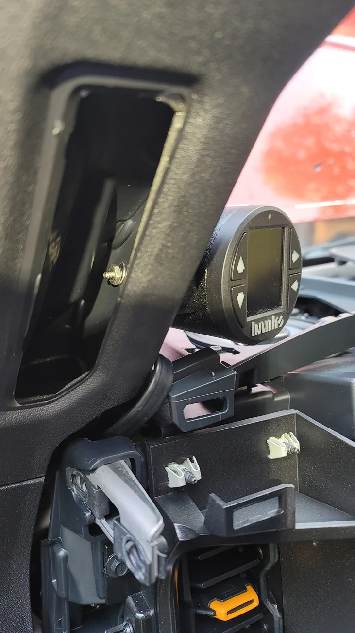

Planning on sticking my Banks iDash on a superlow mount that uses the grab handle screws just ahead and slightly left of where your mount is. Wiring is going to be ... interesting, but I hope not to have to drill too much, probably just the speaker grille.
The alerts, when programmed, flash the whole gauge face and buttons, so the gauge-look fatigue is not a factor.

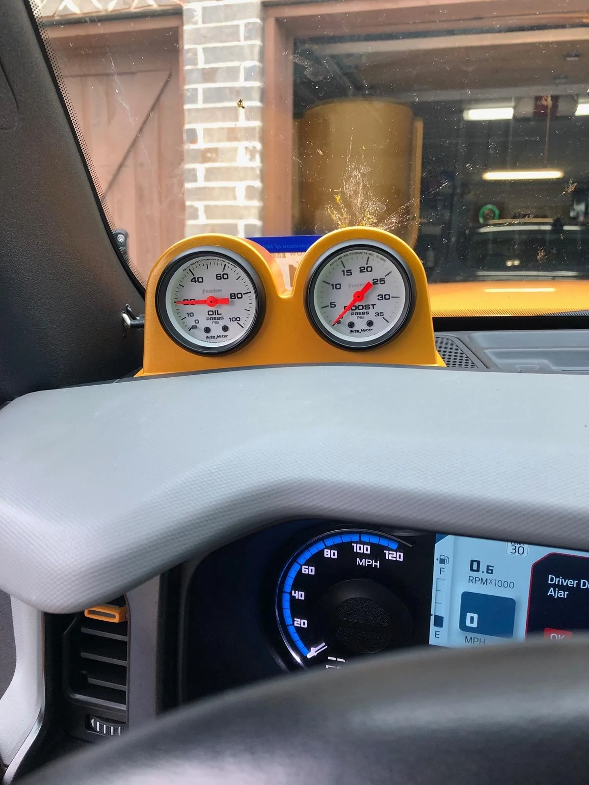

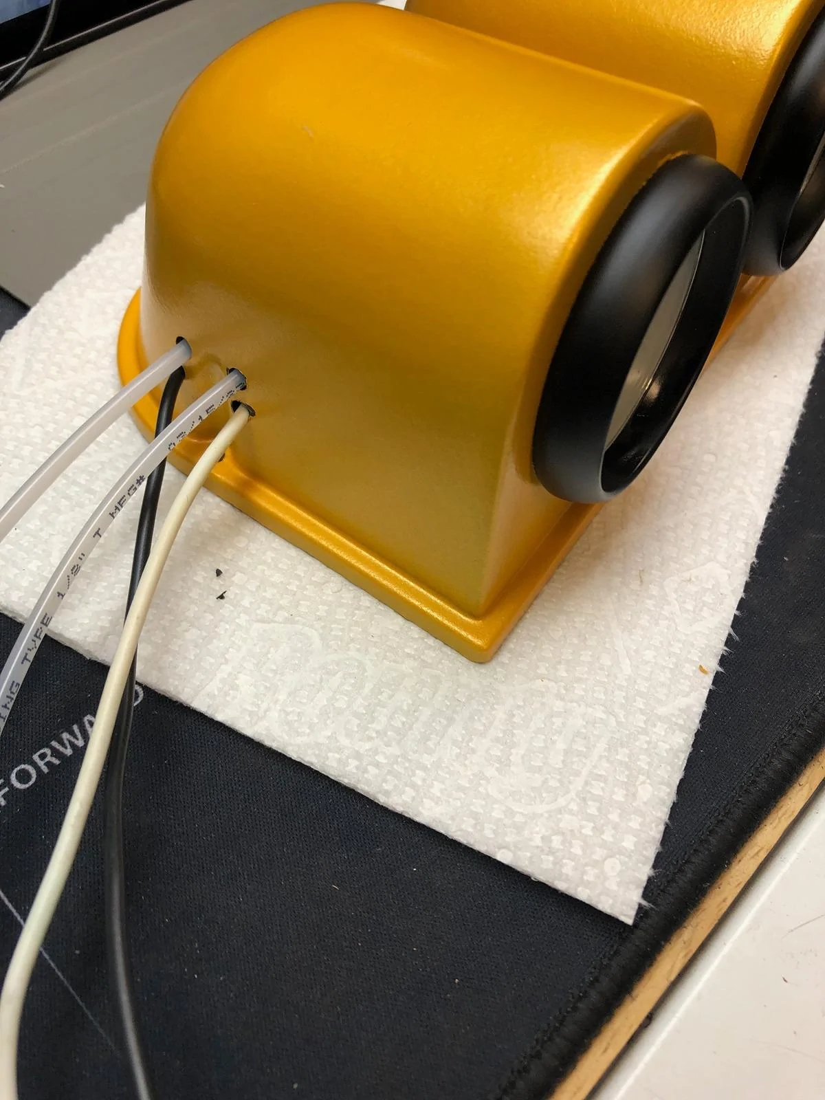

New and improved gauge installation. Now in Cyber Orange. Due to popular demand I am posting new pictures of my gauge installation.
Ford Bronco Oil Pressure Gauge Install IMG_0892
Ford Bronco Oil Pressure Gauge Install IMG_0891
Ford Bronco Oil Pressure Gauge Install IMG_0889

How hard was getting into the A pillar cover that you drilled into? Going to start putting together the dash/cluster/wheel upgrades, one of which is the iDash and pod.
Not hard at all. The parts just pop loose. Start in the door jam and work your way up.
You can't drill any lower than where I drilled. The HVAC duct is in the way.
The tubes and wiring were easy to fish down to the under dash area.

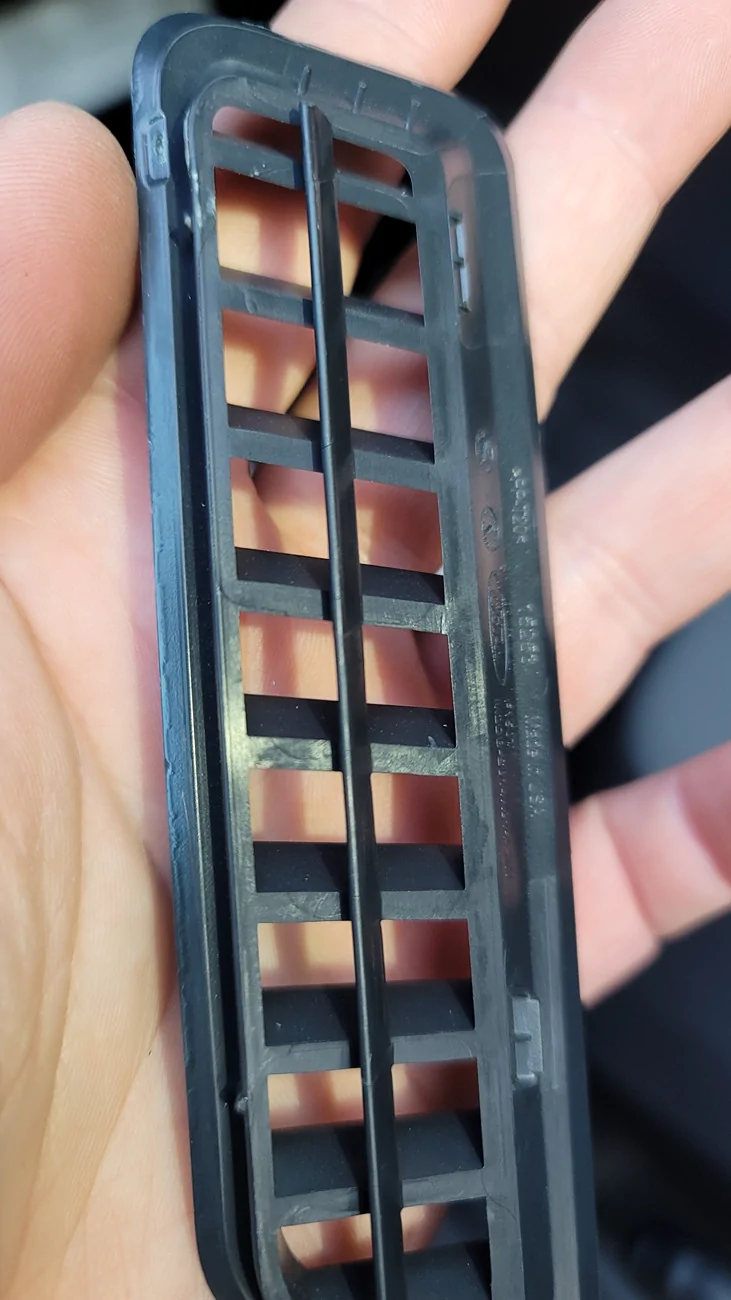

To answer my own question, the A-pillar vent grille is a SOB to get out and you'll probably break at least two tabs. If they are the top ones, though, it will still fit flush, by sliding the bottom in and gently bending the remaining retention tabs.
View inside:
Ford Bronco Oil Pressure Gauge Install 20250905_183745[1]
Top two tabs broken when removing grill.
Ford Bronco Oil Pressure Gauge Install 20250905_194434[1]
