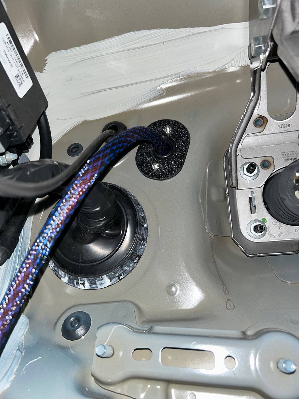

"Run a new ground" meaning running an equal gauge wire from the trunk-mounted device back directly to the main battery?
Area51BS
Ron
Sep 20, 2022
242
3,228
5,270
Badlands non SAS 4dr 2.3
Yes. Just like OP to the vehicle side of battery monitor, not the battery terminal bolt. Would be wise to put the positive wire in additional flex loom. As seen here in mine with water proof grommet and bushing I made.

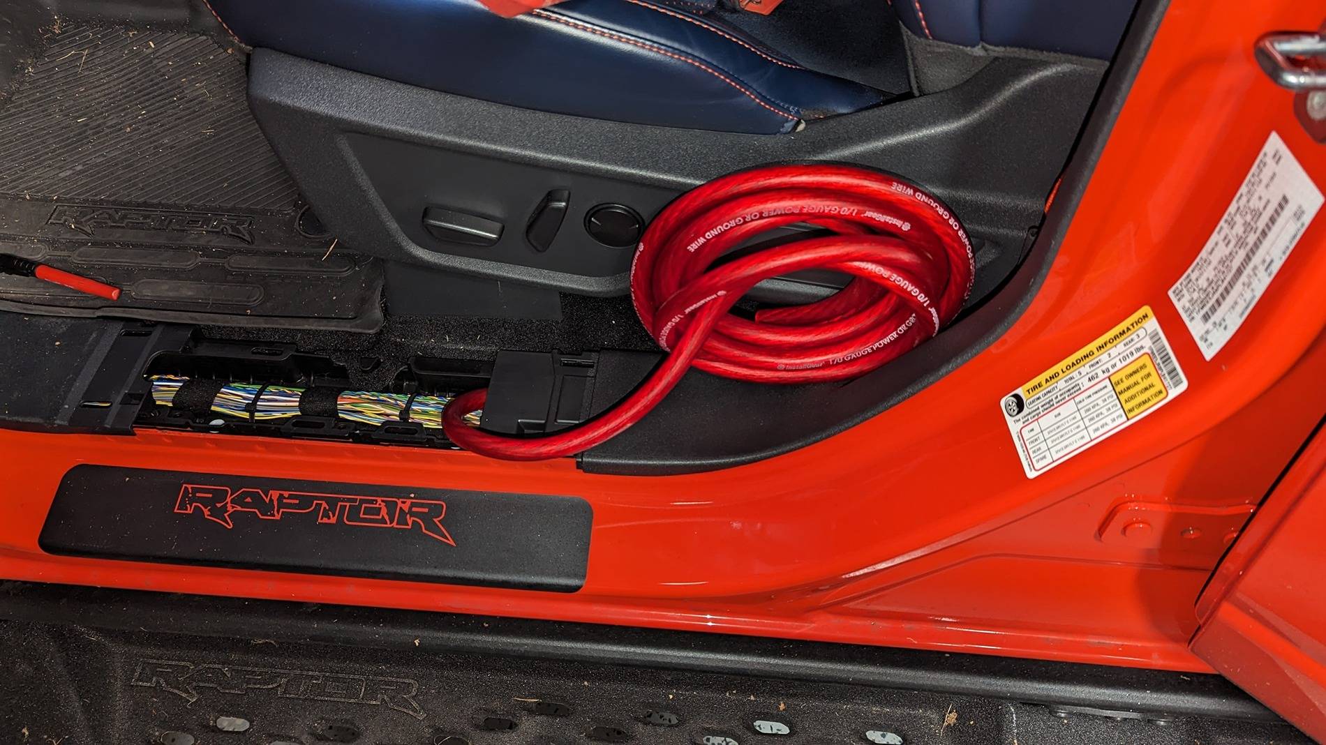

Man that wire looks beefy and it's only 6 gauge? I can't imagine how big the 0/1 guage is that you are supposed to use for winches.
I'd say it's about this thick - lol
